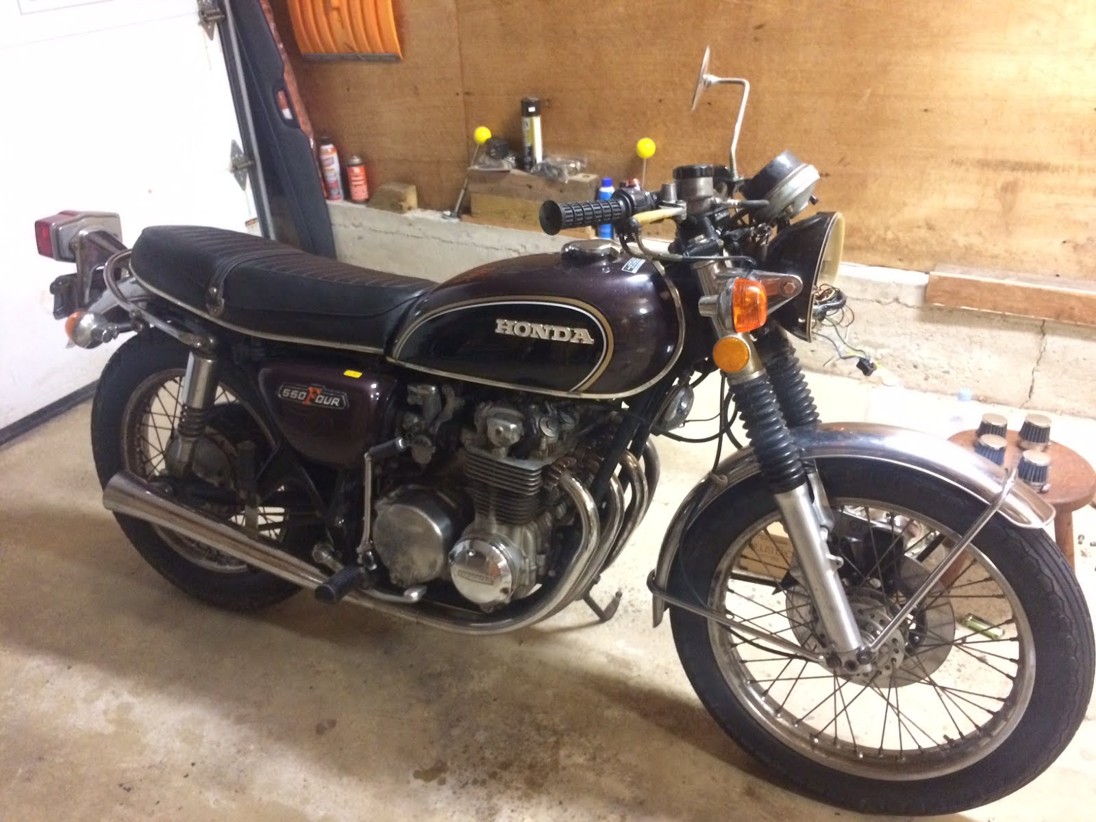

I took her out again today.  Just to ride it around to test the choke in 5th gear.  It made a huge difference, so I'm running lean like I expected.   Also the bike runs pretty good even not choked, disregard my last post, the bike has exactly as much power as it should with the incorrect jets, I am just not very good at shifting motorcycles anymore, having been way from them for 15 years.
The blinkers work now on both sides, but in a funny way.  The right side will blink slowly and get faster if I rev the engine.  The left side seems to work pretty good but also I notice it get a little faster when I revs it.  Voltage issue?  Probably just a corroded connection somewhere.  I still have not gotten the headlight to work.  I might pay someone to go over the wiring 'cause it's really stumping me.
The rear tire seemed like it was not aligned well, but the indicators on the dropouts said it was straight.  I slid the right side forward one notch which made the wheel seem straight to me.  This was all by eye mind you.  Is there a home mechanic method for testing the alignment of these frames?
On bicycles you tie two shoestrings together then tie one to the right rear drop, wrap it around the head tube, then tie the other end to the left drop and make sure the string is tight.  Then you measure the distance between the string and the seat tube on both sides.  You usually don't have to remove anything from the bike.  If both sides measure the same your frame is not bent, but that method does not show if your frame is TWISTED or not.  A twisted frame as opposed to a bent (bowed) frame is when the head tube, seat tubes, and rear wheel are not on the same vertical axis.  It happens from side ways collisions or more commonly from bicycles being stored stacked next to each other in big piles.  The bikes twist each other under the collective weight of the pile.
Now I'm scared this moto frame is bent.  The bike seemed like it rode pretty straight and true; I took it up to 65mph on some straights.  I can't really feel out the tracking too precisely because I still have the toasted stock headset bearings in the frame, I haven't put in the All Balls kit yet.

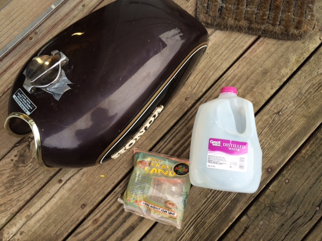

^ Too late, already wet sanded the inside of the gas tank.  They way you do it is with equal parts play sand and distilled water inside the tank, duct tape the holes closed and shake the crap out of it for about 20 minutes.  My tank was very rusty so I did about 40 min.  It is a LOT of work.  It is a great upper body workout too, another reason I did it.  It is also very cheap; all you need is a gallon of distilled water and a small bag of hermit crab sand.  It is also the fastest way to de-rust a tank that I found, all other methods are passive and take a day or two.  The key is making absolutely sure you rinse out every last grain of sand, it takes almost as long as the shaking part, and then getting it perfectly dry so more rust doesn't form.  I do not know where my dad's charger is so I could no do electrolysis.
It got 95% of the rust out, not 100% but most.  I am going to get the rest with electrolysis some day before I seal it.  But for now it's a lot better than it was.  Between the wet sanding and the viso filters my carbs should stay clean now.

You should spay the inside with WD40 or some other rust preventative or you will get additional flash rust quickly.

^ I immediately filled it with gas to the top as soon as I got it bone dry.

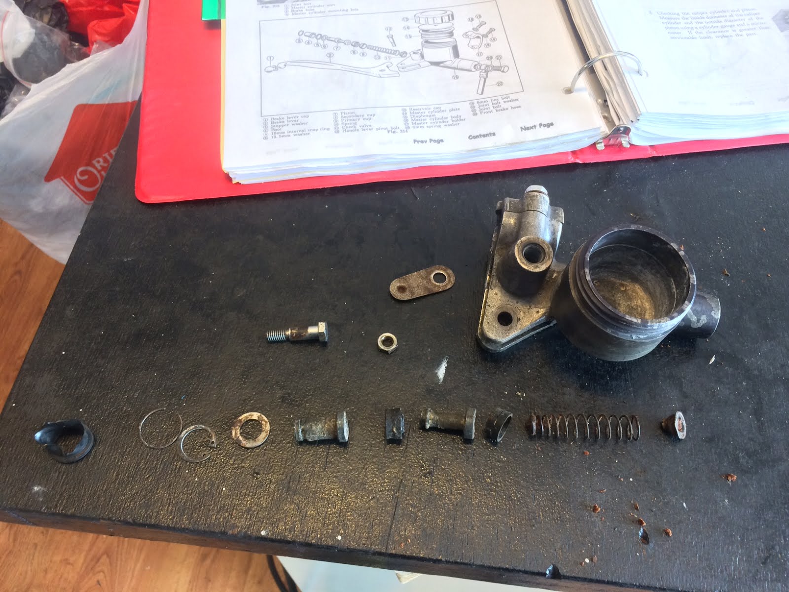

I got the MC apart.  Once I hammered down the piston a little I could get my c-clip pliers in there.  Yanked out half a  piston(?), sprayed in some PB blaster, then pushed everything out with a long allen wrench from the other end.
Turns out my piston had snapped.  That may have been my doing from muscling it too much trying o yank it out.  Doesn't matter because the rebuild kit comes with everything. Got my rebuild kit on eBay, it was cheaper than 4 into 1, even with my super secret discount code.  http://www.ebay.com/itm/162148465095?_trksid=p2057872.m2749.l2649&ssPageName=STRK%3AMEBIDX%3AIT
