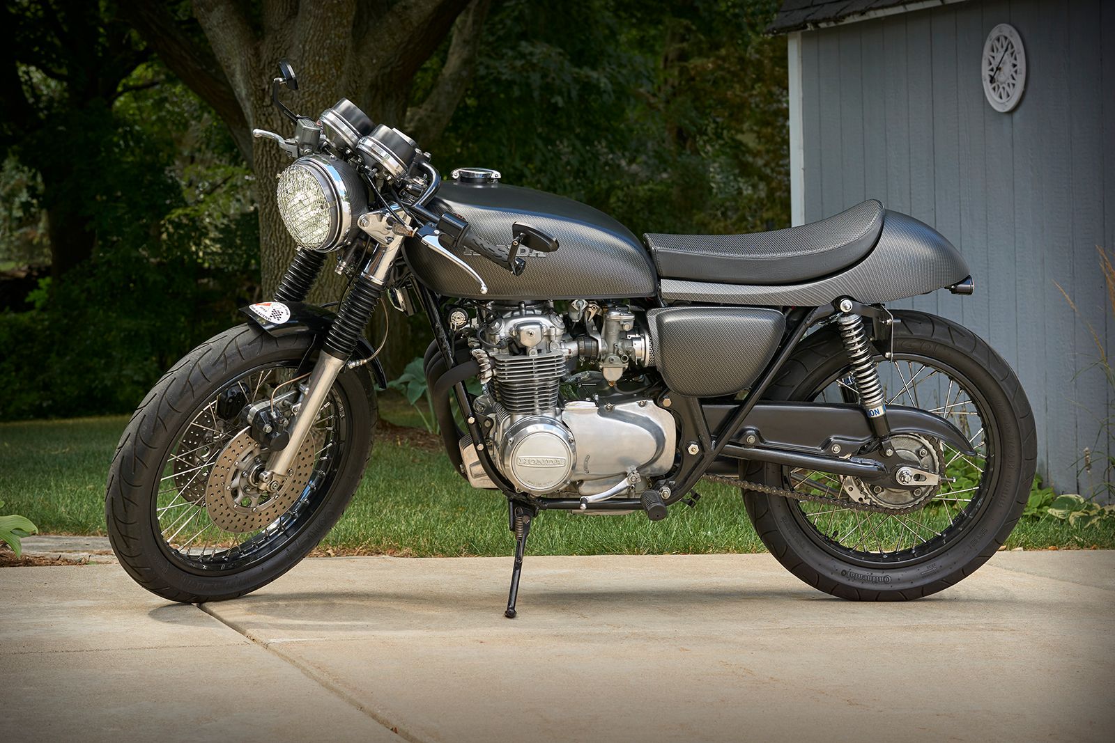

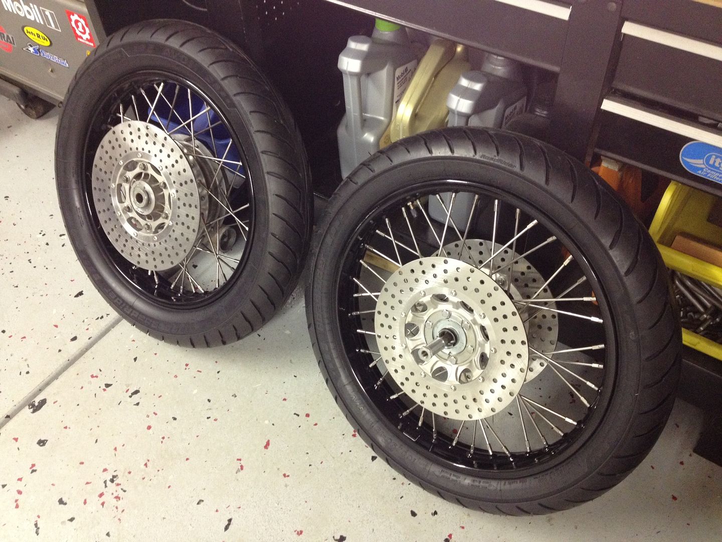

Offline sixthwisconsin
  • Posts: 553
I have Jeffs rotors on both my 550 & 750f.
Highly recommended.

Offline grcamna2
  • Posts: 16,196
Those look good sixthW  8) I'm purchasing from Godfferry also.
These oem machined rotors are looking like a much better choice than some chinese repro.
« Last Edit: November 03, 2016, 08:41:46 PM by grcamna2 »

Offline Godffery
  • Godffery's Garage
  • Posts: 1,184
 Thanks for posting Pix, I always love to see these on the bikes!
I hope to be starting an album of Customer builds on my web site soon, I trust you won't mind me using these Photos...?
  • Posts: 553
Let me get you a couple of beauty shots of the whole bikes complete. If the OP doesn't mind, I'll just post them here for you to grab.
