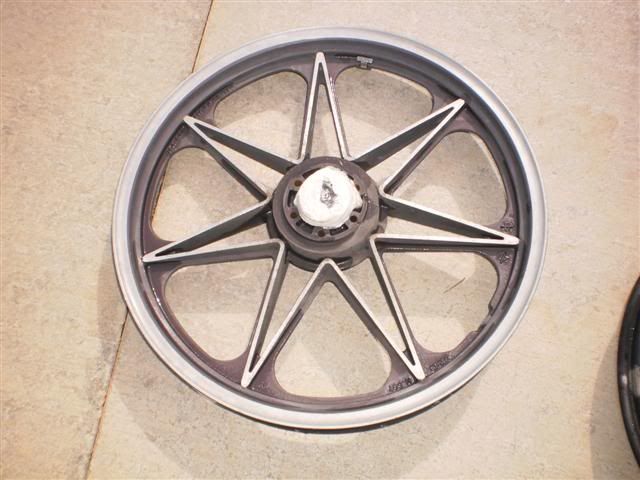

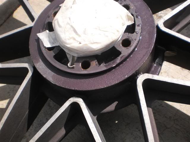

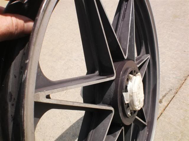

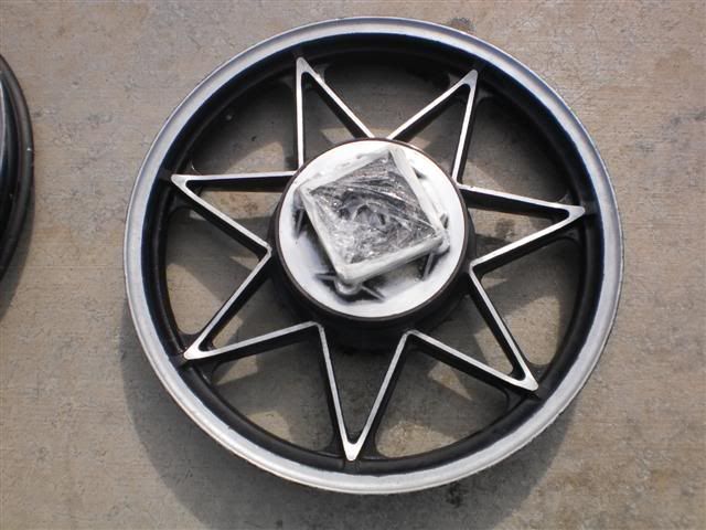

 I tried cleaning up the wheels today with mixed results. They're in pretty nice shape, but the lips and rasied edges are machined, not polished. That makes them VERY difficult to get detailed.
 They look better in the pics than in person. There's some deep seated dirt in the machined parts. I tried wheel cleaner, 0000 steel wool and aluminum polish, a couple different grades of mild sand paper and some preps-all solvent. Nothing seems to do the job. I was hesitant to go more agressive with the sand paper for fear that I'd leave sanding marks.

 The paint, however, is in pretty good shape. When wet, it appears as this neat plum or maroon color.
 My first thought was to keep the original finish, but when they dry out, the color fades and they look a little drab.
 I'm going to talk to my buddy at the body shop tomorrow and see if he has any ideas. I'll probably end up painting the spokes, but I'd really like to clean the lips better if I can.

why not try waxing the paint to get that "wet" look you had.. we did this often with bare steel I beams on staircases to good effect.

 If its plum or purple looking sounds like anodizing,,think what your master cylinder looks like.
 Try cleaning the machined surfaces with a brass brush...

 Singedible and 754, wish I had thought about the brass brush earlier. I left them at my buddy's body shop tonight. He's going to hit them with his soda blaster and give them a fresh coat of black paint. He, too, recognized that was anodizing. It's a cool color.....but only when wet. Otherwise it's dull.
