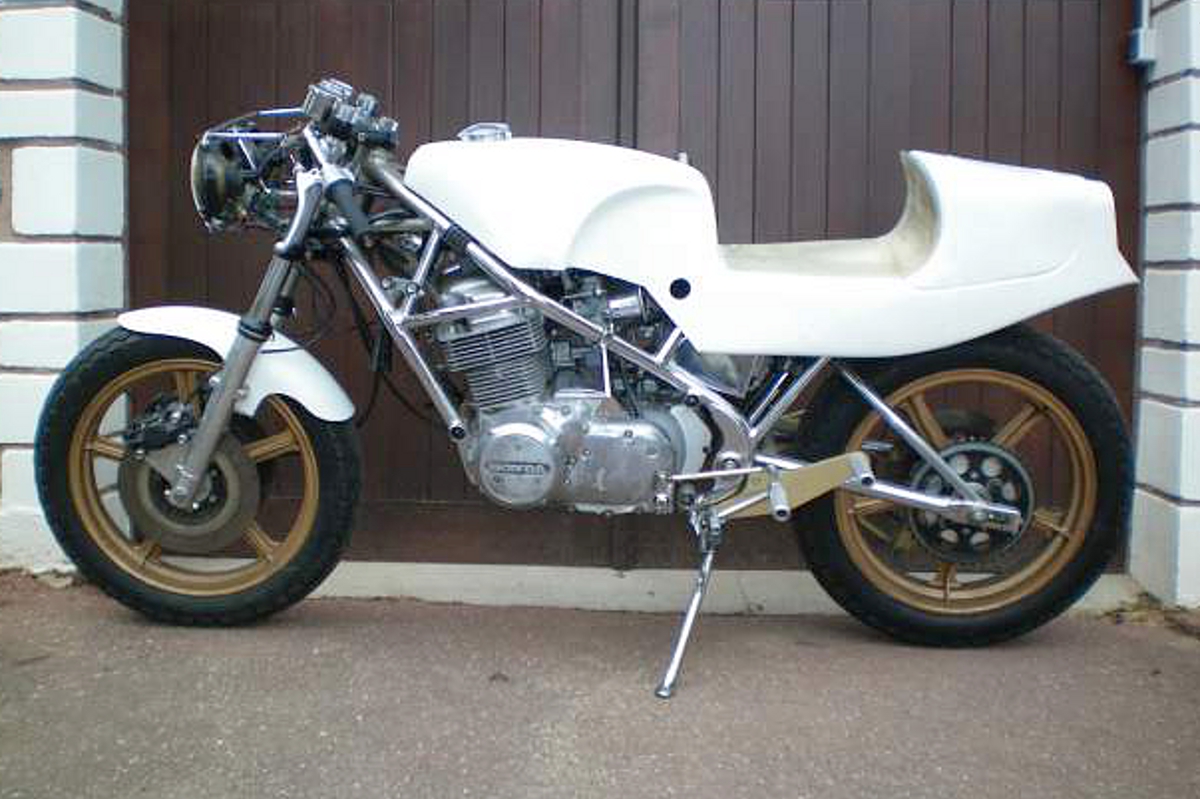

I've been talking with Mirko about the possibility of replicating an aftermarket frame for our beloved bikes, using his contacts it would be possible at a quite attractive price. We think that if we can find at least other 5 people willing to buy a frame, we can keep the cost at 2000 € per frame (swingarm included).
We still have to decide which design to follow, at the moment we are considering 3 main options:
> Egli backbone
> Seeley double cradle
> Moto Martin trellis
Personally I'm very intrigued by the Martin solution, as it has a more modern design and rear monoshock, but I'm afraid that is not allowed in most race regulations (it is allowed in Italy).
Sooooo, who could be interested on this?

 He built the frames in the pics of the white bikes I posted.

 To be fair all the frames in first post are nickel plated..
 So right there, that is 750 and up in any currency.
