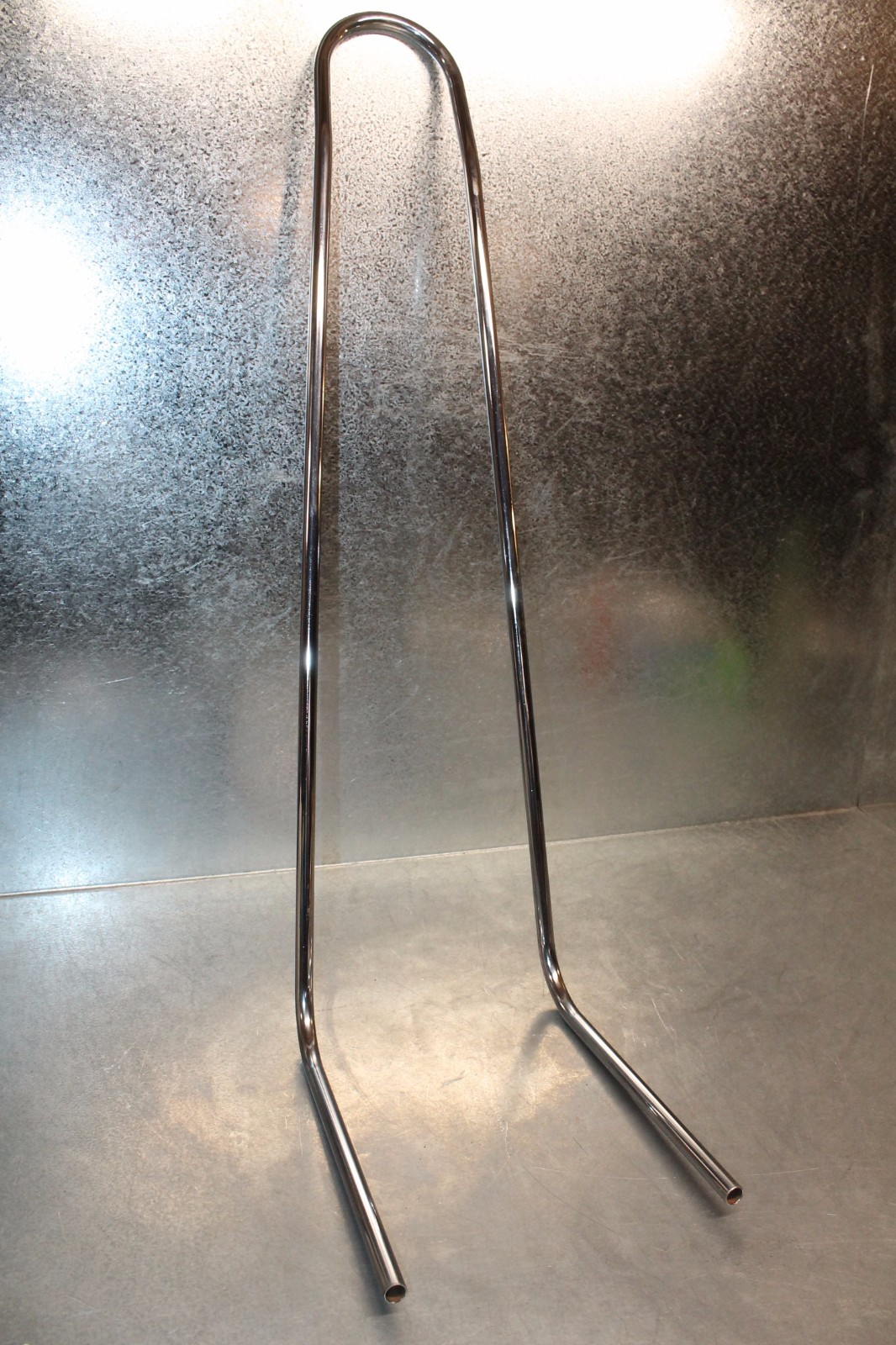

I took off the ugly sissy bar and I've ordered a nice tubular one from some guy on ebay with some NOS chopper parts. I'm going to use a pipe clamp and p-clip to secure it to the frame on each side.
