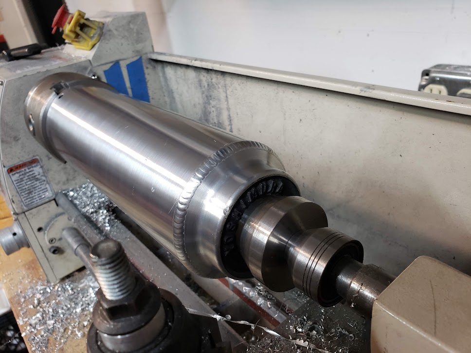

I didnt care for the current offering of oil cooler adapters available today so I made my own. New made ones are designed for a spin on filter and most have NPT fittings, neither of which I wanted for this build. This plate will have -8an fittings running through crimped black nylon lines to a small Setrab oil cooler mounted in the space between the horn and exhaust. With the shutdown, the weld shop isnt open so getting the fittings welded to the housing will need to wait. Everything fits up nicely with an F2 oil filter bolt. I also cut down a stock filter housing to remove the fins and with the sandwich plate, looks nice and clean.
