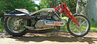

Offline Leino
  • Not much of an
  • Posts: 1,285
  • in drag racing since 2005
Re: Mach III 500
« Reply #7 on: September 17, 2024, 07:55:02 AM »
Whatever that is, it looks dangerous!
JL Meccanica VDR, two H1 engines.
