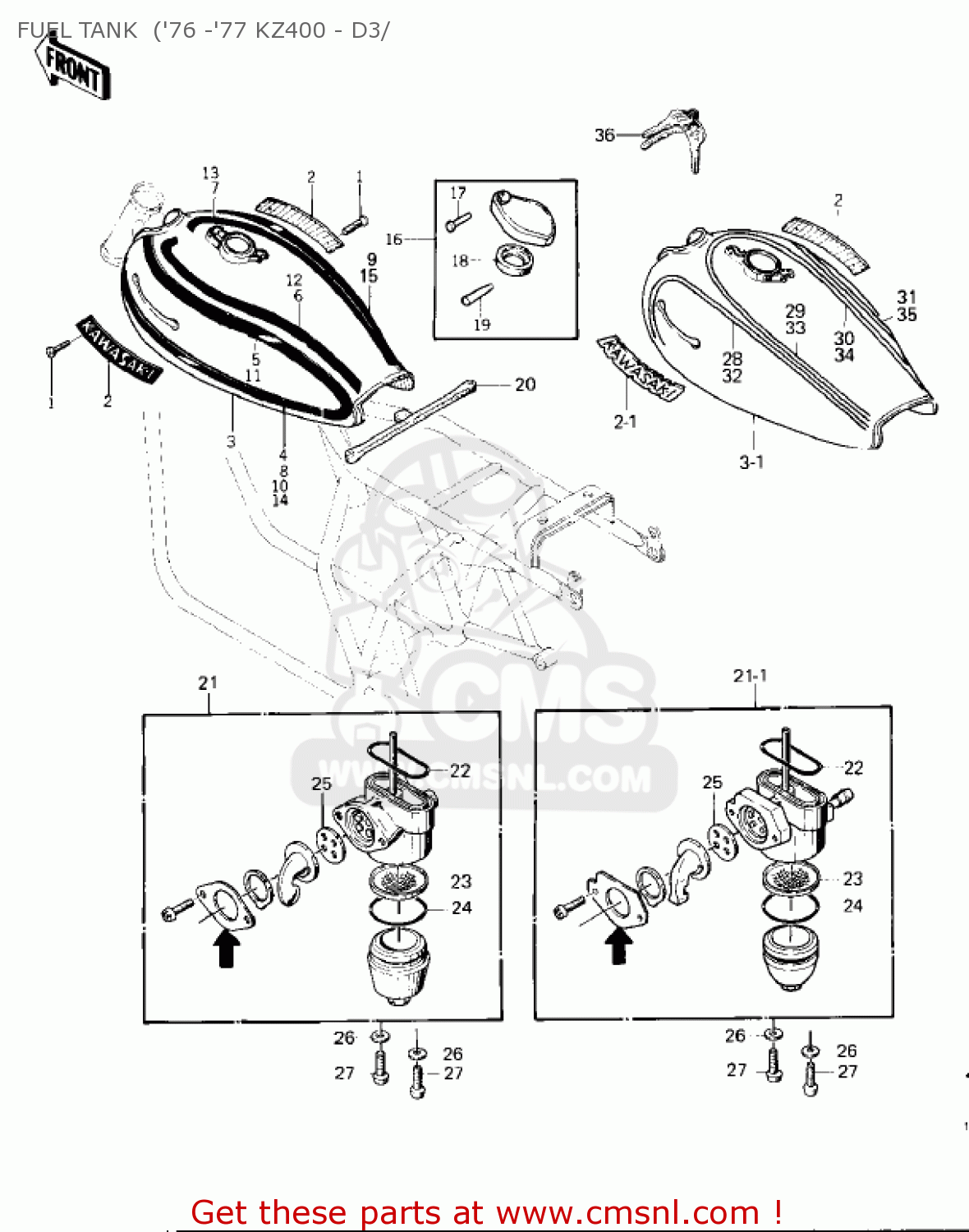

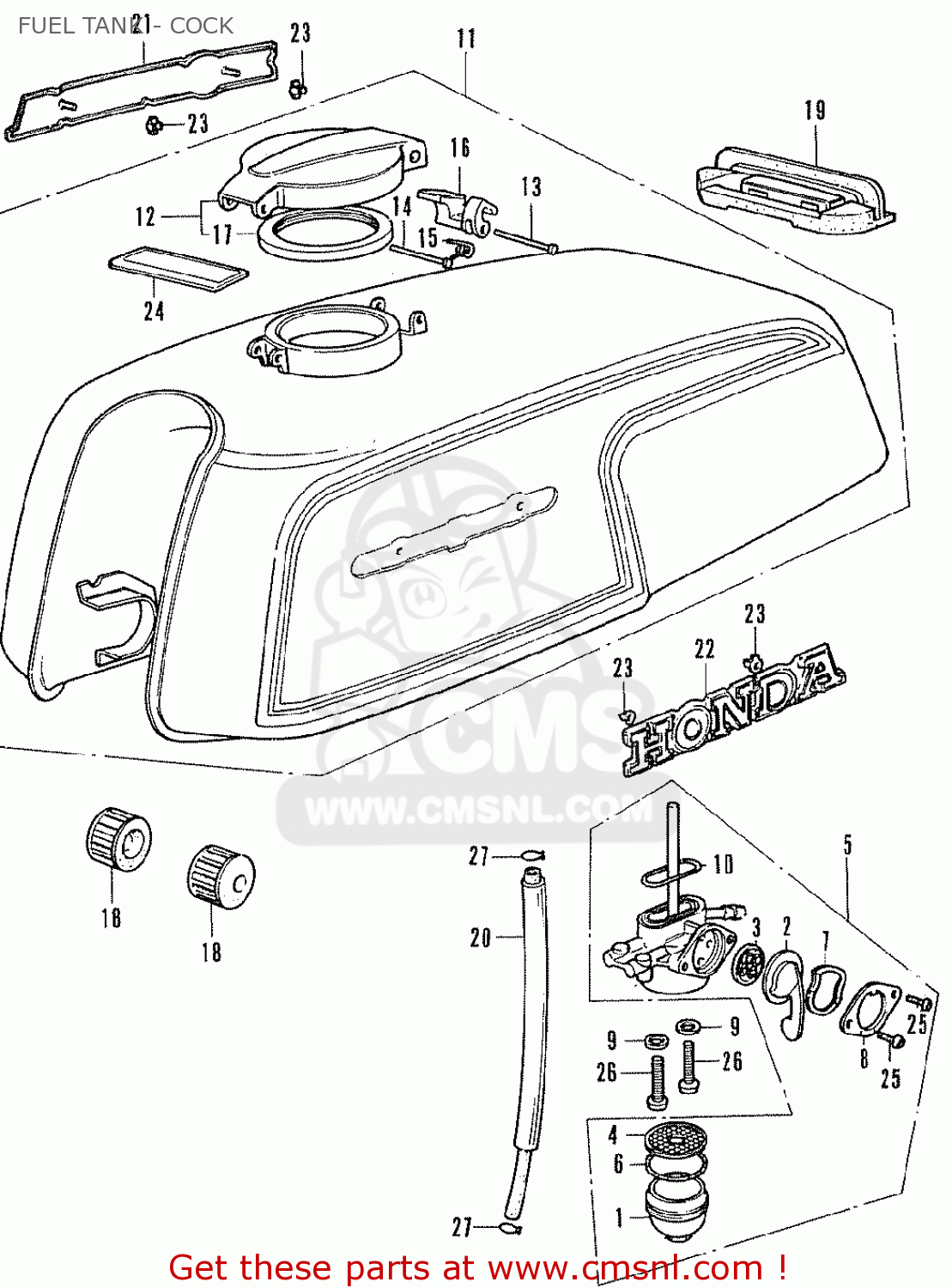

That is nowhere near a stock petcock for a CB350F. The fuel outlet comes out horizontally and at an angle, not vertically as in that one. They might work, but I think it would need some work in order to do so. There are also aftermarket 350F petcocks but they come with two outlets and also don't fit properly. OEM 350F petcocks go for upwards of $150 because they are rare and the only ones that work well on the 350F.

Don't want to get into an unnecessary argument, but for the sake of accuracy they definitely are not "identical."
https://images.cmsnl.com/img/partslists/kawasaki-kz400-1974-usa-canadamph-kph-fuel-tank7677-kz400-d3_bigkar095552464_4012.gif
https://images.cmsnl.com/img/partslists/honda-cb350f-four-general-export-fuel-tank-cock_bigma000079f11_07ef.gif
I've owned both 1974 bikes. They only overlapped one year, 1974, and the later KZ400 petcocks are very different. The earlier one might work (looks like they mount the same), but the fuel outlet comes out from a different spot at a different angle.
CB350F groups are full of people complaining about how non-original petcocks don't work, petcocks made for other bikes don't work, and how hard it is to find an oem one.
