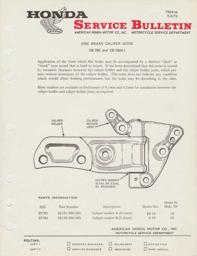

Found this in a stack of Honda Service Bulletins I have.
Kevin

« Reply #37 on: February 10, 2010, 09:45:25 AM »
I saw that bulletin, but I could not get a spacer in there. No enough room.
