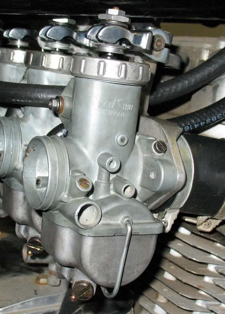

Here's some pics of the carbs....thanks guys - lemme know what you think, don't see any obvious stamping to indicat what they are.  I'm probably not looking hard enough.

Carbs.....!    PO had broken one of the posts that holds the main jet.  Not a bad crack, the jet still threads in and seems to seat pretty well.  But...it still has a visible crack.  Was thinking of using a tiny piece of teflon tape wrapped around the jet before re-installing as a cheap measure...probably on the lookout for some new carbs or just that one.  It's either the number 1 or 4....can't remember - need to go take a look again with fresh eyes.
exact same thing happened on one of mine.  noticed a jet sitting in the bowl.  looked at the hole it usually threads into and found it wasn't there.  also sitting in the bowl.  i ended up JB Welding the threaded part back to the carb body.  let it try for a couple hours and then put the jet back in.  filled up with fuel and went for a ride.  haven't thought about it since, so i guess its holding up well.

I've got a like new carb body looks just like your pic

I wouldn't try Teflon.  Its notorious for shredding.  Once the shreds are lodged in those tiny inner passages, then you'll have some real heartache.
