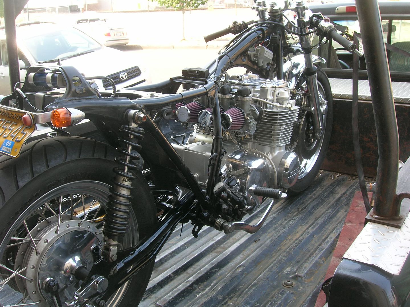

of the 718...  ;D ;D
it's getting close. by the way, no rules in this thread, baby. she's bearing it all...  ;D

Great top end.... 8)
Are those old Suzuki carbs?
Offline fastbroshi
  • Puppet
  • Posts: 2,643
Re: NUDIE PICS...
« Reply #6 on: August 08, 2008, 05:16:12 AM »

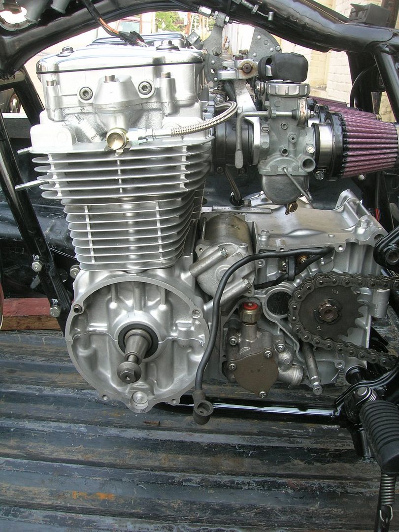

  I think those carbs are off of a 750, very cool.  I was wondering how those would adapt.  I forget where I saw or read it but supposedly this is a good performance add-on for the 550's.  Are those K&N pods?  And if so where'd you get them?  How long are those carbs, end to end?
  More importantly, what's going on w/ that valvetrain?

Re: NUDIE PICS...
« Reply #8 on: August 08, 2008, 06:55:17 AM »
Lookin good Paul, without reading through back pages what have got planned for an exhaust?
I take it the 550 valve cover doesn't bolt-up. I've never heard why, can you enlighten me?

« Reply #15 on: August 08, 2008, 09:59:37 AM »
ahh, thanks everyone. glad you like my wife.
the K&N's came from dynoman.net. i'd have to measure the carbs, but it's the shorter intakes of the 650 head that allow room for the pods to clear the frame if that's what your thinking. the top end is from a '79 cb650, and the SS lines you see are oil lines routed around the leaky stock path.
By the way, don't screw with us again with that NUDIE PICS stuff, dig??   ;D
you know brent, i honestly didn't give the valve cover too much of a go. i'll double check on the extra 650 head i have, but if i remember right there were just a few spots that didn't line up all that well. the exhaust will be a mac for now, with a homemade glass baffle.

now that's a good one! ;D i still have to do a little milling of the 550 rotor to make it fit properly on the 650 crank. easier to cart the bike to the machine shop than just the engine.

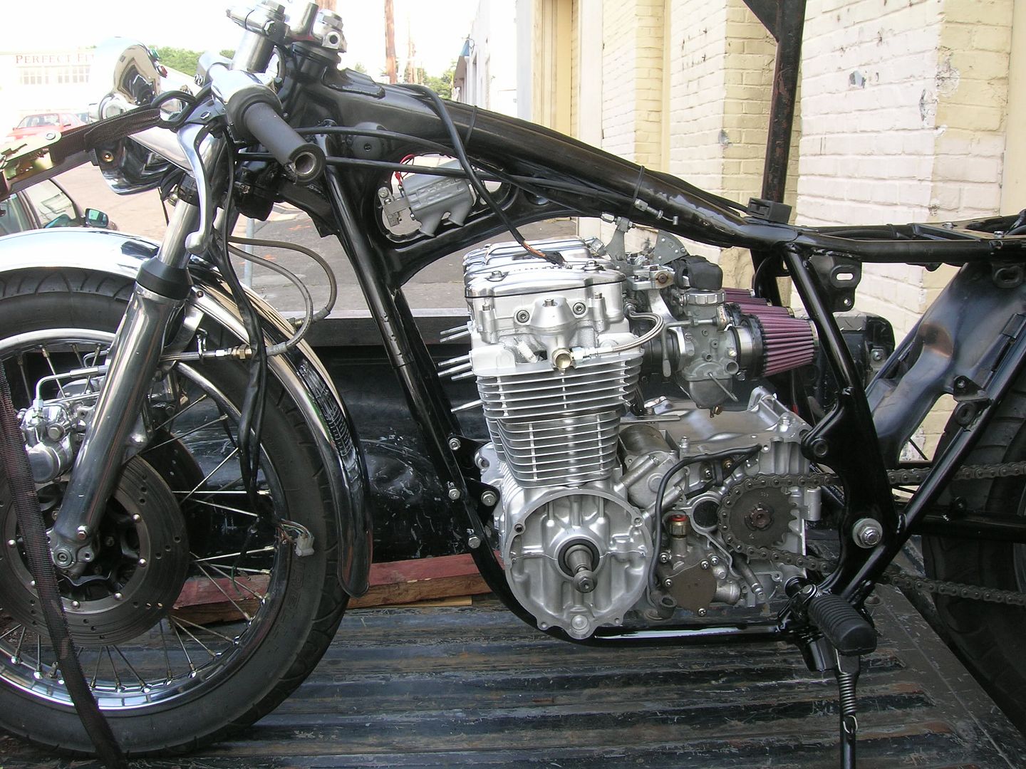

« Reply #20 on: August 08, 2008, 04:17:31 PM »
You've done so much work on this bike, don't suffocate it by adding MAC exhaust... Have you considered a custom (tuned-length) 4-2 exhaust with straight pipes? I'm running straights on my '79 and it really woke up the engine. It's not all that loud, either. ;)
I got a copy of Pipemax software for just this purpose. Shoot me a PM and I'll put your specs into it to see what you need. :)
Doug
yeah, add it to the list of things to do...  ::) i do have a 1 1/4" tubing bender at my disposal and plan on getting around to making some pipes, but for now a mac is all i could find for the 650. don't worry, i'm not running the stock baffle. i'm guessing it'll be "awake" enough without worrying too much about the tuned lengths of the headers.

Looking good.  You know we want some more pics though...
more pics soon. pipes installed, wired it up... almost ready to start. i have a couple of loose ends to attend to, but it'll be done soon. then there will be lots more dirty (clean?) pictures.
