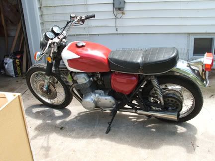

My set up, yet again. Bullet turn signals, small back brake light, bar end mirrors, clip on handle bars.
