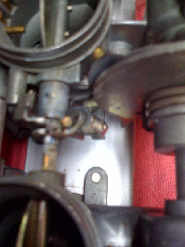

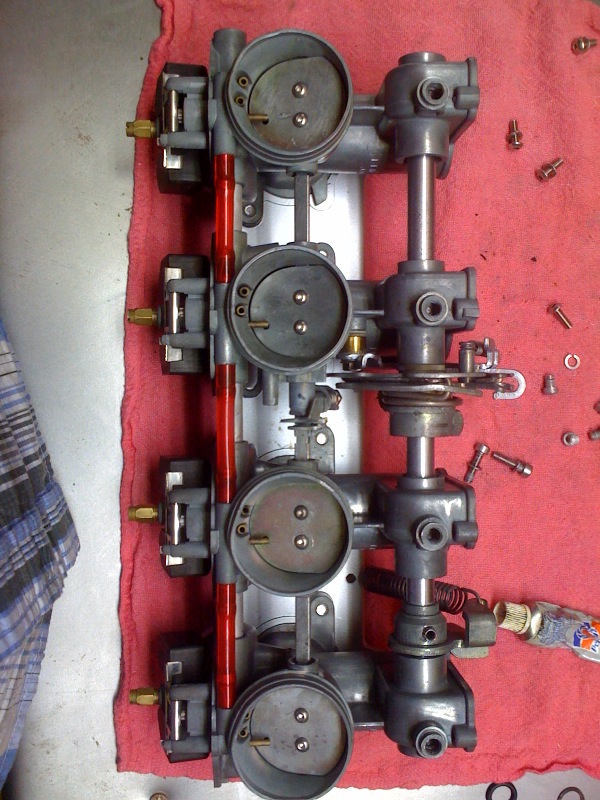

well, here's where i stand now with the carbs.  i have to order some new jets, 120's and do a final cleaning and spraying to get all the dirt and grime that might have entered while sitting on the bench.  also, i had to come up with a unique way of getting the choke assembly to work, since when i bought the carbs, the choke levers were a bit stressed and therefore broke easily while handling.  i didn't have the necessary hardware for the assembly, so i was missing the lever, springs and cable w/ holder, so what i did was weld up the two halves together and now they all turn in unison.  i used some of the green o-rings that nikki-six provided (thank you!!) in place of the felt o-rings, and these help keep the choke where i need it when it's open or closed.  sorry for the crappy iphone pics, it was pretty late and i didn't feel like searching for my camera...
since i'm going with silver and red for the paint scheme, i decided to get some red fuel line, which looks pretty dang cool if you ask me!

Very creative with the choke setup.. Probably the way Honda should have done it the first time. ;)
Those pic's are not crappy they are pretty good. Want to see crappy, let me show you some pics from my Samsung phone..
