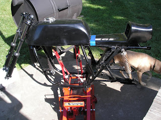

  • Posts: 77
Re: 76 CB750F SS that will eventually go zoom
« Reply #11 on: May 22, 2010, 07:14:53 PM »
Got the frame kit tacked in, I'm going to take it to someone to weld up though.
My tacks look pretty pitiful.
Good news is I managed to clean the shed up though, so now I have more places to store and put stuff without a lot of junk in the way.
Not that its a really big deal since I can't actually put the bike in the shed and work on it. But it's something.

« Reply #13 on: May 30, 2010, 01:51:46 PM »
Lucky me, I got the carb rebuild kit in before the weekend. Which means a long weekend to rebuild the carbs on the goldwing.
I was further ambitious and welded the frame kit in place. The welds look crappy, but they'll grind down. There's good penetration and I was pleasantly surprised at how
much better I got as I went along.
So with that in place, I need to grind the welds a little, clean it up and spray.
I decided next to find the rest of the spacers for the rear wheel, so I could at least get that all together and in one place.
Well here's the issue, I dont' know where the spacer that is supposed to be on the left side went to. The one on the side with the drive.
Anyone happen to know the size of it? Length, ID, and OD?
And I uncovered the engine. And looked at it :p The first step in actually getting it on the table / engine stand and working on it.

« Reply #17 on: June 26, 2010, 06:20:39 PM »
Well I had some time to dress up the welds and make them prettier on the frame kit.
