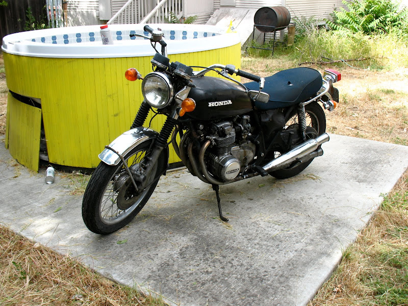

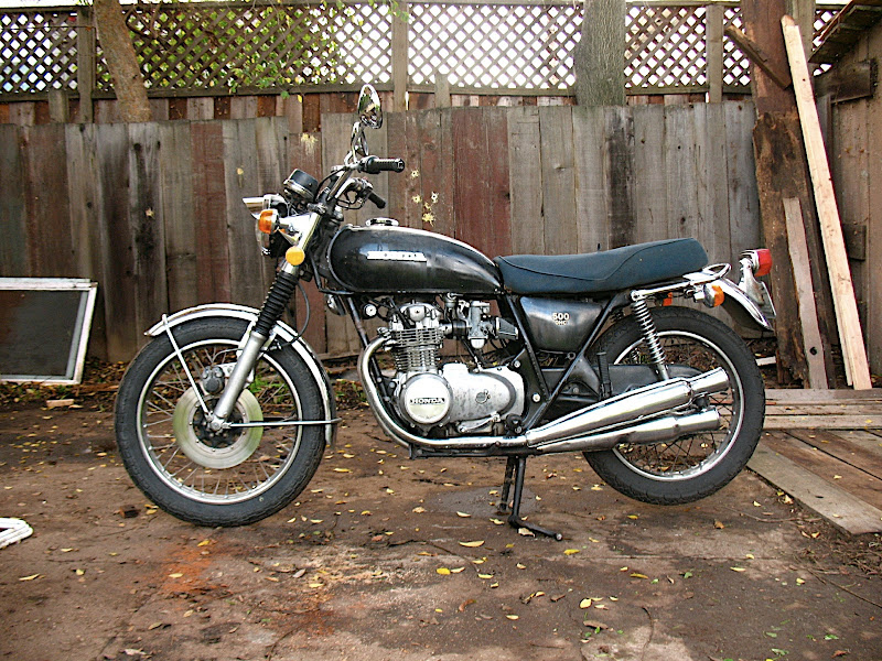

Here's the day I picked it up:

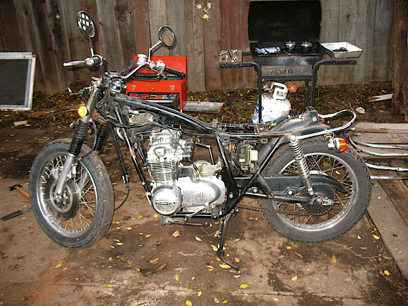

After going on several rides that ended with me pushing the motorcycle for many blocks, I started lurking in these forums for advice. Luckily, I decided to listen to TwoTired when he said to perform the basic 2,000 mile maintenance. An oil change, cleaning out the gas tank vent hole, valve/point adjustment, idle screw adjustment, and carb cleaning later, it was like i was riding a completely different bike. However, the better the bike ran, the more oil it blew out the #1 cylinder oil passage. It got to the point where a 30 minute jaunt on the freeway left my left boot so soaked in oil that I could hardly keep it from sliding out from under me when stopped. Luckily, this coincided with the rainy season, so I knew what I had to do. . .
Tear it apart!
Originally, I was just planning on rebuilding the top end, but as I graduated college, and got a job that paid way more than the $9/hr I had been making, I changed my battle plan from "Do it as cheaply as possible," to "Do it the RIGHT way, as cheaply as possible." So we begin.

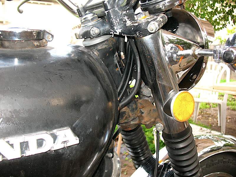

Notice the incorrect side cover:

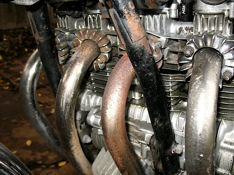

Rusty headers:

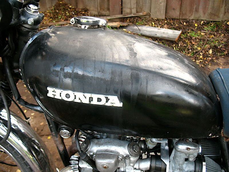

Excellent paint on the gas tank:

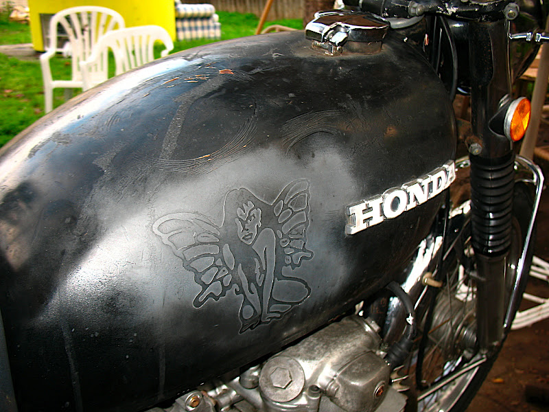

Bad ass butterfly lady sticker, that the PO had painted over. (She was my nymph of traffic protection!)

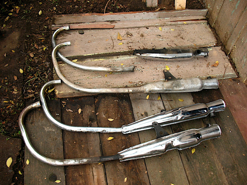

Yes, that exhaust is rusted completely in half:
No right side cover:
Rusty Triple Tree:
More of the awesome paint:
Exhaust:

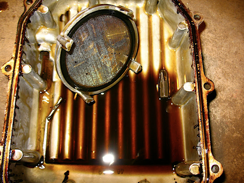

After removing the oil pan. . .
"No sludge, awesome! Wait, is that a screwdriver bit in there?!!! AND a drillbit? WTF?!!"

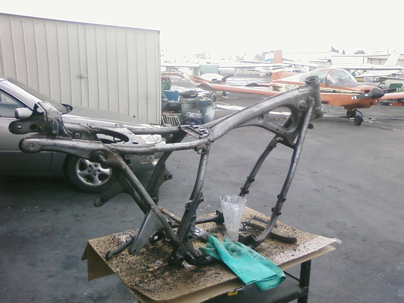

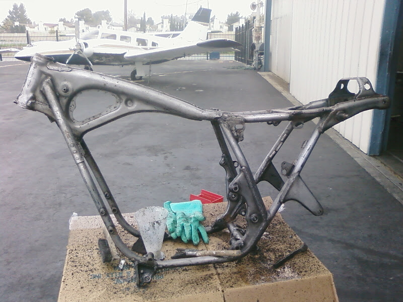

Stripping the frame at work:

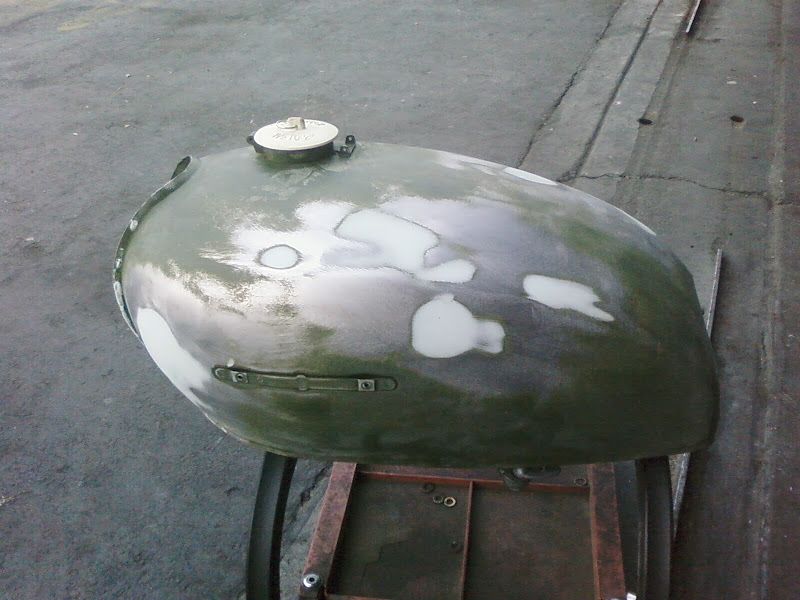

The tank sans paint:
Bondo time:
Before/After red scotchbrite:

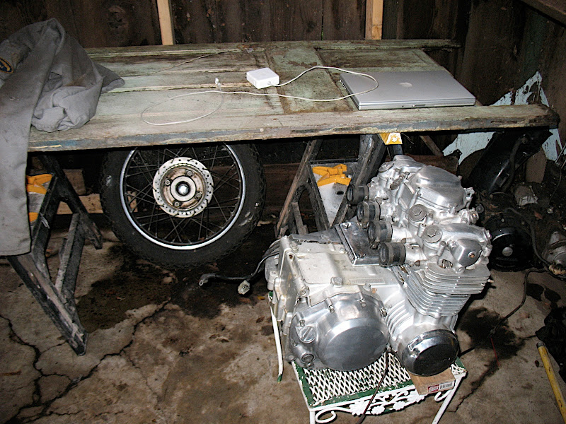

My excellent workspace: Door on sawhorses for a bench, laptop to reference shop manual.

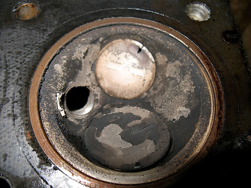

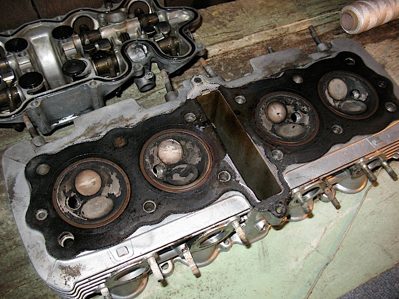

One burned valve, and plenty of carbon buildup:
Tons of carbon buildup, but the cylinders, pistons, and rings are in great shape. No marks other than the crosshatch pattern from being honed!

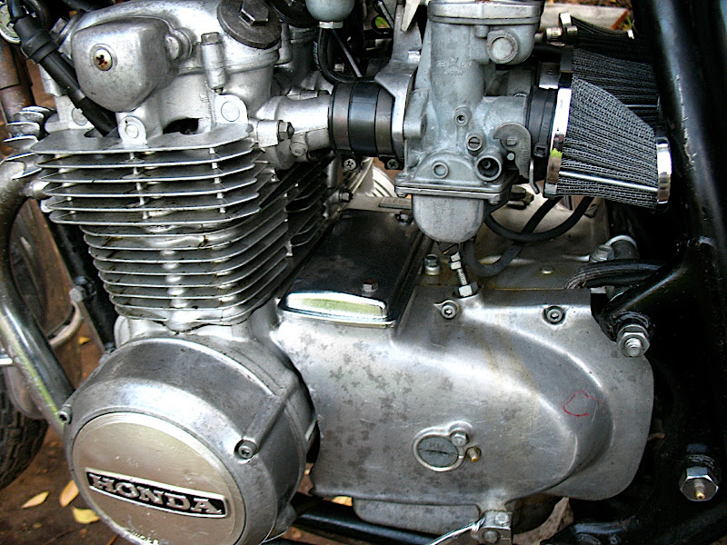

That carbon: two things are causing it.
1.) The pod air filters will make the engine run rich and it will have a large "flat spot" in the 1500-3500 RPM range because of them: try to find some that have velocity stacks inside, or maybe a stock airbox with those stacks. It will REALLY help.
2.) I'd be willing to bet a set of gas cap hinge screws that it had D8E sparkplugs in it: they should be D7E or X22ES-U plugs.
While it's apart: take a close look at the interface of the carb castings to the head: they were often out by 1.0-1.5mm, restricting flow. On the 1972 model, the idle vacuum port screws were almost 1/4" long INSIDE those tubes, too! Not much attention was paid to those little things in those days, and it hurt the performance - but they can be fixed!  ;)

Thank you for the carbon buildup advice. I wasn't sure if that was normal with age, or if there was another cause. After reading some tirades against pod filters a few months ago, I picked up an airbox and decent rubber boots off of eBay. When the motorcycle comes back together they'll come out of hiding and onto the bike. The #1 and #4 pods look ridiculous all smashed up against the frame.
It actually did come with D7E8 plugs. ;D One was oil fouled so bad when I bought the motorcycle that it would be indecent of me to show the pictures on this illustrious forum. I figured I had a bad valve guide, but after adjusting the valves that first time, the fouling went away. Hooray for maintenance neglect!  :-\
Is this the port polish I've read about elsewhere?
Nope, it's called "port matching" and is different than porting.

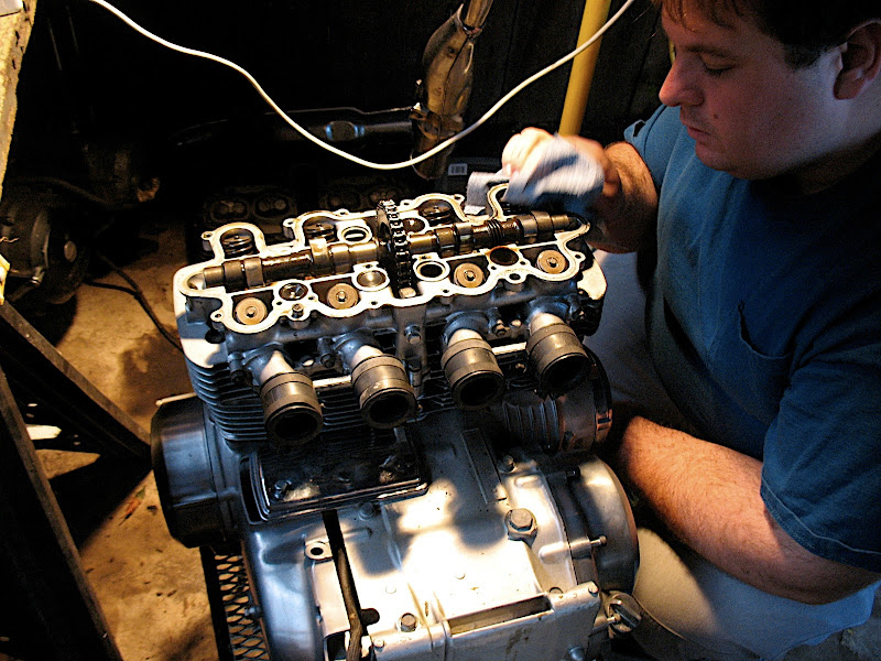

Cleaning up engine bits while I have the motor apart. I understand that the case and the cylinder cooling fins are painted. Is the valve cover painted too, or is was it just clear coated aluminum out of the factory?
-Monte

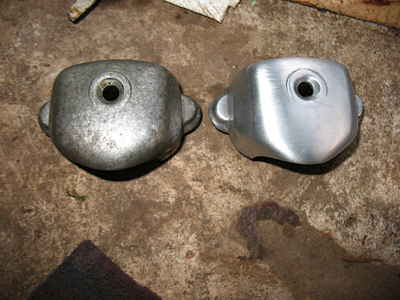

The valve cover looks awful, the paint is peeling off all over the place. I would like to paint it, but that will make the cooling fins look even worse than they do right now (at least they're clean for the first time in years). But if I paint the jugs, it will make the case look even dingier than it already does. I'd paint the whole thing, but there's no way I can cure the whole engine in my stove, and I have no desire to split the cases.  :-\
Maybe I'll just suck it up and paint the jugs, head, and valve cover. I didn't come this far just to put a totally crappy looking engine back into a freshly powder coated frame, after all!  ;D

I used duplicolor engine enamel on my Cb450 engine.  It goes on great, dries nicely, and so far its been very tough against the odd drippings of brake cleaner.  As long as the engine is out, have at it.  Just remember that the prep is everything!

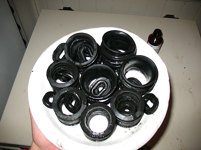

Yesterday, I decided to embark upon some redneck chemistry and soften my carb boots, via what I'd learned from the FAQ's. I figured while I was at it, I might as well try to revive some other smaller rubber parts.
Here we have some of the parts ready to dunk in the boiling mixture of 4oz Wintergreen oil and water. I couldn't get two of the boots off of the intake without tearing them, so I decided to just toss it in as is:
Here we have a magnificent stew of rubber parts boiling for 20 minutes:
Bon Appetite!
I am happy to report that the wintergreen works fantastically well. In fact, too well for smaller parts. The frame grommets that hold the side panels in are ridiculously soft; It also fused two of them together. Luckily, I dunked two sets in the mix, and can make a full set from the ones I have left that are useable. The carb boots probably could have stayed in longer, but they are still significantly softer than they were before. The airbox to carb boots rather large cracks in them prior to softening, I just threw them in to see what would happen.

Well, I didn't have work today, so I thought I would be incredibly productive.
After 8 hours of solid work, I'm proud to report that the valves and head gasket have been removed from my new (to me) head.
Thats it.
After heading to Sears to purchase their $20 valve spring compressor, removing the valves was a snap. I imagine re-installing them will be a fairly large pain, but I'll worry about that later. After the valves came out, I sat down and spent the next 6 hours of my flippin' day scraping the old head gasket off. What a freakin battle that was. Even with the proper (and repeated) application of gasket remover/brake parts cleaner/whatever I could get my hands on, that bad boy put up a strong fight. I left a couple of decent gouges in the face, hopefully that doesn't come back and bite me. After the fifth hour though, my patience was wearing thin.
After the head gasket battle, I tried my hand at the front forks again. I'd hosed them down with PB blaster the night before, to see it would have any effect. I got one of them to turn, however, it turns out its stripped.
With that in mind, must I remove the fork uppers to install new fork seals, or should I be looking for another pair of forks elsewhere?
-Monte

Monte,
Shoot - I just reread your previous post regarding the fork springs.  Are the lower forks removed from the spring assembly?  Parts #7 (Damper) and #6 & #11 (Fork Lowers) in the diagram below.
If not, that might be the casuse of your problem moving that Nut Lock - (#9) in the digram.  To remove the Damper from the fork lowers, The 8 MM Socket (#17) must first be removed from the bottom of the Fork Lower.  Without the Upper Fork Tubes on, this may be difficult.  I removed mine (Cb450 and CB500 Forks are pretty much interchangable) with the Upper Forks still assembled, and with an air impact wrench.  There are numerous stickies on getting your forks apart, and I have even seen a video on Youtube with someone step-by-step rebuilding CB500 Forks.
AS for the fork seals, check out my build thread, and make sure your do not follow my mistakes!!!!  At the end, everything was seated correctly.  Use heat (Boiling pot of water or a heat gun) to expand the aluminium so that it is easier to get the old seals ou tand the new ones in.  Used the old seals to drive the new ones in.
Let me know if I did not read that post right, and we will get her all figured out.
