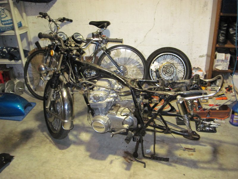

'Twas a beautiful, sunny day here in NorCal, so I jumped at the opportunity to spend some quality time with my 10mm socket and dismantle The Eviscerator.  The bike started out today looking like this:
And now it looks like this:
A very productive day, indeed!  Had to put down my wrenches at 10:30 pm to avoid pissing off the neighbor again.  Possibly a good thing, because I might still be out there in the garage otherwise.  This new hobby is crazy addictive.  I really didn't even eat a proper dinner; only just now have I managed to scrounge together some snacks.  I took my time so I could document and label the piss out of everything to ensure I could put it back together properly.

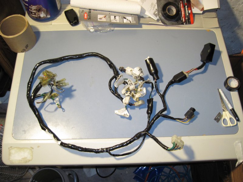

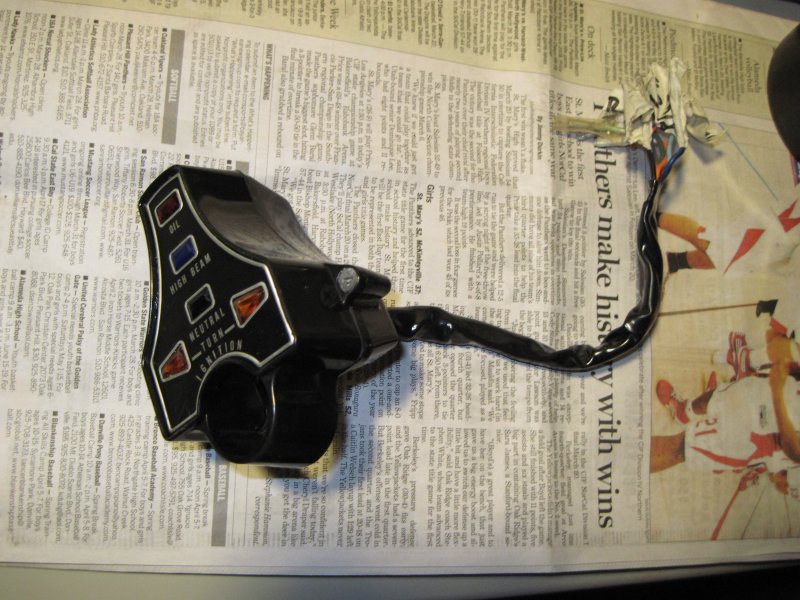

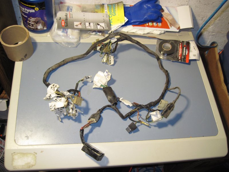

This brings me to my first anomaly.  I took out the main electrical panel, the brain if you will, where the R&R sits and everything connects up.  On the back side, towards the air filter, I found a connector that was not connected to anything, and I couldn't find where it might supposedly belong:
Anyone have a clue as to what this green-wire connector is for, and what it actually connects to?  I didn't purposefully disconnect it, so either it came off accidentally during my manipulations, someone disconnected it years ago, it's for diagnostic purposes and doesn't have a home, or it belongs to a component which has since been replaced by something vastly superior and been rendered futile.  Can anyone shed some light on this conundrum?

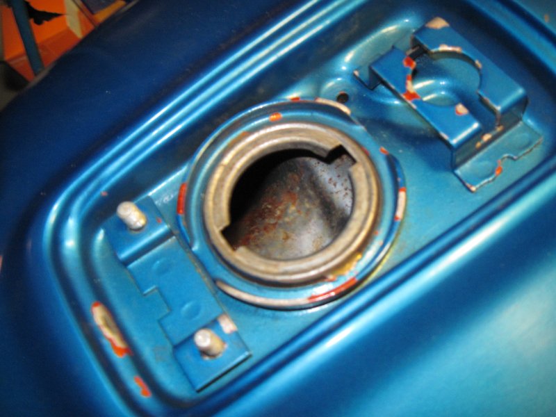

Gross rust all over the place; thank god for the sleeve or else that #$%* would be in the carbs.

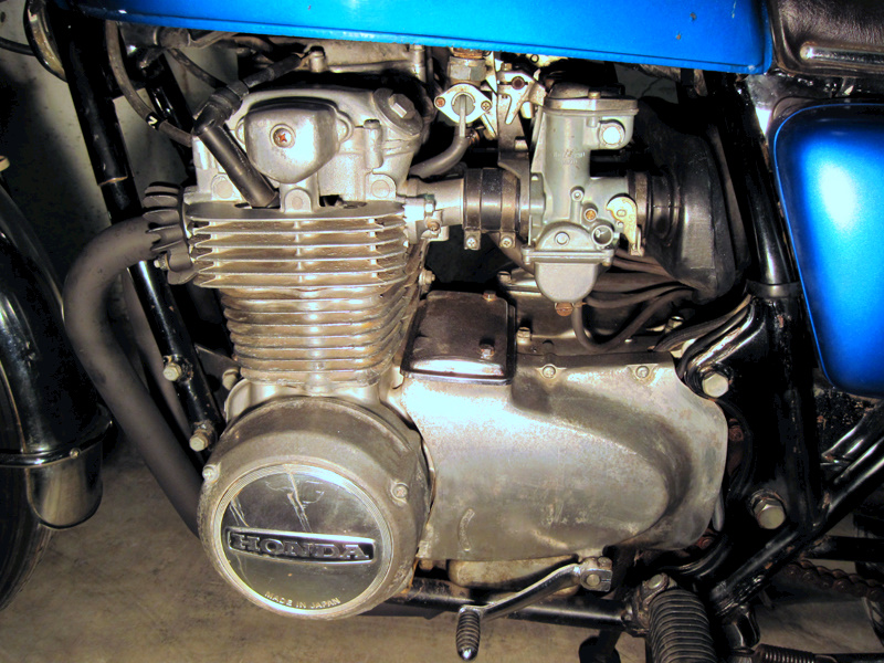

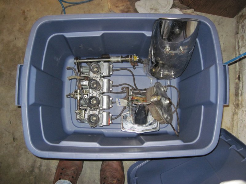

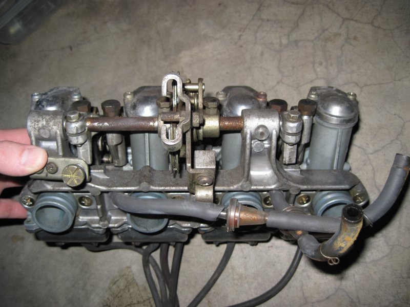

Carbs look to be in really nice shape....
although there is some level of rust.

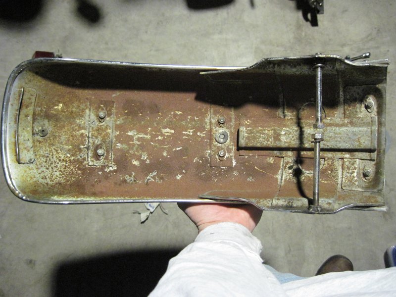

Surface rust on the underside of the rear fender.

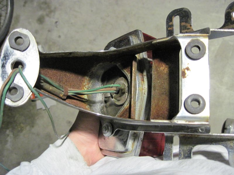

Also a good deal of rust on the underside of the tail light assembly.  This will go into storage, since I don't plan on using it on The Eviscerator; however, I will attempt to prevent the rust from getting any worse.

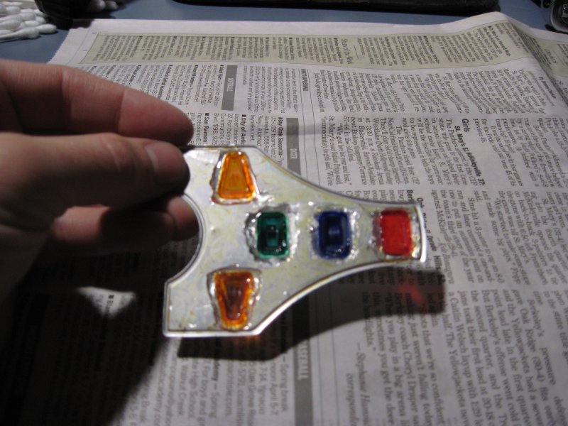

My first "restored" piece!  As soon as I got this plastic rear fender off, I couldn't help but immediately give it a thorough scrub-down with a little degreaser solution.
The parts boxes are getting fat.

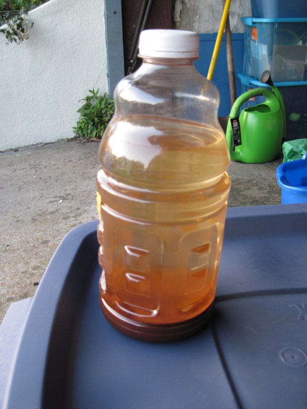

The new cycle tank rust kit came in on Friday.  My first order of business after disassembly will be to fix that rust problem with the tank; it's really all over the place on the inside.
As I left her in the garage... until next time!

ANY green wire on a CB is a ground wire.  Just run it to the nearest frame screw and land it under there and you're covered.

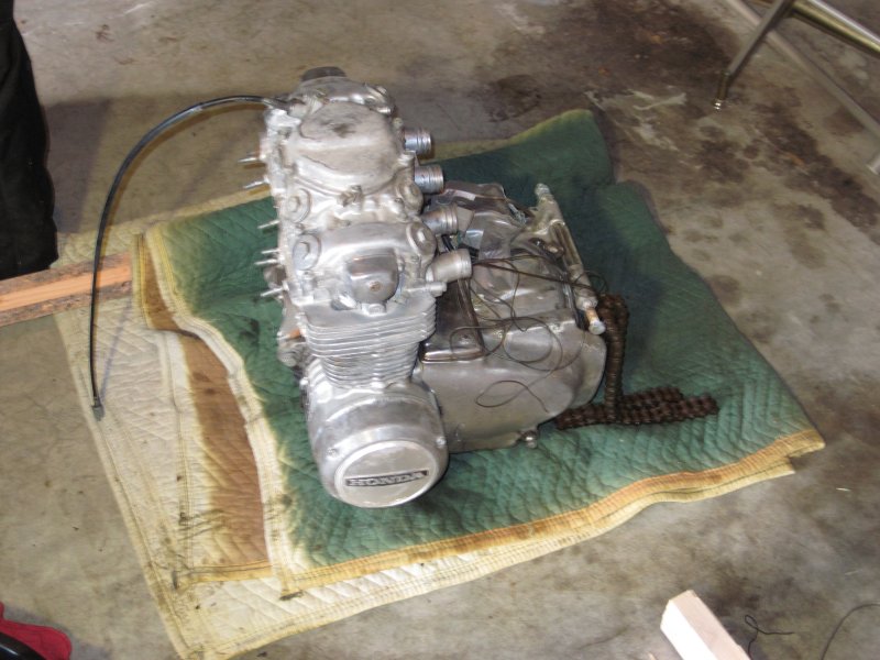

Yep, that's what I'm planning on doing to remove the engine.  Saw it posted here in some forum and decided that's the way to go!  Thanks for the tip on the green wire.  I'll have to trace where it's going and figure out whether that was causing something to fail or whether it was just extraneous.  All electrical bits functioned perfectly prior to disassembly, so I dunno?

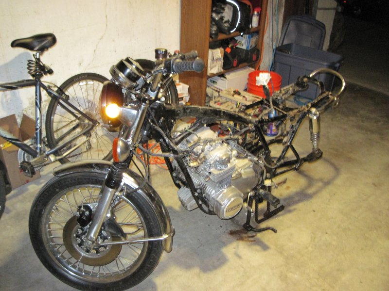

So for a Day 2 update:
Made some really nice progress again this evening.  I'll just list everything off, and then post some pics tomorrow.  Most of my pics tonight were close-up shots for re-assembly documentation purposes, and won't be of much interest here.
  • Drained brake fluid, separated master cylinder and lever from handlebars
  • Disconnected & removed headlight
  • Removed the handlebars and gauge assembly
  • Removed main wiring harness, after labeling everything
  • Removed shifter lever, kick-start lever, right footrest
  • Removed grab bar and shocks
  • Bought a high-RPM exhaust fan to ventilate the garage better so as to not annoy my downstairs neighbor  :-\

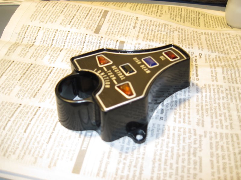

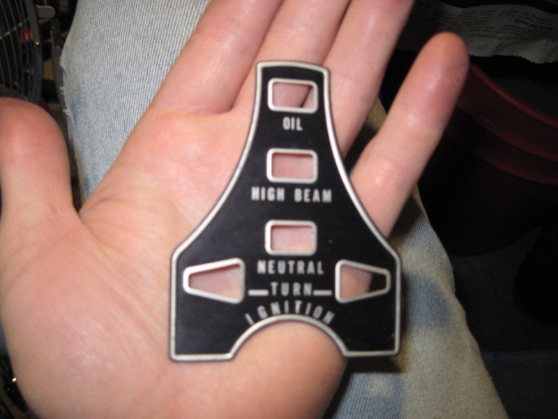

Ran into one sad issue during the removal of the gauges.  When I fully loosened the right bolt that secures the ignition switch, I received not only the bolt and washer but also a small handful of broken shards of that piece of crap pot metal housing that sits between the electrical connector block and the key switch itself.  So now the right side of that housing cannot be secured down.  Looks like the pot metal entirely degraded over time and my loosening the bolt either snapped the bolt hole surround off, or it was already broken and I just revealed it.  Couldn't be sure.  Can't seem to find a replacement OEM lock set; does anyone know of a quality aftermarket version for this?  Ideally, it would also include the seat lock to have a matching key, but I suppose that part is not broken (yet) so I might as well keep it original.  I found this aftermarket assembly on OldBikeBarn.com, although it's $45 and doesn't include the seat lock assembly.  :'(   I suppose I could also try and jerry-rig something together to re-attach that right side, but I'm not in the mood to jerry-rig anything.  Now's the time to fix it right, permanently (well, semi-permanently).
The bike is looking really bare now!  I don't yet own a front stand, so I can't remove the wheel or forks yet.  About the only things left that I can do until I figure out the stand issue is the front calipers and fender.  Tomorrow I suppose I'll cobble together a little frame out of wood in order to support the engine when it comes time to turn her on her side and lift off the frame.  I went down to Home Depot and secured some pieces of scrap wood that they use to band together large stacks of 2x4s or 4x8 sheets of plywood.  I asked the guy if I could have a handful of these 2x3 boards (~4 feet long each), and he gave them to me free (sweet!)  They're completely serviceable for this purpose, and you can't beat the price.
Just a day or two left of disassembly work and then it's time to start the restoration phase.  Moving along steadily now!

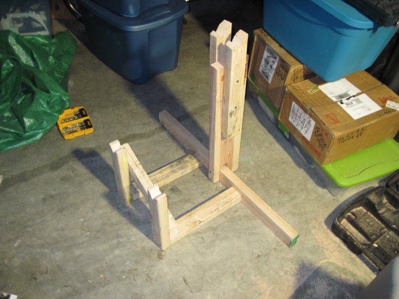

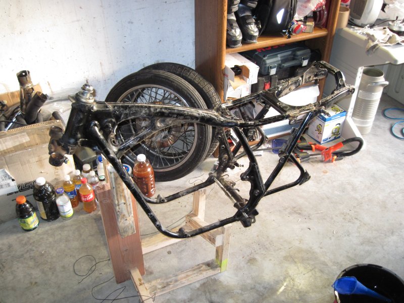

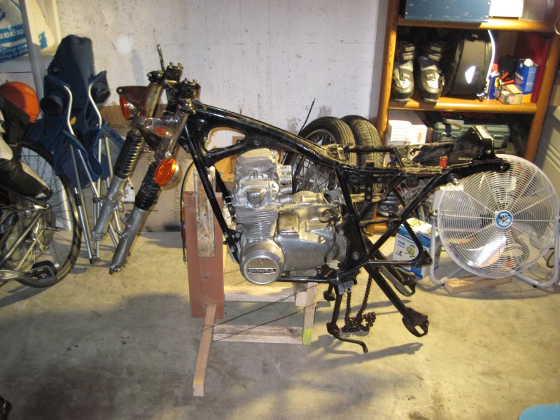

Tonight I'll be building a wooden support frame to aid in removal of the front wheel and forks, and then with any luck, turn what's left over on its side, unbolt the engine, and lift off the frame.  Could be completely apart by midnight!  It's just too much fun.  During the day I stare at the inspiration images to, well, inspire me :-)

Day 3.  Didn't get as much done tonight as I'd hoped, but did make some decent headway.  I first built a little stand out of wood as mentioned in my prior posts to support the engine/frame to help in removing the forks and front wheel.  Spent about a half hour cobbling this thing together out of wood I got from the scrap bin at Home Depot for less than $2...
and here it is in use:
It's definitely not the most beautiful piece of woodwork I've ever done, but with its very short intended lifespan it'll suffice.  With some clever maneuvering I managed to get the "bike" up onto the stand by myself.  Having a hard time calling it a bike at this moment, since there's so little left.  Once on the stand, I removed the front wheel, fender, and brake assembly.  That was pretty much the extent to what I was able to actually do with the bike itself.  I realized I didn't have the right socket to remove the forks... time for another trip to the hardware store tomorrow!
Tomorrow will be removal of the forks and triple, then time to turn this baby on her side and "drop" out the engine.  Then just a few last pieces, such as the battery box and swing arm, and she'll be completely disassembled.  Assuming that all goes well, I'll start cleaning the bits that I can and also take inventory of what I want to switch around, what's broken and needs replacing, etc.  I'd really like to get at the gas tank, as I have the tank cleaner and sealer kit already.  That might have to wait until the weekend, however, so that I can properly ventilate the garage as I do so.  It'll also make a helluva racket as I toss in some nuts, bolts, and BBs to knock all the rusted bits loose, so my neighbor won't appreciate the racket at midnight.

Day 4 update:
The new front and rear sprockets (JT) arrived today after getting misrouted by UPS (thanks, guys!)  Bought them from Bike Bandit.  Also received the new 530x100 EK heavy duty chain which I picked up from an EBay dealer.  They went straight into my "finished" bin.
I spent most of the evening working on the main wiring harness.  It started out all dusty and grimy:
and now it's clean and shiny:
I cut off all of the old tape, cleaned up the rubber sleeves with a damp towel and some elbow grease, removed tacky bits with some acetone, and then re-taped the whole thing from one end to the other.  I inspected all of the wires and connectors first, and didn't spot any problems.  The plastic sleeves around a few of the connectors have some minor amounts of gunk inside them, and I'm not able to remove it effectively since the sleeve is pressed around the wire.  Perhaps some electronic cleaning spray will help.  I don't think it's even remotely an issue, since the connector metal looks really good everywhere I've checked, but my OCD/perfectionist traits are kicking in.
The last bit of cleaning/detailing work was on the air intake chamber and the blinker horn:
I plan on wiring up a rheostat or potentiometer inline with that blinker horn in order to enable some serious volume control.  That thing is far too annoying.  I like the idea, as it'd be nice to have a reminder to turn off the blinker, but DAMN.  Does it have to be deafening?
Seven items now occupy the finished bin; I can already see this guy coming back together!

When I cleaned my harness I just used rubbing alcohol on a bunch of q tips to get into those connectors, worked pretty well.  And then I drank a bunch of beer.
That sounds like a great idea.  Actually, what I can use is a little vodka... drink a bit, use a bit, drink a bit, use a bit.  And by night's end everything will be all right!   ;D

My work tonight centered on the gauges.  As I was disassembling the "pilot combination" to clean the plastic parts, I noticed the little aluminum plate that holds the semi-transparent colored plastic light filters was a little loose.  This led to a time-consuming side task which I hadn't originally intended, but it came out nice in the end.  I first gently worked the plate off, scraped away some of the ancient glue, and then removed all of the plastic filters.  It cleaned up real nice:
Then I cleaned up the five plastic filters by soaking them in acetone for 15 minutes.  This completely freed up the old glue that was caked onto their perimeters, and it all came right off.  I then used a little isopropyl alcohol (IPA) to polish the plastic with a Q-tip, then reseated and glued them all back into place with a little clear plastic epoxy:
Cleaned up the plastic housing with a little degreaser solution, then glued the plate back on with some more plastic epoxy:
Cleaned up the wiring and bottom plastic mount with some more IPA, then re-assembled.  I spent well over an hour detailing just this one part (mostly fixing the plate); however, aside from a few scuff marks here and there, it now looks like it did 35 years ago when it rolled off the assembly line:
I tried to take apart the speedo and tach, but couldn't figure out how to do it.  I suppose that's a security thing, to keep odometer mischief at a minimum.  The parts are pretty clean to begin with, but I'd like to repaint the housing in black and clean the inside glass, as I can see streaks in there.  I'll have to search on here for some tips on how to get those things cracked open... seen people post their custom gauge overlays, so there's gotta be a way to do it!

Day 7 Update:
Got zero done on Friday, owing to an extensive problem set in my computational chemistry course that literally took me all night to finish.  God damn science is getting in the way of my build!  Today, however, was a beautiful day in NorCal, and I got the better part of 8 solid hours work in:
  • Removed top triple and front forks
  • Pulled off the center stand and swing arm
  • Dismounted the engine!
  • Pulled off the battery casing, leaving the frame almost completely bare now
I don't have that special tool to remove the cylinder that mounts the lower part of the triple and bearings, so that still needs to be done.  The bulk of my time today was spent cleaning the gas tank, in preparation for the acid wash I'll give it tomorrow.  The KBS coating package that I got includes this phosphoric acid + zinc solution which will etch away the rust inside the tank and leave a thin zinc phosphate film.  When you put on the final sealer, it bonds to the phosphate and makes a permanent, rust-proof sealant.  Well, that's the idea, anyways.
First step was to clean out all the gunk inside the tank.  I first threw in a hundred or so small nuts and washers, along with a couple thousand BBs (from a BB gun) to serve as abrasives.  Sealed up the petcock hole with a little rubber piece I cut out to fit, then clamped down with your ordinary ring hose clamp type thing.  The top was much harder to seal; my first attempt with duct tape was a complete disaster.  Leaked like crazy, as the seal gave way quite rapidly.  My second attempt was with PVC electrical tape, and that held out better, but still it gave way after a while.  Sigh.  Prior to sealing up the inlet hole, I poured in the 1:1 cleaner:hot water solution (about 1L worth).  The cleaner that comes with the kit I think is just some ordinary degreaser type solution.
I shook that gas tank around like mad for the better part of 20 minutes, really scraping every last nook and cranny on the insides with those BBs and nuts.  The solution was somewhat foamy, but not to the point there were only bubbles.  After draining out the results, I got this nasty mess:
This was after the rust and gunk had settled to the bottom of the bottle, forming a 1" deposit.  After shaking it up to demonstrate its nastiness:
Cocktail, anyone?  I can't believe all that crap came out of that tank.  I'm sure glad it did, though!  I saved half of the original cleaning solution for a second pass, and that turned out much less rusty.  After filling the tank more than 5 times with hot water and shaking the nuts and BBs around on the inside, the last few washes came out completely clean, no rust or gunk at all.  Success!  Tank is finally free of loose particles and crap.
Here's the tank before any cleaning:
and now here's how she looks:
I scrubbed the top inlet with a scouring pad and some degreaser to shine it up a bit.  The insides look far better than they did before, albeit there's still some surface rust.  The rust is not loose, so it will only come off with an appropriate chemical etch.  That's next!  The hardest part of cleaning the tank was getting the god damned BBs and nuts back out.  I must have spent the better part of a half hour trying to shake them out.  Man, what a complete PITA.
Here's where I left off:
Getting the engine out was somewhat of a pain, also.  I knew about the trick with turning the frame on its side, unbolting the engine, then lifting the frame right off.  What I didn't know was which side to choose.  I first leaned it against the left side (chain side), but I couldn't for the life of me figure out a way to wrangle the frame off.  So I just flipped her over and tried from the right side.  Worked a helluva lot better!  Once the engine and frame parted company, I scrubbed the frame down with some degreaser solution and a light scouring pad to prep her for blasting and eventual powder coating.

I thought you were showing us your spit bottle.

No need to do any frame cleaning yourself, if your going to powdercoat it, as the sandplasting prep will do all of that for you.
while you have the motor out, make sure the cam chain is still good, and clean and paint that baby up before reinstalling in the frame.  Cleaning the motor in the frame?  Well speaking from PERSONAL experience on my build, it's a hell of a lot of work. :'(
Oh....and go to tapered bearings in the head tube!
Just my .02
~Joe
I want to sandblast the frame myself, assuming I can find an appropriate place to do so.  So I felt cleaning off 3-decades' worth the sludge and grime would provide a better surface for easier blasting.  Didn't take much effort, at any rate.
I was planning on taking the motor apart and inspecting everything while cleaning, blasting, and then repainting all of the exterior surfaces.  I'll make sure the cam chain is on that list.
And tapered bearings have already been ordered!  I just need that 48 mm pin spanner tool to remove the steering stem and fully bare the frame in all its glory.
