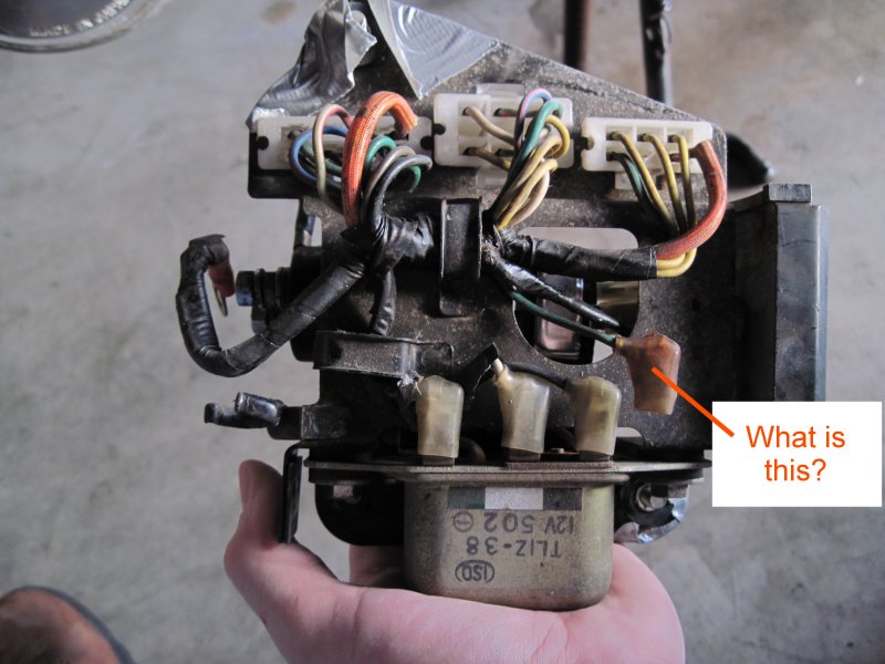

This brings me to my first anomaly.  I took out the main electrical panel, the brain if you will, where the R&R sits and everything connects up.  On the back side, towards the air filter, I found a connector that was not connected to anything, and I couldn't find where it might supposedly belong:
Anyone have a clue as to what this green-wire connector is for, and what it actually connects to?  I didn't purposefully disconnect it, so either it came off accidentally during my manipulations, someone disconnected it years ago, it's for diagnostic purposes and doesn't have a home, or it belongs to a component which has since been replaced by something vastly superior and been rendered futile.  Can anyone shed some light on this conundrum?

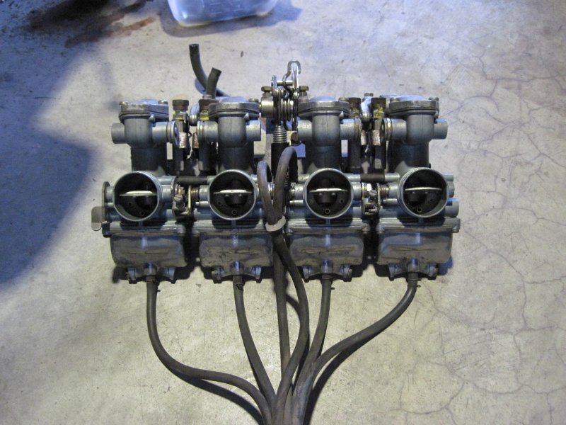

Carbs look to be in really nice shape....
although there is some level of rust.

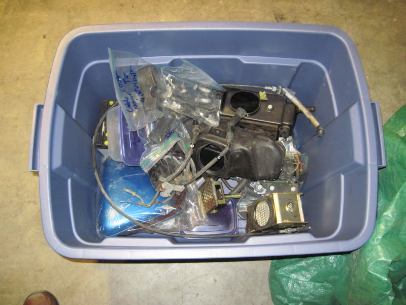

The parts boxes are getting fat.

ANY green wire on a CB is a ground wire.  Just run it to the nearest frame screw and land it under there and you're covered.

I spent most of the evening working on the main wiring harness.  It started out all dusty and grimy:
and now it's clean and shiny:
I cut off all of the old tape, cleaned up the rubber sleeves with a damp towel and some elbow grease, removed tacky bits with some acetone, and then re-taped the whole thing from one end to the other.  I inspected all of the wires and connectors first, and didn't spot any problems.  The plastic sleeves around a few of the connectors have some minor amounts of gunk inside them, and I'm not able to remove it effectively since the sleeve is pressed around the wire.  Perhaps some electronic cleaning spray will help.  I don't think it's even remotely an issue, since the connector metal looks really good everywhere I've checked, but my OCD/perfectionist traits are kicking in.

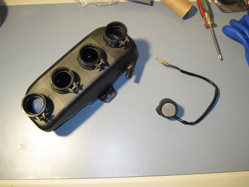

The last bit of cleaning/detailing work was on the air intake chamber and the blinker horn:
I plan on wiring up a rheostat or potentiometer inline with that blinker horn in order to enable some serious volume control.  That thing is far too annoying.  I like the idea, as it'd be nice to have a reminder to turn off the blinker, but DAMN.  Does it have to be deafening?
Seven items now occupy the finished bin; I can already see this guy coming back together!
