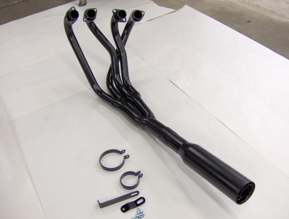

Just placed an order for one of Tintop's anti-pod kits.  I think performance wise this is going to be the best approach.
Also plan on ordering this exhaust from CycleX this week:
Once I have these two things, I should be able to fine tune the carburetors.
Until then, I just have to take care of a couple things the state requires to title a bike:  horn (lame), horizontal license plate (lame), brake light switch for foot pedal (not so lame I guess).  Then it's on to the business of title application.

Ok here's how the CycleX exhaust looks.  I am pretty pleased for the most part, but I still don't have a lot of ground clearance (probably because I'm only starting with about 5" from the frame to begin with).  If you look though, there is room to bend the pipes a little and bring in up more in line with the frame.
Sounds great though!  Much quieter than the four straight pipes, but still loud enough to command attention.

I agree. Bend the headers just a degree or two to get them closer to the frame. Then pull the muffler off the headers and put in a short extension pipe - 6 to 8". Bend that pipe just about the same spot as the frame does to have the pipe follow the line of the frame than slap the muffler back on. It will look much slicker.
Great job on the bike overall. I like the engine's color scheme!  ;)
