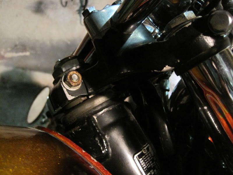

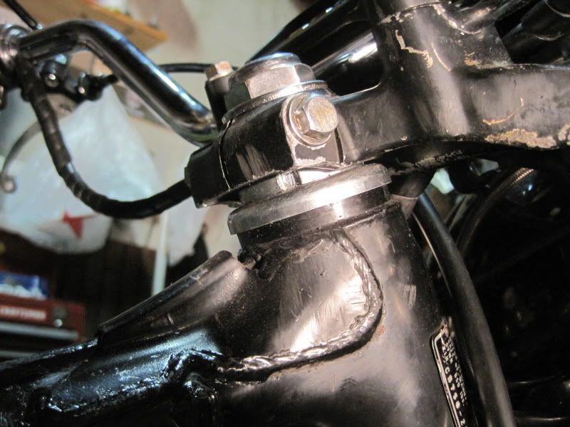

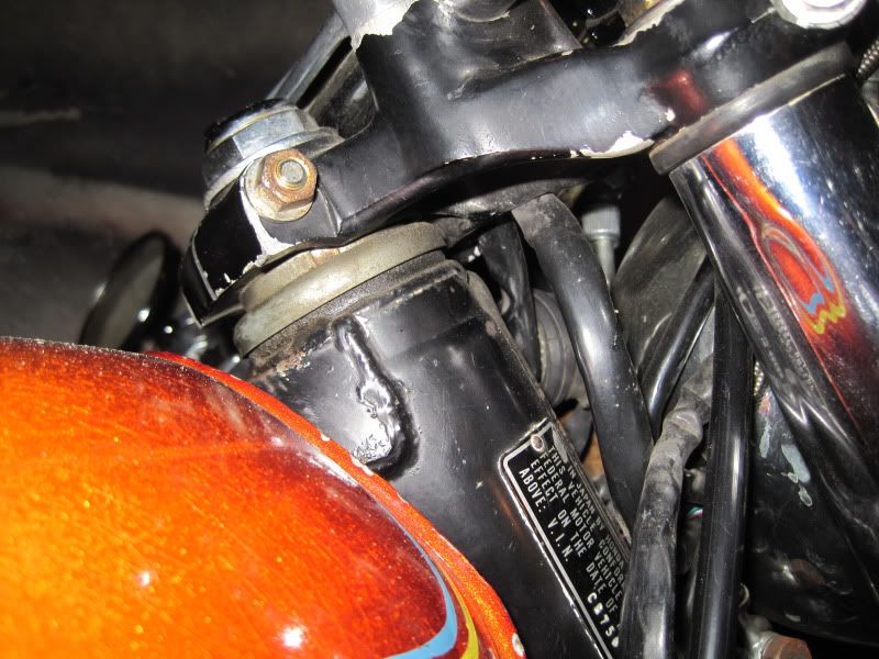

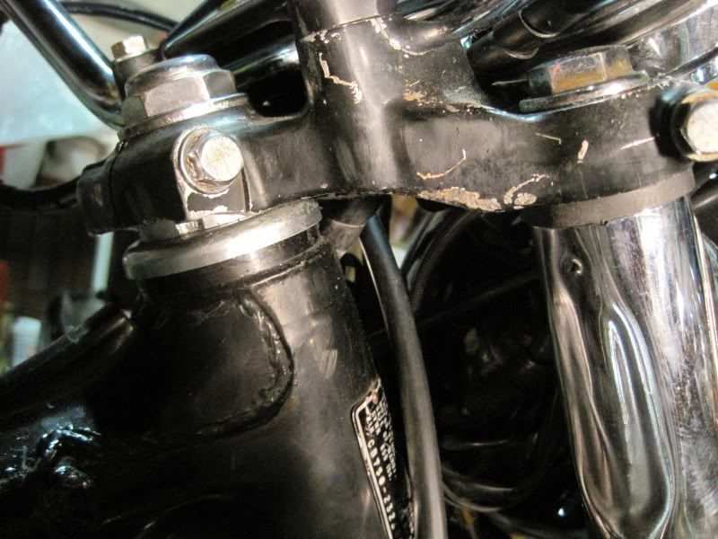

Steering head bearings - clunk clunk..
Sunday I checked the steering head bearings after installing Alls Ball bearings over the winter and riding for about 50 miles. There was a clunk coming from the front end when coming to a stop or sometimes when hitting a bump. So checked them and they were loose - no problem tighten them up. Rode last night - nice and firm. Rode to work today -4 miles each way. On the way home..clunk again...checked the front wheel this time..a very small amount of free play from front wheel - how much should there be - front bearing perhaps? However then I checked the steering head nut again and again it was loose...??...so this time I went through every nut and bolt and tightened again...all firm now...havent had a chance to test ride yet but....why would it "unwind" itself?
I followed Johnies instructions per the photos and all spacers seemed to be in the right place....anyone else come across this?
Some photos after its all tightened up....
The K4 - is it seating correctly?
But looks the same as the K2 (which has been untouched!)

I had to adjust the steering bearings on my 92 nighthawk earlier this spring for the same reason. I had probably 10,000 miles on them and was noticing that 'clunk' I know for fact that the nut on that bike didn't loosen itself as the top nut has a tabbed lockwasher sandwiched with a checknut, just torque it and bend the tabs up and down to keep things in place. I'm not sure how long mine was out of adjustment, maybe it was all my spring riding on potholed highways that helped set the races a little tighter in the neck? But I raised the front of the bike and tightened it up until I couldn't feel any 'clunk' while pulling on the front wheel.
About a thousand miles later, yesterday while I had it all apart to rebuild the forks I checked again for any play in the steering that I could feel, I found none. The slight preload I had worried about seemed to be gone too.
So in short it's probably just your tapered roller seats settling into place in the neck, no
You could always mark the orientation of the top nut with a permanent marker if you still suspect it.

Andy...I don't think it loosens up, but just needs to be seated a few times since it is new. I will need to do mine again which will be about 300 miles from the last time. It will be the 2nd time I tightened it. At least it is easy enough to do. I probably could have gone a little tighter last time, but I did not want to overdue it.
