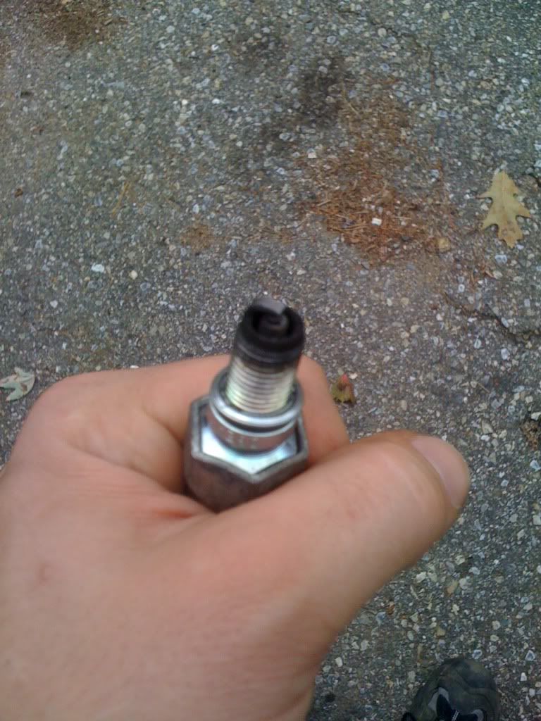

Okay. Here is my plan of attack, let me know what you all think:
I have pulled the carbs off the bike.
I checked the float heights and they were all WAY off. They were set to around 11mm vs. the Cylmers manual says 14-15mm. They have now all been set right at 14mm.
The idle mixture screws were set to 1 1/4 turns out. I have now set them all at 2 turns out.
I now am setting my sights on the needles. I have them shimmed to about the point of one clip up. I am going to drop them down to 1/2 clip up.
Then I am going to re-test (which will probably not be until Wednesday next week).
Not that I have been doing any proper plug chops, but here is what Cyl's 1&4 look like at the plug (looks whiter in real life than it does in the pic):
It has been popping on decel as I have been road testing it which indicates lean, correct? The reason I put in two shims (each shim is a 1/2 step) was to smooth out the transition from slow to main jet. By enriching the idle circuit, that will give more gas to the mid range and I can drop down the needle. Or should I un-shim the bugger completely?

That plug is carbon fouled, you can find the NGK guide here: http://www.ngksparkplugs.com/tech_support/spark_plugs/faqs/faqread.asp
Interesting that you found the floats out of spec since the fuel level in the tubing looks fine, I would like to see what they look like now that you have them in spec.

That plug is carbon fouled...
No way. I know the difference. The center is white. Clear carbon around the outside, yes, but the center is not even close to fouled. Like I said, it's much whiter than it came through in the pic.
It's much closer to this in color:
Picture taken from here:
http://www.4secondsflat.com/plug_chart.html

Okay. I swapped out the plugs and did not make any other changes. Here is what the old plugs looked like when I took them out:
NO matter what I did for lighting, my cell phone just could not make them look as white as they do in real life. They really look on the lean side of normal. And they are pretty even across the board, too.
Then I put in the new D7EA plugs and went for about a 10 minute ride. The bike would not run for beans off choke. I had to run at least partial choke the whole time. Here is what #4 looked like:
Again, horrible cell phone pic. The plugs is super light and looks super lean. And that is WITH running the choke for most of the ride.
Mixture screws are set at 1 3/4 turns out. Should I give them another full turn out since it is this lean?
Floats are at 14mm. Books says they should be 14.5. I almost think I should raise them up to about 13 or 12. Maybe a jet is not getting enough fuel?

I gave you wrong information.  D7EA is hotter than D8EA.  With higher compression ratio, the plug needs to be colder.  In this case, you should have been using D9EA.
That is why the new plugs look so lean.  I'm really sorry that I gave you the wrong part number.  I got things backwards because Champion numbers ago the other way, lower for colder.  NGK is higher for colder.
I get confused in my old age.  I must be getting senile.  The heat range does need be adjusted for higher compression ratio.  A higher compresion ratio provides more energy.  The plugs may look to be more normal with the colder plug.
The colder spark range should be used to tune the main circuit, that is full throttle, full power chops.  Start there and then work your way down to the idle circuit.  You may have to go through several iterations, since all of the circuits are inter-related.
This chart from NGK
http://www.ngksparkplugs.com/docs/tech/partnumberkey.pdf  may help more than I did.
You can use any brand you like, be sure to use the correct heat range, one range colder for tuning.
Remember that you can use the standard spark plug after tuning, for general driving around.  That will generally keep it from fouling at low speeds.  But it will look lean.

running the 7's has given me an idea. It appears as though that I am running WAY lean. This would account for the idle trying to hang high. a far greater amount of air is entering the combustion chamber vs. the amount of gas that is going in. Essentially this mimics the effect of opening up the throttle at lower speeds as the jets are relatively unaffected and it is just the slow jet that is being utilized. The engine thinks that I have the right sized jet but the slide is further open thus increasing engine speed (greater Air to fuel mixture). When I get it to calm down, the engine is realizing that there is only so much fuel.
Do this make sense, or am I way off base?
I'm going to open up the mixture screws one full turn each and test with new or cleaned plugs. I should have time to work on it today. Hopefully the rain that is forecast will hold off.
