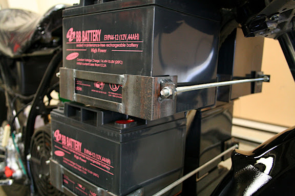

The plan has changed significantly since the sketches. I don't want to deal with all the weight and complexity of some sort of cover, so it's going to be super simple and light weight. The diagonal portion is the battery pack, consisting of 6 light weight SLA batteries. The tray that will hold the batteries will also hold the majority of the components. So the only pieces I have to fabricate are an angle iron battery tray and a motor mount which bolts into the existing motor mount (pictured below).

Yeah, a lithium pack would take my battery weight down from 78 to 25 pounds for nearly the same capacity (assuming I would be using LiPo). But until charging and balancing is less cryptic, I'll wail on some lead batteries for awhile.

That solution works really well with SLA cells, and some lithium cells (cylindrical cells like Headway). The challenge for a motorcycle is fitting all those chargers onboard a tiny two-wheeled vehicle.
