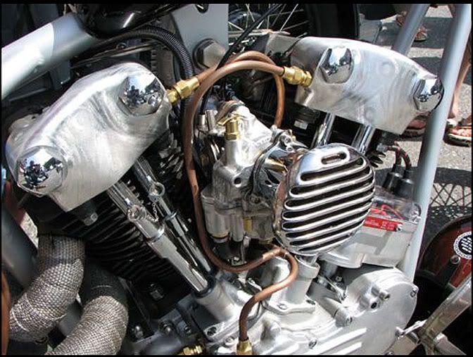

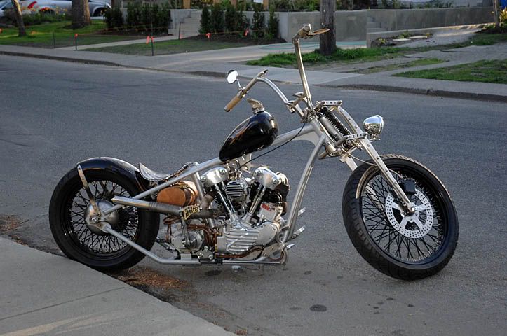

You might think about getting them powdercoated instead of paint. Far more durable and will tolerate any temperature your engine will reach . . . unless (maybe) it's about to overheat and seize,at which point whatever you've chosen is the least of your problems.

is there a silver powder-coat match ?

Talk with the local powder jockey and ask him to show you the color pallets.  They should have a fantastic match for your requirements.

« Reply #10 on: January 16, 2011, 01:19:18 AM »
Yes, I did the frame of my Knucklehead in silver powdercoat, looks great, tough as nails:
