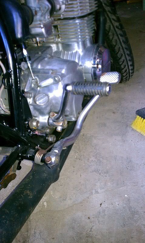

3-Can someone take a picture of the back brake set up. (specifically where the rod the brake pedal connects to, connects to the long rod that connects to the rim.)

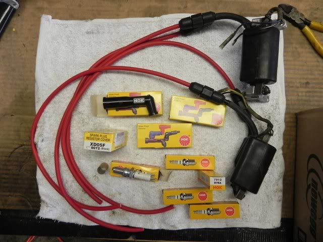

2.2 the stock coils on these bikes are beasts. they dont go out. but on the rare occasion they do you just have to buy another used one or go down the full out electrical overhaul.
i would test it out first and see if work. (have all the electrical hooked up and take off a plug put an extra spark plug on it and hold it up to the engine and hit the starter and see if it sparks.)
the way i went was kept the coils cut the cables replaced it with a dyna solid copper core used the splicers to attach and replaced the spark plug caps
you can see the model # for the spark plug caps and spark plugs
replacing the whole points plate coils wires plugs. you a lot of people can chime in on this and head you down the dyna coil path. get ready to drop $300+

Thanks for all the help. I've got a handful of this stuff done and A LOT of parts on order thanks to you all.
Here's a couple more things.
My back break doesn't seem to work right, or at all. I took it off well over a year and a half ago and I don't remember how it is supposed to go back. Here's a picture that hopefully shows how I have it right now.
I also am confused on this. It seems like I won't be able to kit start the bike because the break pedal is in the way. Does this look right?

« Reply #21 on: September 10, 2011, 12:48:28 PM »
You are missing your foot peg
