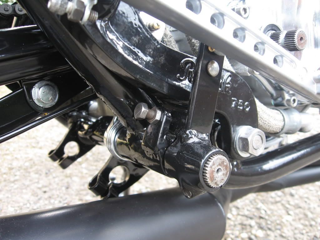

The Raask bolted in place on my 750K. The shifter side only required a slight bend in the connector rod. The brake side required a bunch of mods to the lever arm. The splined part actually broke so I wound up using the stock brake arm which is much beefier. I cut off the pedal itself and welded the Raask arm to it. Also added tabs to allow adjustment of the break pedals static position. A bit of a pain but I am very happy with the setup now. I can also kick start by flipping the peg up.

For a 750 K4, what rearsets are out there that don't use the rear the foot peg brackets as mounting points?  I'll get them welded back on if need be, but would prefer not to.  Thanks.
raask uses the rear engine mount look back a few posts there is a pic that joehardy posted
His laundry list of installation issues don't instill me with a lot of confidence in the Raask rearsets.  If that's the only set out there, I guess I'll just get the rear brackets welded back on.   :(
