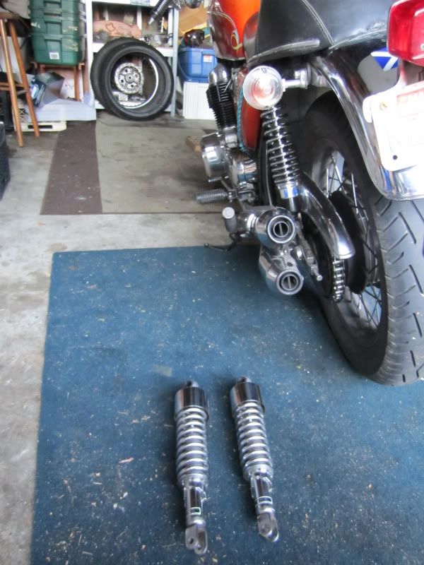

I just installed a set of Hagon 2810 shocks on my CB750K2 and thought it would be useful to provide some user feedback as these were custom made to accommodate the eye-cleavis.
Purchased from David Quinn Motorcycles. Superb service and fast turnaround. He was in contact the with UK Hagon factory about customising a set of 2810 shocks for the CB750 and they said no problem.
http://www.davequinnmotorcycles.com/cgi-bin/webc.cgi/Specialty_Shocks.html
and more on the 2810 shock
http://www.hagon-shocks.co.uk/catalog/partdetail.aspx?PartNo=34003TTSA
Price paid - $305 + $17 shipping. Shipped Thursday arrived Friday by UPS Ground.
Here are my old shocks - 1982 CB900/CB750 shocks...crap!
To be compared to Progressives on my K4

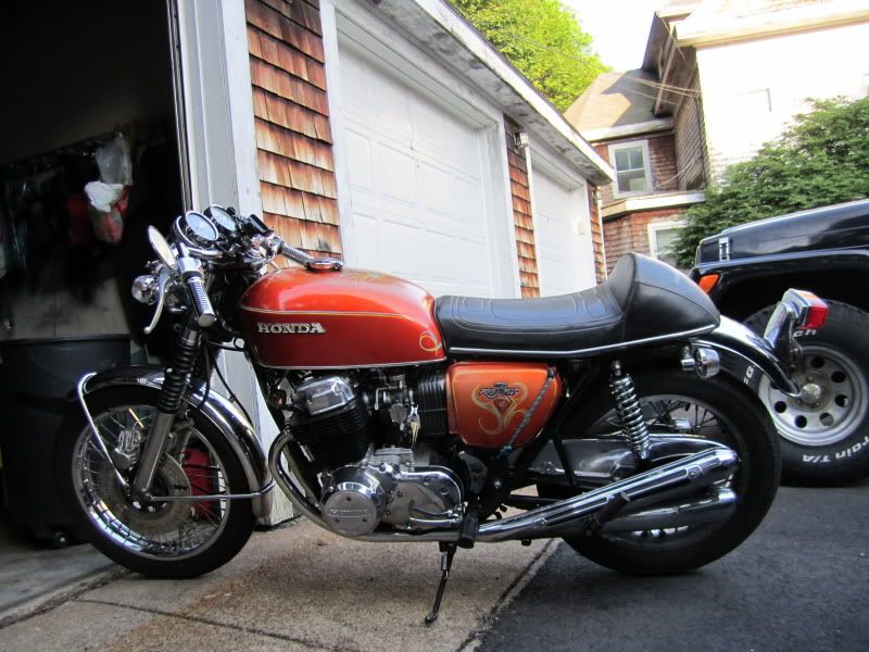

Here are the new Hagons installed:
No problem with chain guard clearance
10 click Adjustable dampening
On the bike - sits a little taller.
Initial impressions from 3 mile ride on bumpy Boston roads - HUGE improvement!!! Firm, crisp handling. Need to play with the settings but much better than what I had.
Will update after more serious miles. Thanks also to Voxonda and others for some good info when I was debating which shock to buy.
cheers
Andy

Hey Andy, I was looking into Hagon shocks for my 750 and was wondering the length of the 2810 shocks you chose. I emailed Dave Quinn and they have some type A road shocks in 14.2" which I feel might be too long. I also like the extra adjustable damping on the 2810's. Also how do you like those compared to the progressives on your k4? Thanks
  • Posts: 8,041
Re: Hagon 2810 shocks for CB750
« Reply #5 on: August 07, 2011, 11:25:15 PM »
The lengths are the same as stocks. The springs are a bit stiff but I like them so far. The progressives on the other hand with the heavy springs have always felt too soft to me but they do a decent enough job of absorbing bumps.
So not enough miles on the Hagons yet to say for sure but so far like them fine. Feels much more stable and planted than the 82 CB750 shocks I had on before. You notice a huge difference straight away!

Tree - good to hear from you! I am planning on sending the springs back as they were too harsh for me - waiting for the riding to decrease first though! So Ill likely have a more accurate report with new springs. However, I think for the money Id get the regular Hagons - not sure the adjustable dampening is doing much.
Andy

Hi Andy, the stiffer springs will effect how the dampening works. When you have better rate springs you should be able to "feel" the difference in the dampening rates.... I was going to explain how the dampening works but i am sure you already know.... ;)
  • Posts: 8,041
« Reply #9 on: October 17, 2011, 04:51:02 AM »
Well thats what I was hoping Retro so Ill update this thread once I have the new springs.

Updates: I found the 2810s with 26kg springs a little too stiff for my road racer K2 even with changing the dampening and spring preload (and having one spring change already). Great for firm race-track style handling but a little firm for the bumpy New England roads. That was with the tomesseli bars. However after knee surgery this year I changed the bars for Euro bars to make the bike a little more comfortable and it has changed the ride for me. I now sit a little further back so more load on the rear shocks and this has helped. I was going to try the Ikons based on others reports, but will stick with the 2810s for now. Not a ringing endorsement I know but overall satisfied rather than blown away.
You should also read forum member Nic impressions of the Hagon 2810 - he didnt like them and ended up going for the Ikons.
