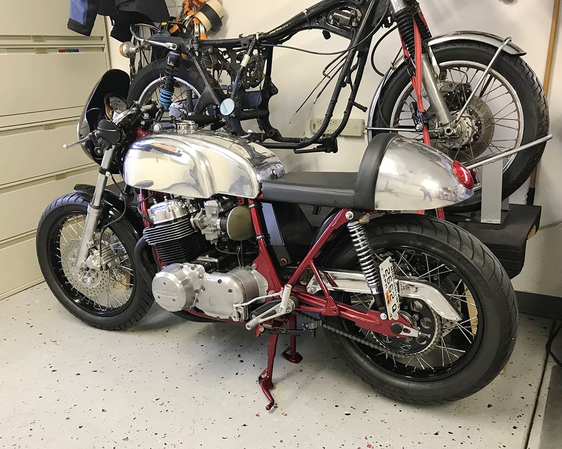

Just to put an exclamation point on this very old build thread, I just finished adding PD42B carbs yesterday and went for a quick 5 mile ride. (38º) It felt really good even with just bench synced carbs. We'll see how close I am with the jets, I started with 42/130 as this is a ported 836 motor. Carb sync is next though.
Here is how it sits today
And last fall with the round tops on
« Last Edit: February 01, 2018, 05:15:32 PM by sixthwisconsin »

Very nice.  Why the carb change?
Offline sixthwisconsin
  • Posts: 553
Re: 1975 750f
« Reply #96 on: February 02, 2018, 08:52:38 AM »
How U lik'n that air filter?
I think the TinTop filter is a very nice design. I was able to get the larger intake boots to fit the PD carbs thankfully. Its not the prettiest one out there but I think its a good performer.
The round tops simply would not work with the Manx tank and I did not want to modify it. It was either PD's or go with something for real performance like RS34's.

Hey Jeff,
What do you think of that filter?
I really love your builds and value your input.
I tend to look at performance over looks but that is just me. I think TinTop built a really good performing intake system. I replaced my TinTop 550 intake because it did not fit with the 550 side covers. That was a purely functional and visual decision but I realize you have to draw the line somewhere between a street bike and a track bike. The 750 intake is a beautiful system from TinTop and I think it will find its way to the track if it has not already.
