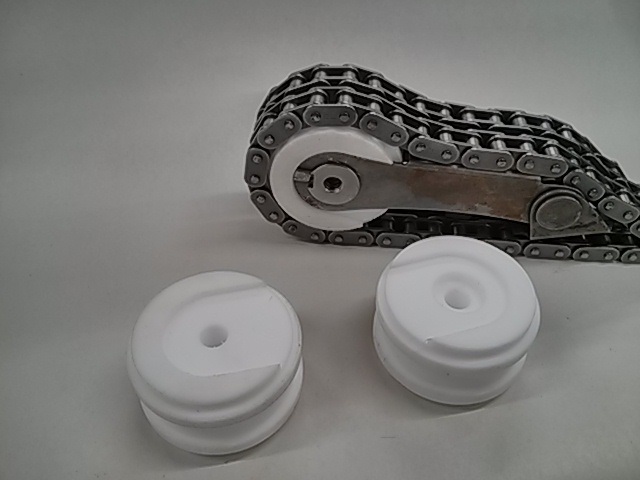

Primary chain tensioners: Go with stock NOS (can be found), or get the new Cyclex piece with its heat resistant material?  They're both the same price, and the Honda parts have been proven to deteriorate over time.  Has anyone heard anything about the Cyclex piece?
"Introducing remanufactured OEM tensioners with our special material for the wheels unaffected by heat and will never wear. This is the same material used on our cam chain tensioners and manual primary chain tensioners. Guaranteed for life."
