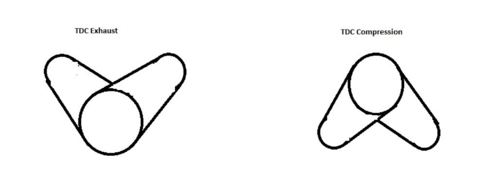

Here is a pic of what I have. Coils and plugs are all correct. So at this point all physically wiring, connections, and static timing are correct. Cam is set correctly and I checked the pistons through the spark plug hole, they are at TDC when the advance unit is at the 1.4 Mark. Still it doesnt want to start.
So now that I have verified everything is stock and correct... now what? Weak spark? Carb problems?
Offline scottly
