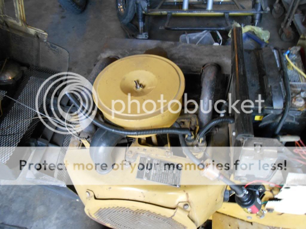

  The mower has an 18 hp Onan engine , it was always  an overpowered tractor, and that's what I liked about it. It's been sitting for a year or two,and I decided to fire it up.
  Cleaned the fuel line, the tank , and did a stellar job cleaning the carb, new fuel filter but the vacuum fuel pump looked a little beat . Installed new battery changed the oil and fired it up. Ran it around the yard a few times and naturally it quits at the farthest point from the barn. Boy is that thing heavy . Pushed it in the  shop where it starts right up  again... take it out to the yard and it quits ...checked my work and changed the air fuel mix till it sounded better tried it again...did this a few times ( not too bright , but determined). Took it to a lawnmower shop. Sorry bud ,can't get parts for this anymore but I adjusted the points and cleaned the fuel system out... I put in last season's gas .
 So he thinks the pump could be worn, so I can't find a carb overhaul kit anywhere. No shop manuals ...SOL. Can't give this up just yet.
 Bought a Mr Gasket 2-3 lbs fuel pump, installed it in line, thought it would help that tired old pump draw from a low mounted tank. Naaaaaaa didn't work at first, then it drowned  the manifold in fuel, works too good.
   Does anyone out there know these motors? Can anyone suggest a decent single venturi carb that I can purchase , even if I have to machine a new intake manifold adapter that would be fine. It only has to feed 2 cylinders. It's a top mount carb not sideways like other mowers. I was toying with the idea of a  8n carb . or something off a little simple 4banger without today's electronics. any suggestions anyone?

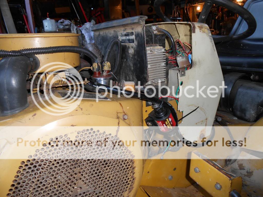

I thought that I might have another wack at this stock engine before getting drastic. I already bought all the materials for  new custom manifolds, gasket materials and rubber carb to manifold connectors and have a sqweeky clean set of carbs from a 72 cb 450 twin.

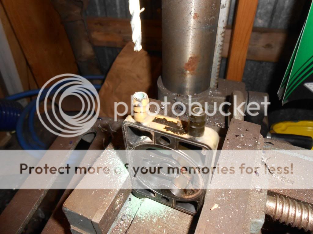

 but I was curious about a n overflow return line,so. I drilled out the upper hole that was not used in the pump area of the carb.

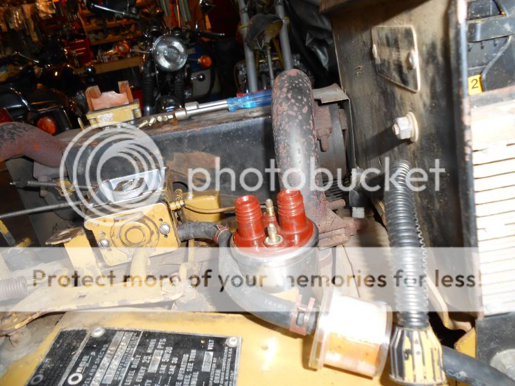

 The coil was questionable so I changed it out to a chrome one that I wasn't using from one of the choppers that I picked up.
Installed a return line into the tank
  And it fired right up,Cut the lawn with zero problems. This tractor has balls to the walls, I can ride the  back wheels for a while with a quick start in 3rd,which is always fun but doesn't get the grass cut.
