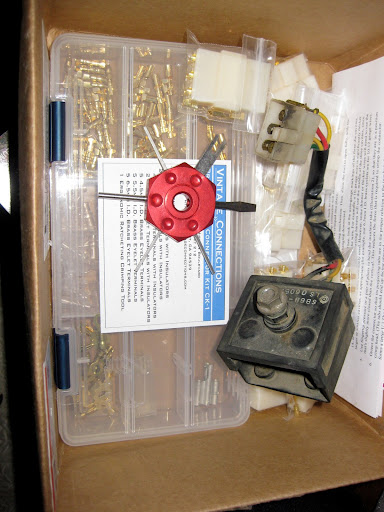

That guy (Oregon Motorcycles) also sells connectors like Del from Vintage Connections.  I've read about a lot of folks that have been happy with that combination but let me point a few things out and maybe I can get a little help from some of our better versed folks.
Some thoughts on the Oregon unit:
  • Some folks on this forum have used them and love them.
  • The price is about 120 bucks
  • Combo unit - both regulator and rectifier combined
  • I hear the guy at Oregon is great to work with and folks here report good post sales support
  • I thought I had read that the Oregon unit is a shunt regulator and has the alternator running at full tilt all the time putting the windings in your alternator (stator) under higher stress (heat) than the factory unit
  • Easy!!! plug it in, screw it down and "play"
What do you need to mount it to?  Do you have the factory battery box and "electrical panel"?
I think a solid state regulator is easily cooked if not connected properly.  (don't ask :)... I've burned up parts "on the bench").  I understand you want plug and play and for that reason, you may want to do the Oregon unit.  I feel like there are at least 2 other good options.  #1 - Try to use your factory parts - especially the regulator.  If you need to test them, you'll get plenty of help here.  #2 - Roll your own.  Whether you use a Ford regulator or the factory regulator, it's easy and cheap ($20 complete with new connectors) to build a more robust rectifier than the factory unit.
You (FrankenStuff) and I have other things to chat about.  Let's put this on the agenda ;)
