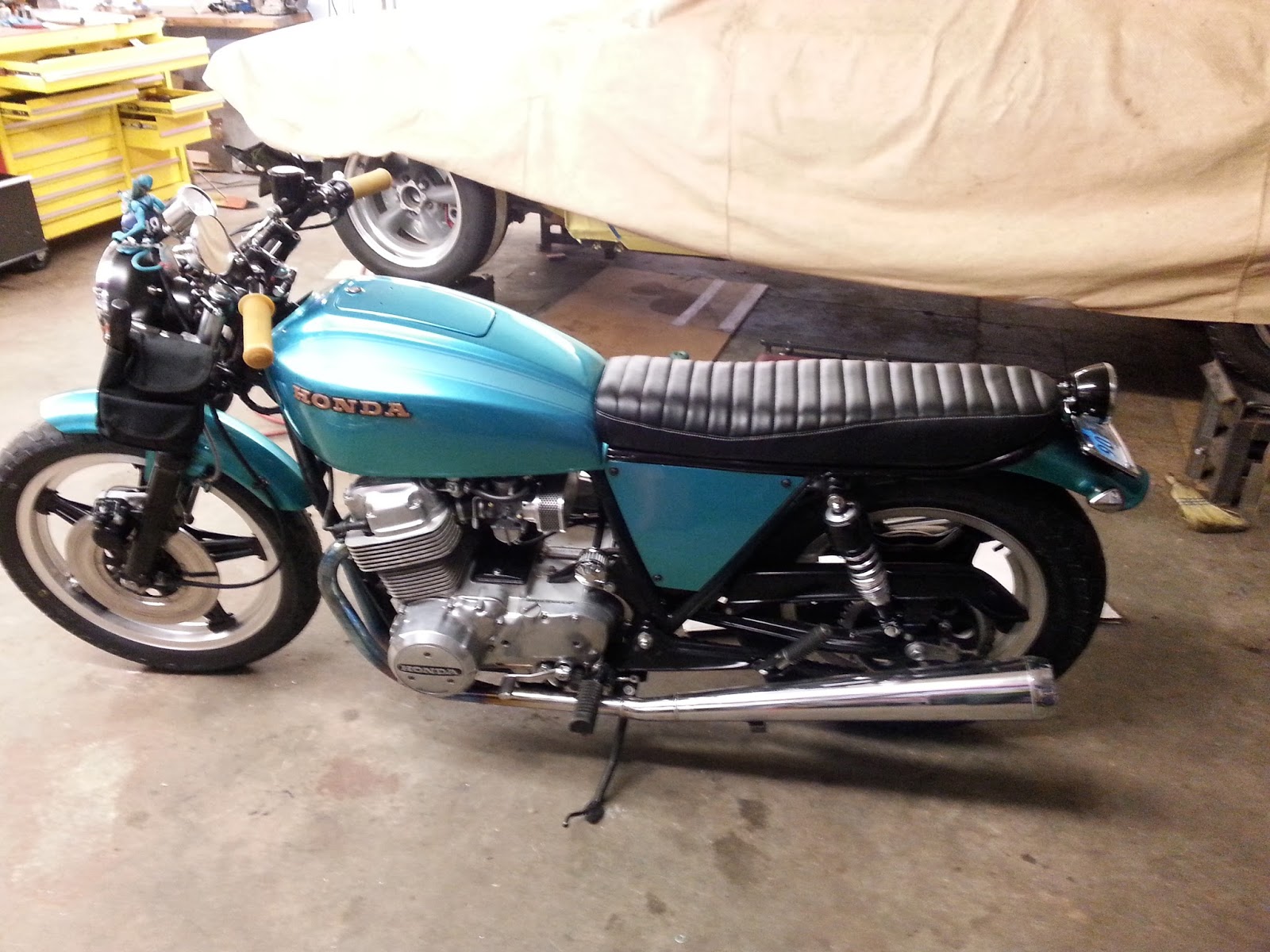

Here's what work I did in case anyone wants to know. This is a 1978 CB750A
- Bridgestone Spitfire Tires 100/90/19 on the front / 130/90/17 on the rear
- Painted comstar rim centers black.
- Painted front fork lowers black.
- Shortened front front springs to lower the bike 1.5" (as per instructions on Honda Chopper)
- Installed black super bike bars
- Eliminated handlebar switches (Left side - turn signal toggle switch. Right master cylinder and throttle)
- Cycle X ignition key switch (eliminates start button and bike starts like a car)
- Custom ignition key / speedometer bracket
- Baja Designs mini speedo
- Stainless steel front brake line
- CB750cafe diamond turn signals
- Eliminated all gauges including fuel level and associated electronics (relays,etc) to make it work.
- Removed change switch
- Retrofitted ATC blade style fusebox
- Custom made side covers with paisley decals I had made
- New points & Hondaman ignition
- Swapped in 1974 CB750K camshaft and 657A "roundtop" carbs (main jets at 115)
- Steel Dragon Performance dual velocity stack airboxes
- Totally redid wiring harness while eliminating unneeded wires
- 12 volt DC socket in lower headlight bucket
- Rebuilt swingarm with bronze bushings and steering head with taper bearings
- New wheel bearings
- Custom made my own seat pan (upholstered by Eddie Barrett Seats in Durham,CT)
- Bobbed rear fender and added Low Brow Customs tail light / license plate bracket for the CB750
- Cut and added frame loop on the rear section
- Progressive style 11.5" rear shocks

Nice looking bike.  The wheels look very good - better than I imagined it would.  Nice, nice work!

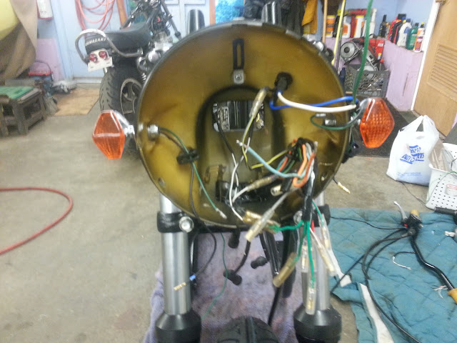

Here's the socket. I mounted it inside the rectangular cutout on the headlight bucket. I also did a lot of wiring elimination and changed all connections in the headlight to male/female bullet connectors. You may have a hard time fitting a 12v socket space wise if you have those big white block connectors. I don't.
Here it is mounted.
If you see inside the bucket, I slide the socket over to the left edge of the cutout and used washers to take up the space around the socket. This was it before I installed it.
