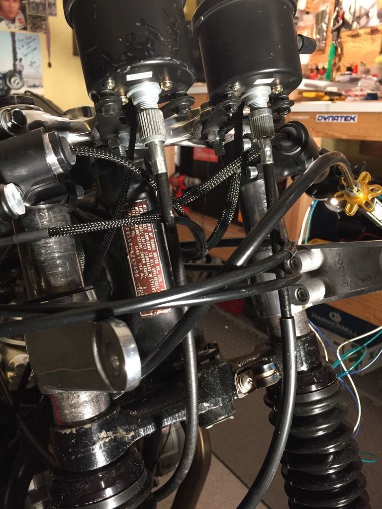

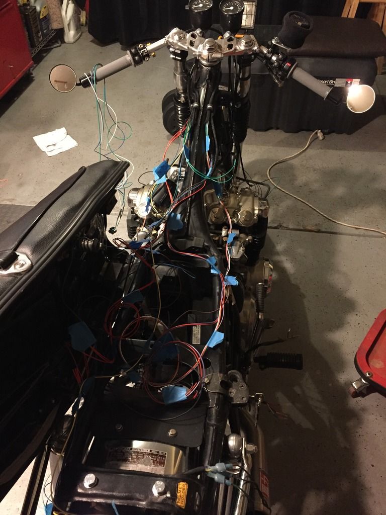

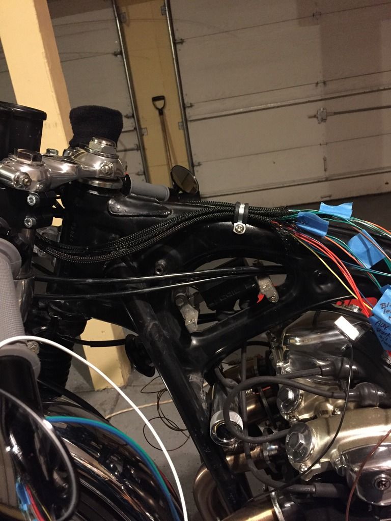

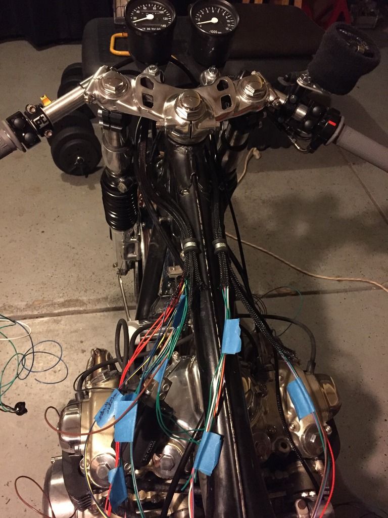

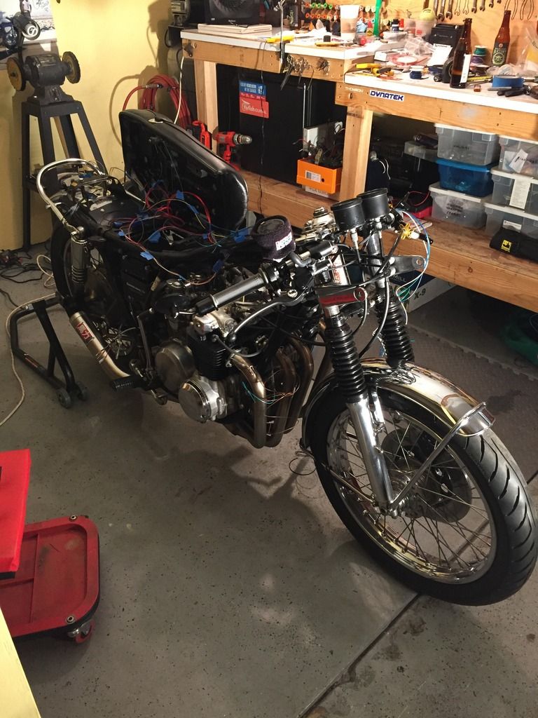

Here's where things are as of Friday night when I realized I needed more wire in a few colors. Should be here Wednesday or Thursday but it'll be Friday before I can do anything with it. Should have the front end done by next weekend though.

Got a nice seat on that electrical explosion of wires.
looks like you didn't skimp on the green wire from the coils of it lying about. Sincne it is a ground would it make sense to run a large "backbone" ground rail to tie all those grounds coming from various areas on controls and other components where needed and tie that ground rail into a couple good points on the frame and ultimately the battery?
Ground is ground on most circuits unless you are pulling a relay remotely and sending many amps to a component you only need sufficient ground wires from a circuit to a good ground for the bike. Looks like you might be running ground wires back to Munit.
I see at least 2 or 3 green wire runs.
Controls and handle bars and their paraphenalia ?sp? Look great.
David

« Reply #1304 on: January 22, 2017, 12:02:45 PM »
The majority of those green wires you see on the left side there are 5 that come off the tach. But from up front I think I probably have 13 or so ground wires in all. Once I have them all routed they will split on each side of the backbone and come together in one ring terminal on each side and then ground at the frame (underneath each P clamp). The reason it looks a mess right now is because I had to order black, brown, and red wire in 22awg to finish extending the wires for the M Lock and the tach and speedo. Once that's done, I can end the sleeving for all the 7 or so looms I have now, deal with the grounds, then create more condensed looms (sleeving and heat shrink) and continue on to the M Unit.

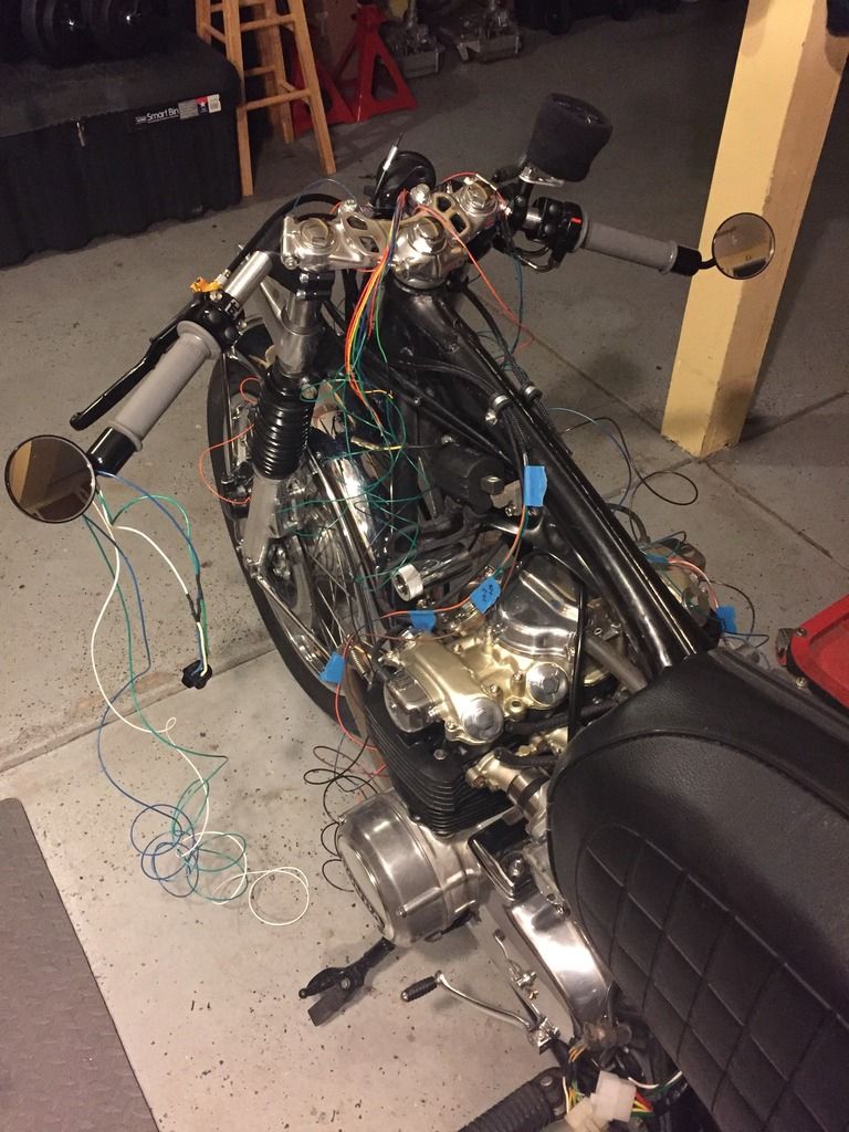

Got to work on things a bit tonight but I really thought I was going to get more done. Ran out of sleeving so I'll have to order more and it'll be next weekend before I can do anything else. Got the gauges all wired up and routed, one of the coils (although I used 18awg and may switch to 22 just to keep things tidy), the M Lock, and the horn re-wired in a loom with the M Lock. Soon as I get more sleeving I'll be able to install the headlight bucket, get the headlight wires and both turn signals in a loom and then get everything run down the rest of the backbone and to the M Unit. Here's some pics.

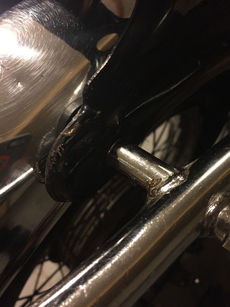

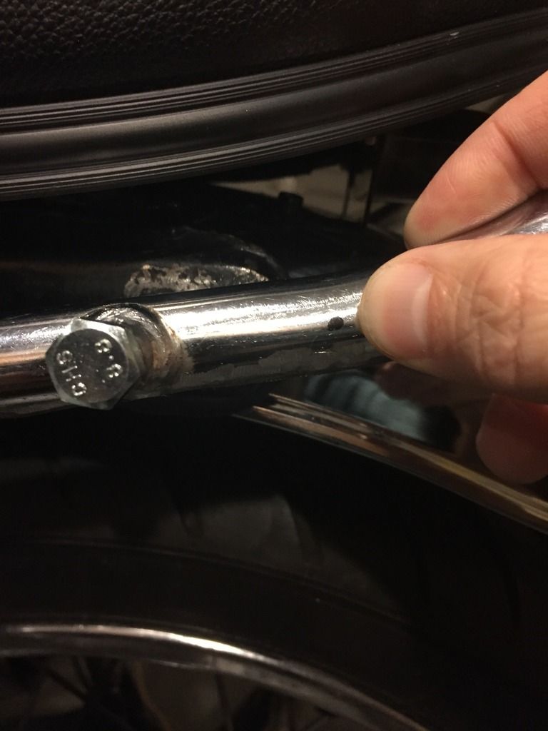

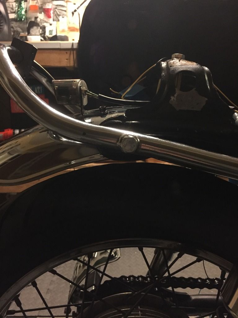

Ok everyone I need some help/ideas. While I'm waiting for more sleeving and wire to get here I decided to revisit where the rear turn signals will mount. Originally I wanted them to mount on the grab bar about 1 1/4" back from the mounting point to where the grab bar mounts to the frame. The plan was going to be to run the wires internally forward, out a small hole and then along the frame. I was going to drill a larger hole on the inside of the grab bar so that the mounting nut would be hidden inside but the hole size required to get the nut inside the grab bar is too big and will weaken the grab bar too much. The threads on the turn signal are not long enough to go through the bar either.
So now the idea is to make some aluminum tabs to mount underneath where the grab bar mounts to the frame and then mount the turns to this tab. The tabs would need to hang down about an inch below the frame and then I could run the wires up the inside of the frame.
Anyone have any better ideas?
Offline palepainter
  • Posts: 546
    • Mike Learn custom paint and airbrush.
Re: 1976 CB500/550 Project
« Reply #1324 on: January 28, 2017, 08:44:39 PM »
Do you have a photo of the mounting sleeve on the turnsignal?  And is the threaded portion of signal removable.
