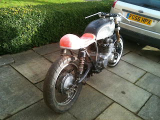

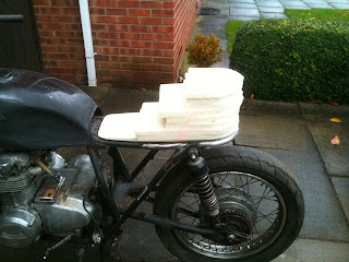

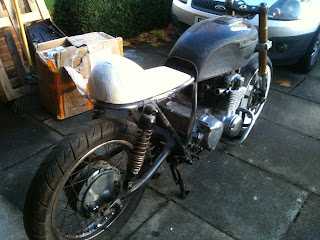

started the seat today, I need it to be big enough for the battery etc
its still looking a bit big & needs rounding off more so more work on it today

Re: time to build another cafe racer now with USD - NOW BUILDING THE SEAT
« Reply #30 on: November 03, 2013, 06:44:46 AM »

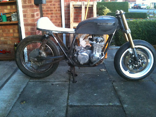

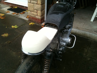

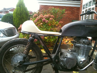

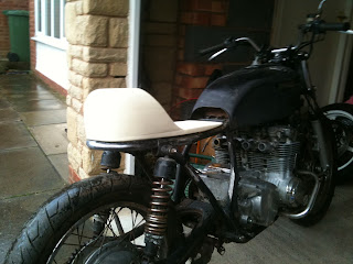

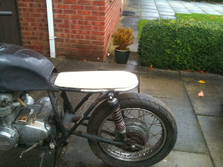

reshaped the set this morning I think its looking better now its more rounded please let me know what you think
will fibreglass it in the week
dropped the forks off & trial fitted the GSXR front end I think its starting to get there
keep you posted Andy
« Reply #31 on: November 03, 2013, 06:56:14 AM »
Just my $0.02.  I think it needs to lose a little more height.
Offline Godffery
  • Godffery's Garage
  • Posts: 1,174
« Reply #32 on: November 03, 2013, 07:01:42 AM »
I have to agree; a little lees bum would be good.  = ]
  • Posts: 29,050
« Reply #33 on: November 03, 2013, 08:23:01 AM »
 I think 3 inches longer would look nice.. Longer hoop too..
« Reply #34 on: November 03, 2013, 08:38:16 AM »
Yes, longer would help allot also.
« Reply #35 on: November 03, 2013, 12:48:41 PM »
thanks for the input guys
I will take an inch off the height & line the back seat pad slope up with the diagonal frame tube so it carries the angle through & mimic the back end of the tank for the curve
keep you posted thanks for the ideas Andy

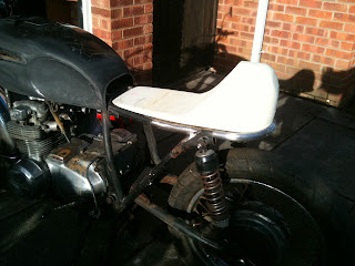

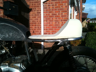

hi all quick update I am working on reshaping the seat

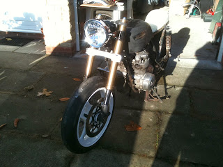

fitted the headlight today be good to hear any opinions
cheers Andy
  • Posts: 29,050
Draw it in as close to the neck as possible, and very close to lower tree..jmo.. Makes it look like part of the fork, rather than added on ..
And if you paint it color of tank, the bike will look better to the eye from the side, ie the color tapers off a bit, vs looking cut off at the forks. Bezel could be chrome or paint..again , just my opinion...
Offline Sharpy
  • Posts: 32
I am with 754, needs to be set back more, if you can do that I think it will spot on.  :D
Offline Godffery
  • Godffery's Garage
  • Posts: 1,174
It might might not look as far forward when the gauges are on?
  • Posts: 29,050
If its lower the fender tank light will all form a fairly straight line..
Offline ISLAND CAFERACERS
  • Posts: 46
cheers guys I was looking at pulling it back into the forks so thanks for your input
if I redrill the brkts it will pull back 1- 1/2"
thanks for all your help

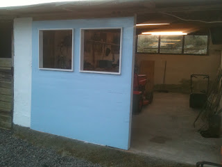

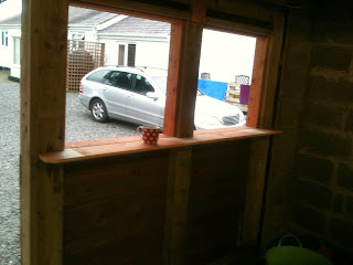

had to put the build on hold for a few weeks while we move to a nice little cottage with land & more important some decent size outbuildings to turn into 4 workshops!!
its on the island of Anglesey off the coast of Wales in the UK

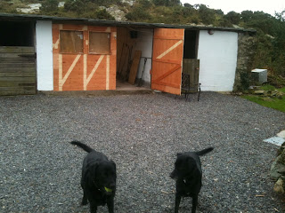

1st job put a front onto the old stable with windows & a decent wide stabledoor
I used the old planks from the original doors should look right when painted
here is a view from inside its a decent size & when kitted out with a log burner a snug workshop
looking better with a couple of coats of paint

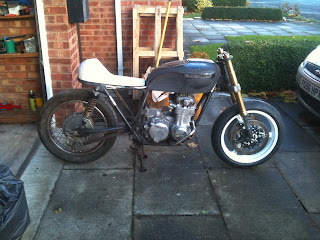

and heres the project sitting better now with bars fitted I will post a few more images in the week
