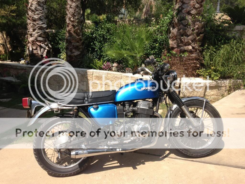

Here are some of the photos form the seller. They might shed some light on this bike.
The seat is a NOS replacement that the PO had just put on.
  • Posts: 35,315
Re: Restoring a '75 750K - Lots of questions.
« Reply #12 on: October 30, 2013, 07:17:11 PM »
Its a K5, maybe the tank was changed?  Very common.

Fuel petcock on your bike is on the right side. My '75 cb750 has it on the left.
Front turn signals don't match the rear. (Different size/year)
Front turn signals are mounted in a new position, leaving an empty bolt hole on the ear.

They had the tank on reserve also  :D  If you change out the side cover emblems from red to orange someday make sure the wings are pointed in the correct position,see one is backwards. Did you ever say how many miles the odometer has on it ?

If you are making a list.
I believe the gauges are earlier than 1975-- if this is true, you really don't know the mileage. This makes a mechanical shake down even more important.
Baffles are missing from your exhaust pipes. If the pipes are intact (not rusting), take care of them.
Look under the tank for the original ignition switch bracket. The switch was originally mounted on the frame below the tank.
We do love the nit-picking.
