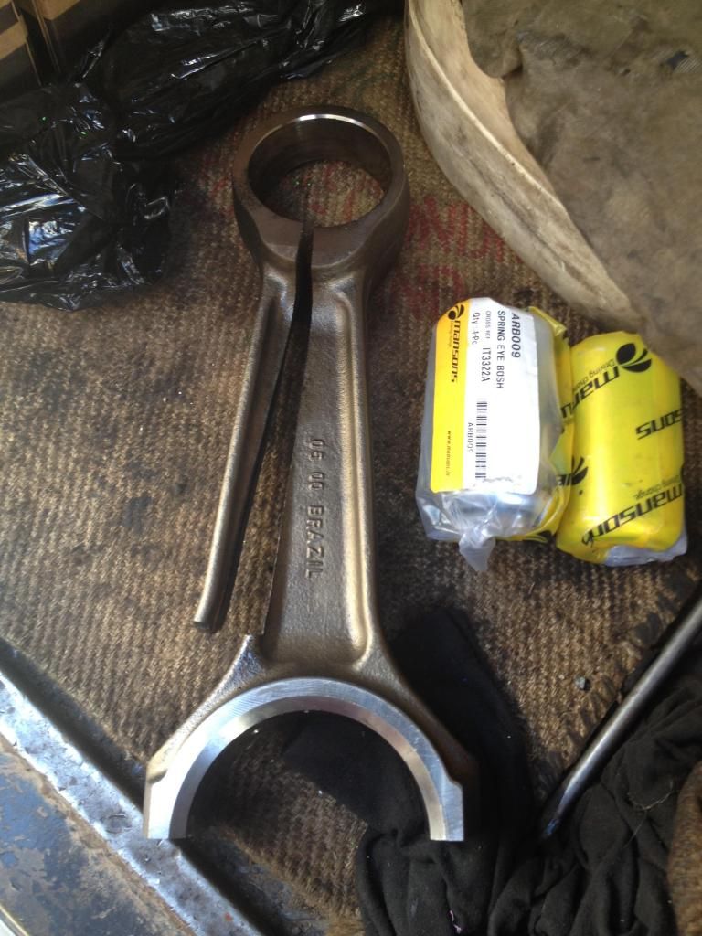

We had this come into work today, it is out of an N14 Cummins.  The fella who brought it in is a local mobile mechanic.  It has cracked along the oiling hole drilling.  Apparently it had a bit of a knock in the engine, I dunno why   ::) ::)

Must of been a defective casting,was it an Original part under warranty ?

made in brazil.

Looks like it hammered.  The flange is all the strength against bending in a beam.  They drilled an oil hole through it at the one end, dramatically weakening it.  Look closely, you can see slight bending there.  Just like bending a rod, it bent there, cracked like a casting, then cracked along the weakest point in the structure.  Wish I could take a better look at it.  Would be able to tell if it was a fatigue failure or got hammered.

If all that did was 'knock', I'd say he was lucky!

It destroyed a liner, piston and put a small hole in the block, all of which are repairable.  But yes he was bloody lucky ;D
That bend at the bottom of the cracked off piece was caused by it hitting the liner, when the piston started getting pulled down the conrod opened up and smacked the liner.

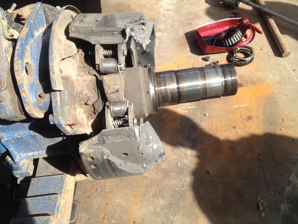

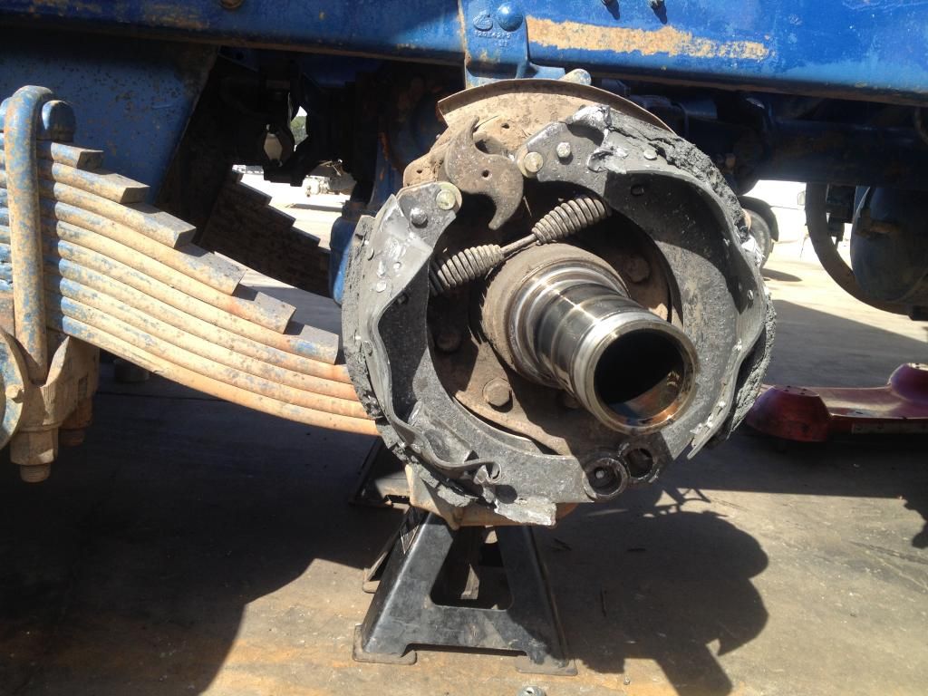

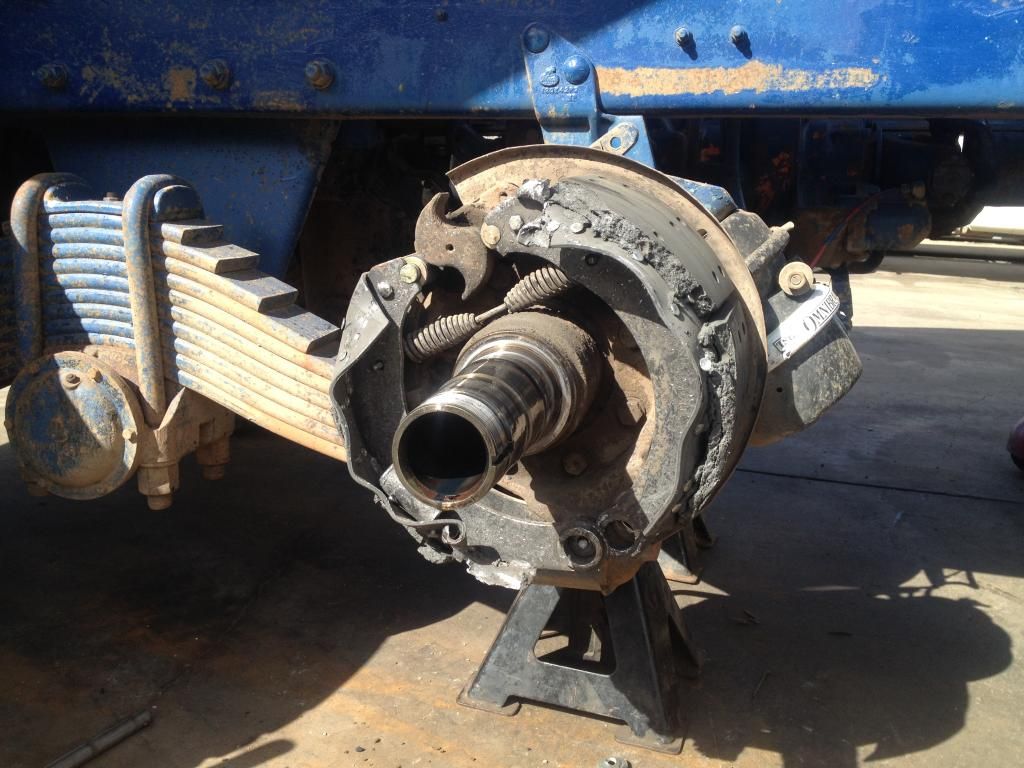

We had this come into work a couple of weeks ago.  This is the result of someone going for the cheapest price on a brake job, the numb skull who did the job fitted the wrong S cam bushes, didn't also fit any seals on the S cam, which had he used the correct bushes they were part of the bush.  He also didn't believe in tightening anchor pin bolts, which is what came loose and did a few trips around the hub, and eventually punched a hole in the side of the drum. Needless to say the owner of the truck was not impressed in the slightest. ;D
