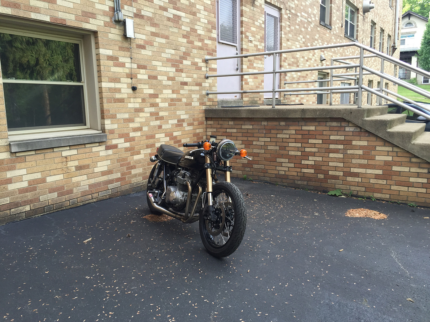

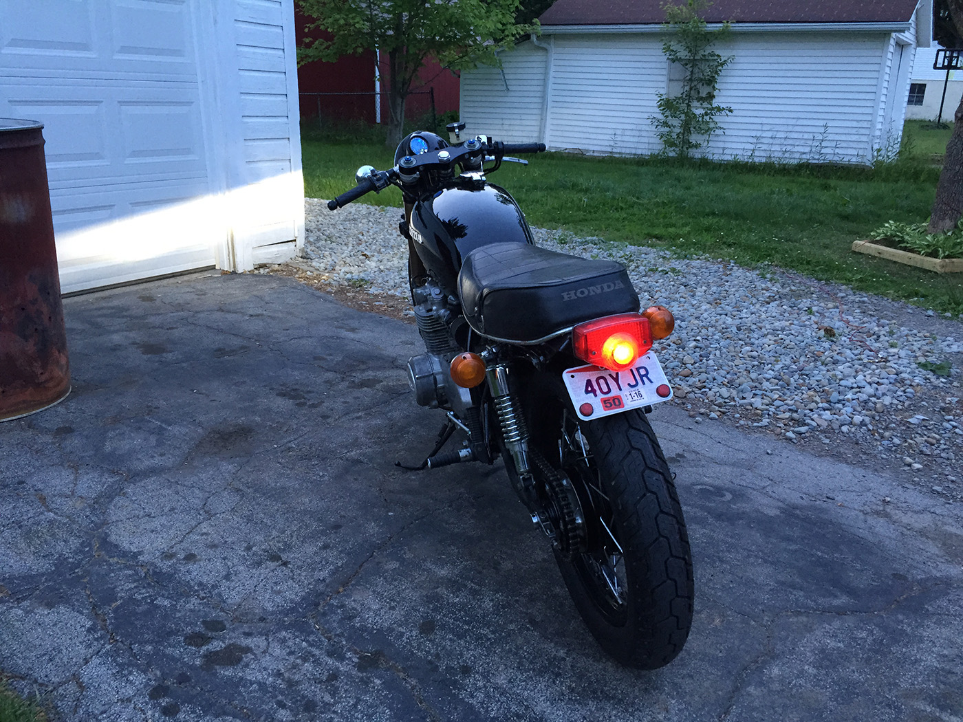

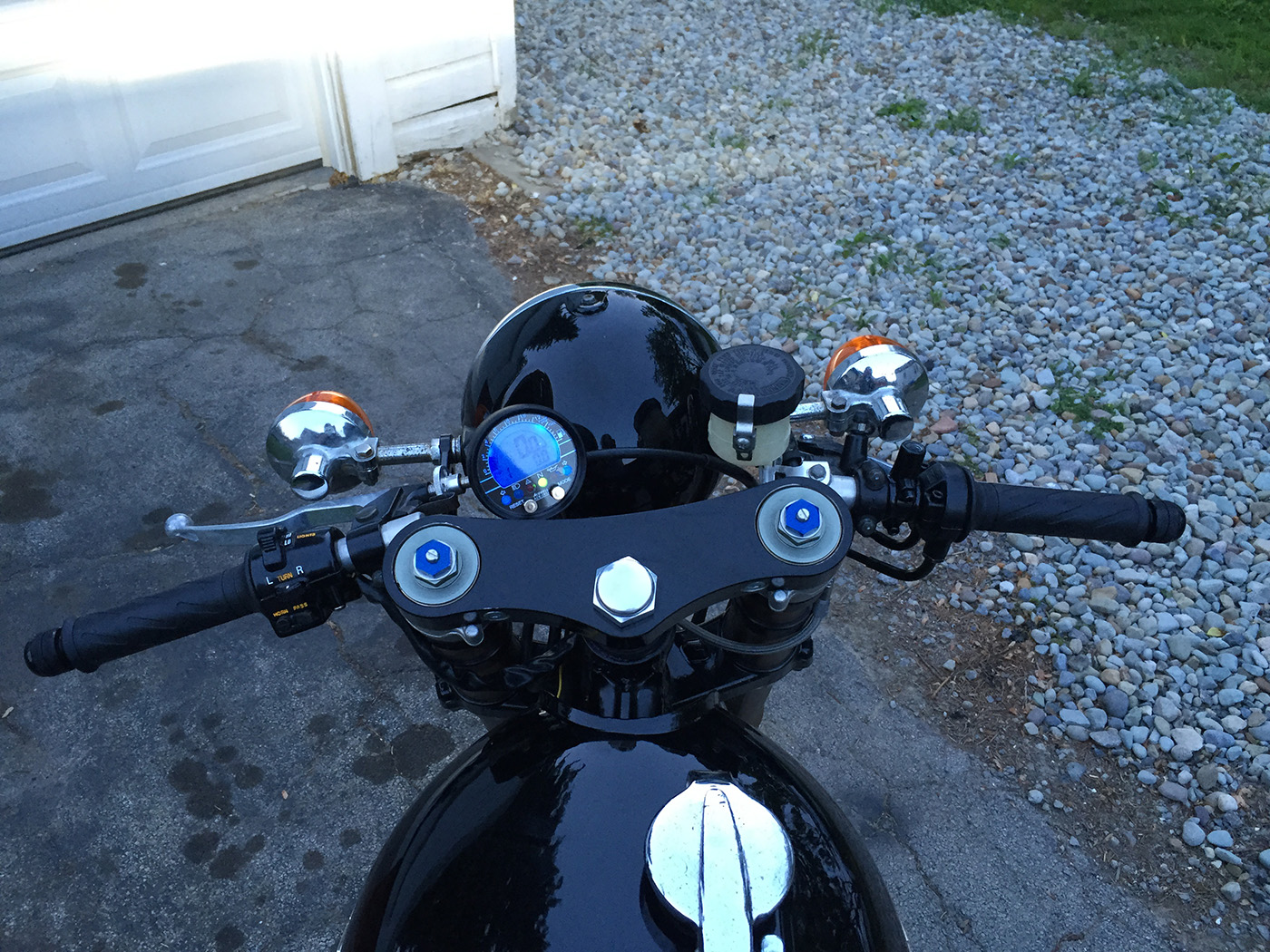

Going great! First ride was last week. She started right up with one kick after sitting all winter. Had to make some adjustments on the length of the rearset bar, as I was having a hard time downshifting.
More todos:
- Figure out kickstart lever. Slightly hits my rearset arm. Probably going to fab something up.
- Find a new left hand control that has everything on it. Not having a light on-off switch is bugging me, and I think this switch is actually defective. The "pass" button for triggering the high beam randomly works, and the horn button is not working. Checked the wiring a ton of times.
- Shorten rear brake lever. It's too long with the rearsets.
Some pics:
« Last Edit: December 20, 2022, 04:43:15 PM by nicks2319 »

Kick start lever: I had to shorten my arm about 1"" so that it clears my rear set peg. Might look at that as a solution.
That handlebar control is not going to allow a headlight "defeat" switch. The light is powered automatically the way that switch is wired, and you'll be hard pressed to disable it without changing to a 3 position switch (Off, Lo, Hi)
The "pass" function relies on a relay that you probably didn't wire in.
That switch has the Horn wiring "backwards" from stock Honda. Stock, the horn is powered by Black and the LtGrn sends the ground. Your new switch sends 12v when pressed, so swap the permanent ground wire to the horn, then power comes from the horn button.
Whoa, thanks for the specifics. Makes sense. I'll give this a shot.
