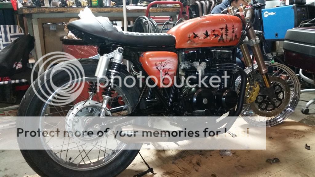

« Reply #1 on: March 21, 2015, 03:34:57 PM »
Pic for attention :)

Hellraiser...I love that paint!  Please tell me you are keeping it.
Offline hellraiserDLX
  • Posts: 171
Re: best final drive for 650 in a 550 with 550 hub (free pictures inside)
« Reply #21 on: March 24, 2015, 06:29:46 AM »
  its staying that way for the riding season While i source a new set ov side covers and a decent tank to have painted. This setup will stay just how it is forever :)
  • Posts: 11,177
« Reply #22 on: March 24, 2015, 04:12:14 PM »
   8) 8) 8) 8)             good to know
