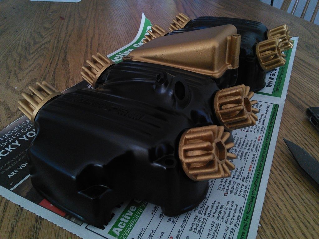

Since I am still waiting for parts I decided to do some touchups
Hopefully it will not look too crazy installed. Really want to go with a polished valve cover in the future, but it is too much work for now.
Jon

Maybe I need to loose some weight, getting the wheel up has never been that easy, less so now (see pic.). I am more likely to spin then lift. I'll rebuild the clutch and see though.
I think the valve cover turned out nice, still need to clean a bunch of stuff up, but it's all working.
