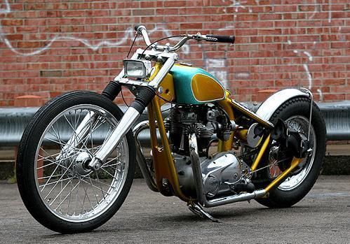

Re: 1970 Honda CB750 Restromod
« Reply #29 on: May 31, 2015, 02:20:58 PM »
Blue turbos bike has the two lower frame rails cut out..like this one..
 I have had one with the rails cut out,toured two up a bit with it.
Had another buddy had a cut one, dragraced it a lot.. Rode it to Sturgis and raced it there..over 1100 miles each.way.. He was riding it at speeds as high as 125 mph on that trip..
