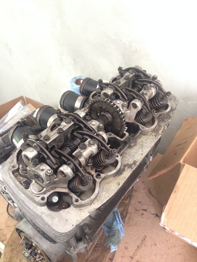

Thanks for the welcome, Mystic. You are right, haste makes waste. I did read Hondaman's recommendation to slide out the rocker arms before loosening the cam bearing caps but got excited and carried away with loosening all the nuts.
Fortunately got around it by improvising a makeshift valve spring compressor and pushing the arms out one at a time, that did the trick and the cam tower came back down and, what do you know, the cam chain loosened up.

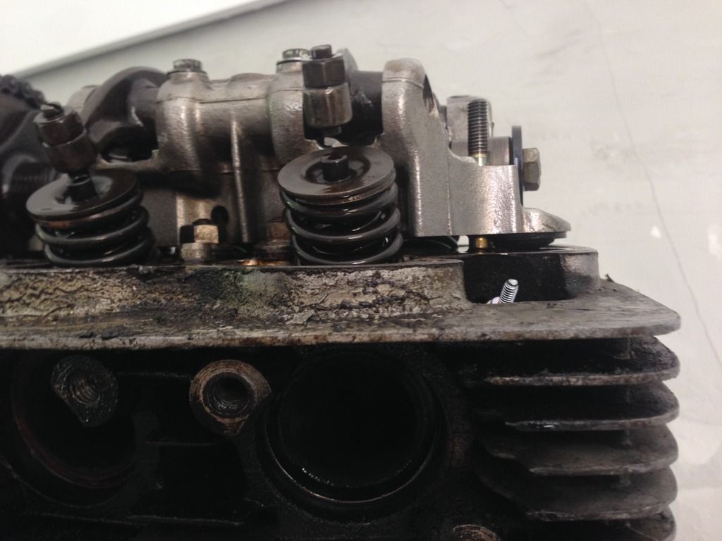

On with the tear down:

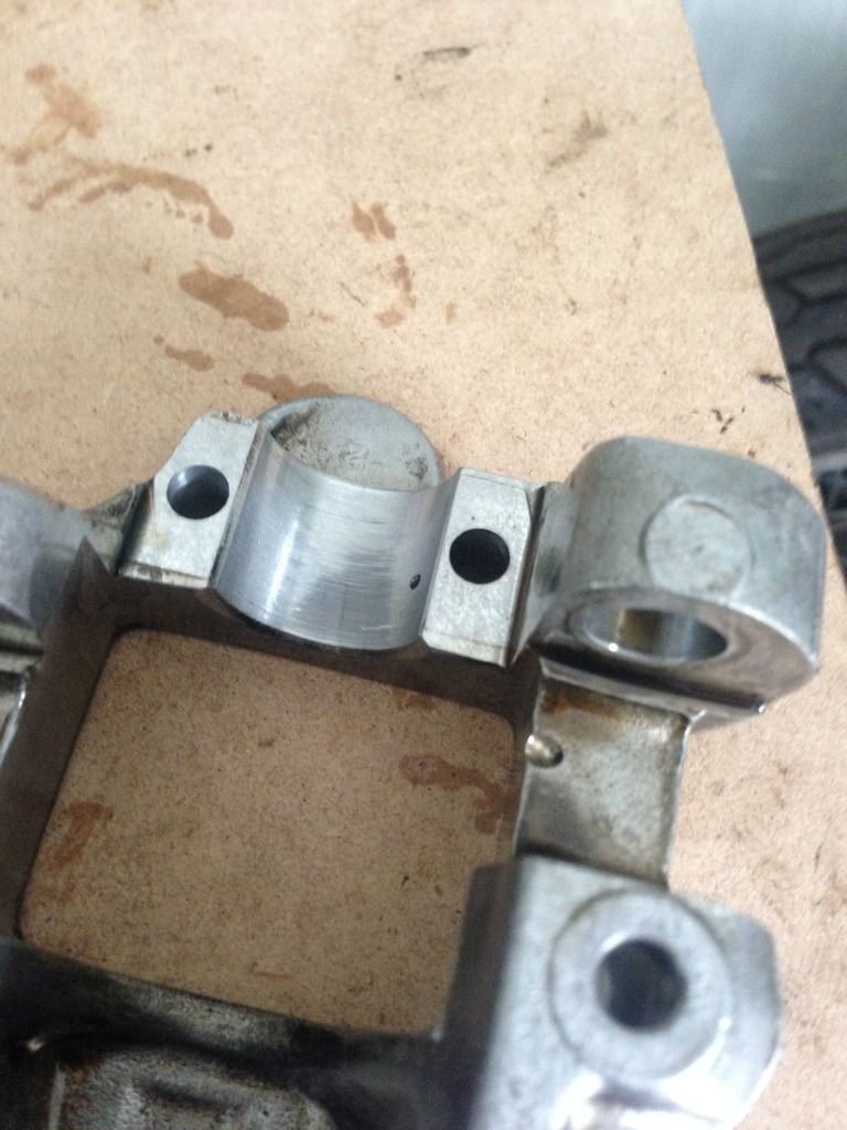

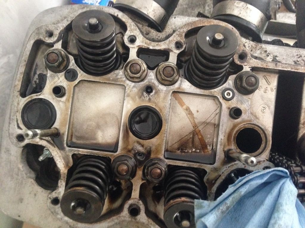

Noticed some wear on the cam tower bearing (bottom):
View of the base of the cam towers, L and R:

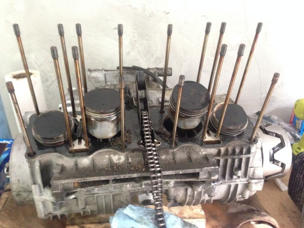

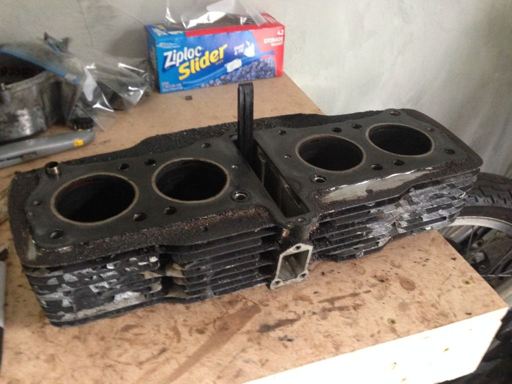

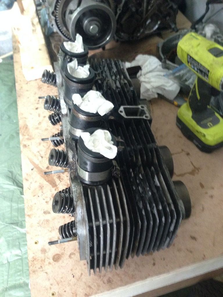

Off came the head and jugs, in two pieces, even after removing all the screws.. is that normal?

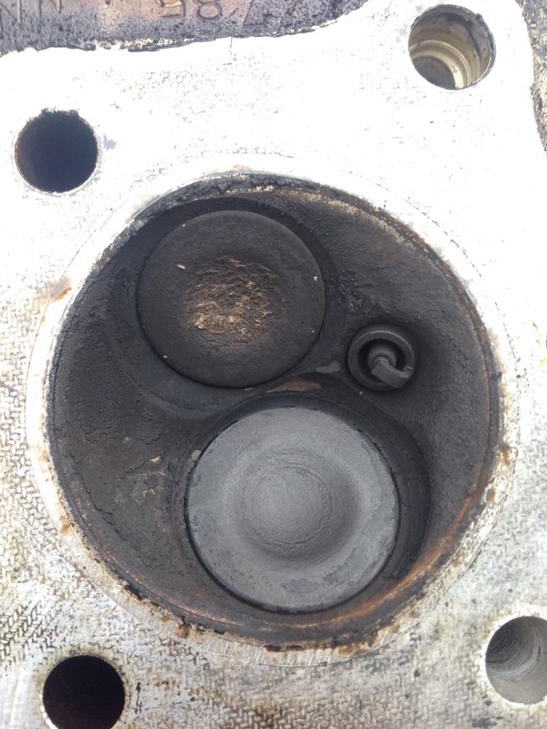

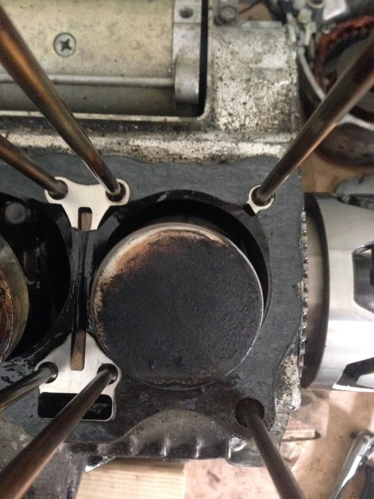

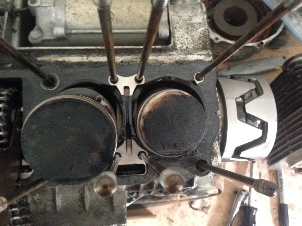

Pistons:
Carbon fouled..

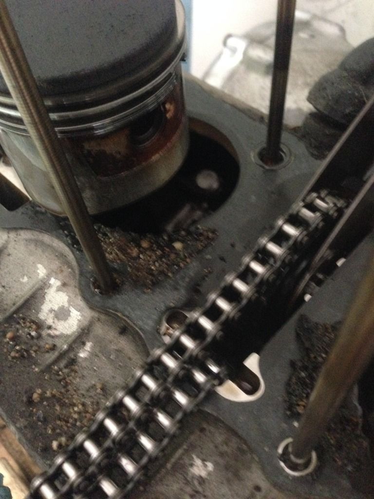

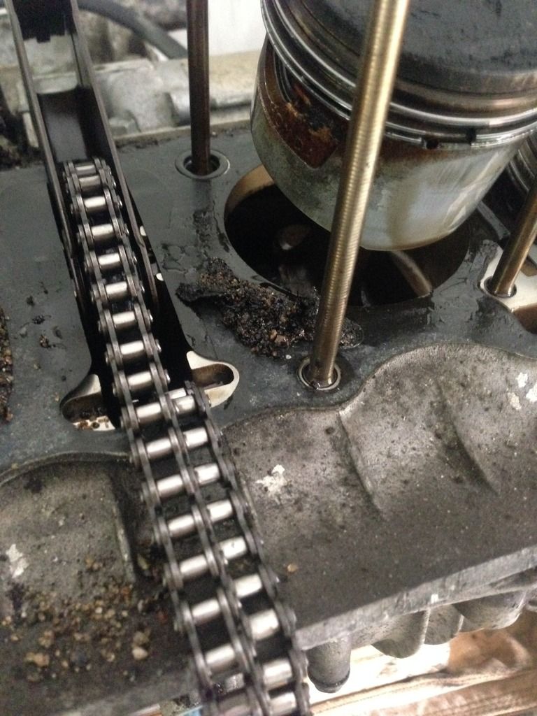

Here's where things get weird. I can't believe that this is the correct gasket, can it? Doesn't look right to me:
This took me by surprise- dirt encrusted inside the jugs, they didn't end up there by accident, was pretty encrusted:
« Last Edit: May 23, 2016, 03:38:09 PM by dumbquestions »

Separated the head from the jugs by inserting wood shims between the fins (carefully) then once a sliver of a crack opened, inserted the shims into the crack and separated the heads. Those fins need a serious cleaning:
Looks like the bike was running too rich?

« Reply #5 on: May 23, 2016, 04:59:35 PM »
I've seen worse  ;D
Should clean up nice.

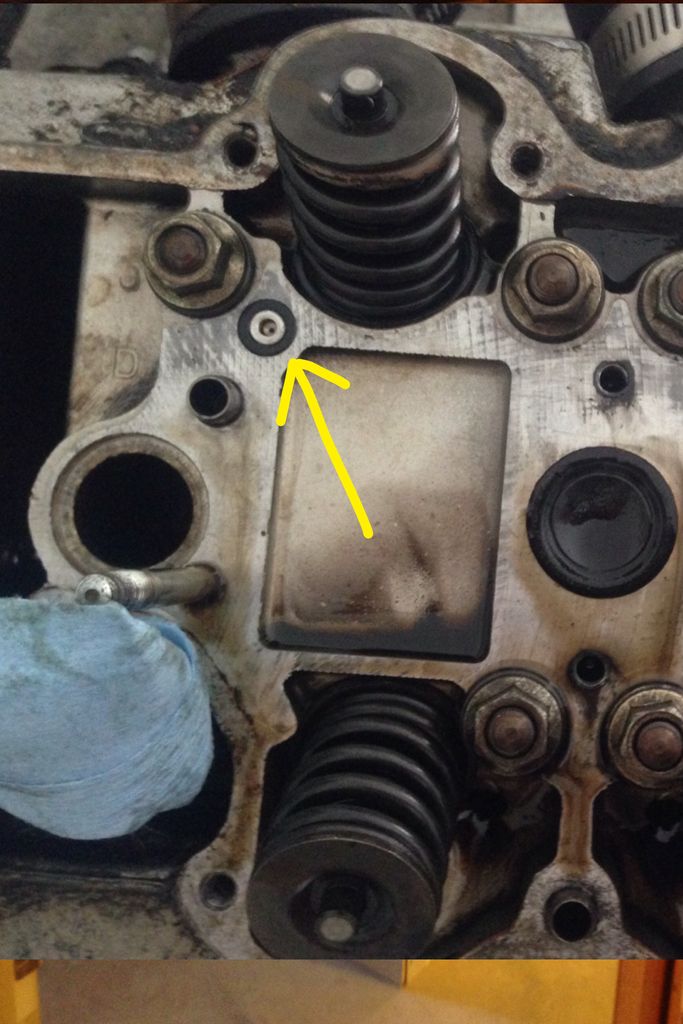

One comment I'll make here, is that in these two pictures, you can see that on either side of the cam chain tunnel, on the intake side, next to the head nuts, you can see two circular aluminum pieces which are pressed into the head.  On one of your pictures there's still an o-ring around it, on the other pics the o-ring is missing.
These are the oil control orifices which control oil flow to the valve train.
Two important items here:
  • Don't loose them!
  • Make sure they aren't clogged.
  • Make sure to reinstall the o-rings around these at re-assembly.  There are matching o-rings that go under the outside corners of the cam towers, to keep things even.
Hmm, that's three things.
  • Clean the oil passages in the cam towers too.
OK, four.

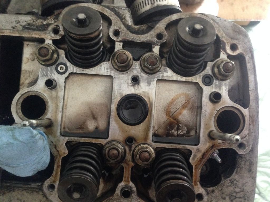

What does the head have engraved ? Possible decking done prior or head work? You can see some writing in the one pic.
1970 Honda CB750 survivor.
Do you mean the orifice that the arrow is pointed to?
Your guess is as good as mine.
Yup!

Any thoughts on the gasket? It seems to be a very poor fit.

Would you or anyone else have a thought re: the gasket on the upper case? It's hard for me to believe that it's the correct one for a K3 engine.

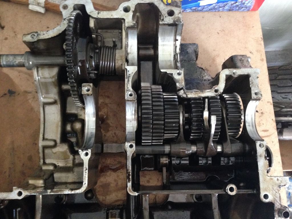

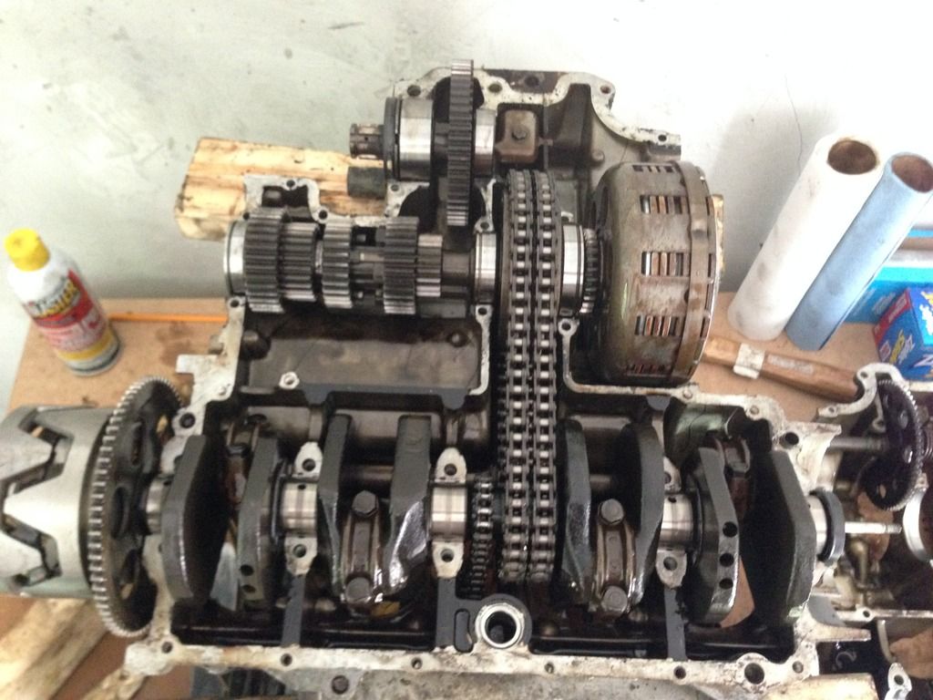

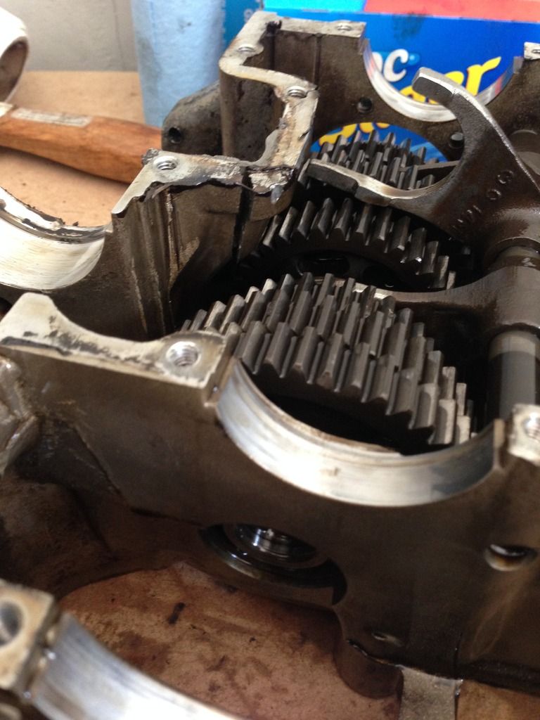

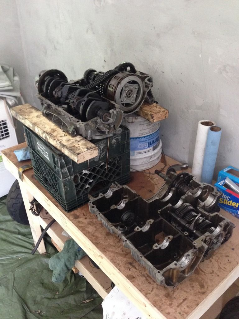

Well today I got the cases split, and I was sweating bullets loosening those bolts. Read too many horror threads on snapped bolts on here, I guess. But all of them came out and after quite a  bit of time carefully working wood splits in every where and tapping it apart, the cases came apart:

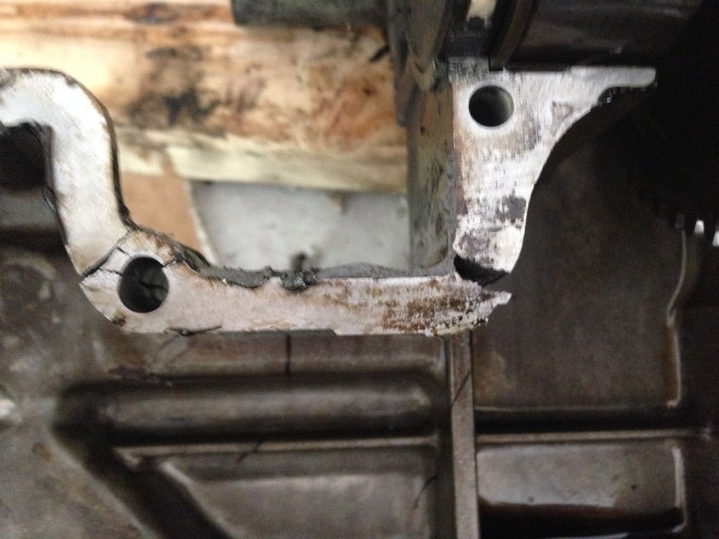

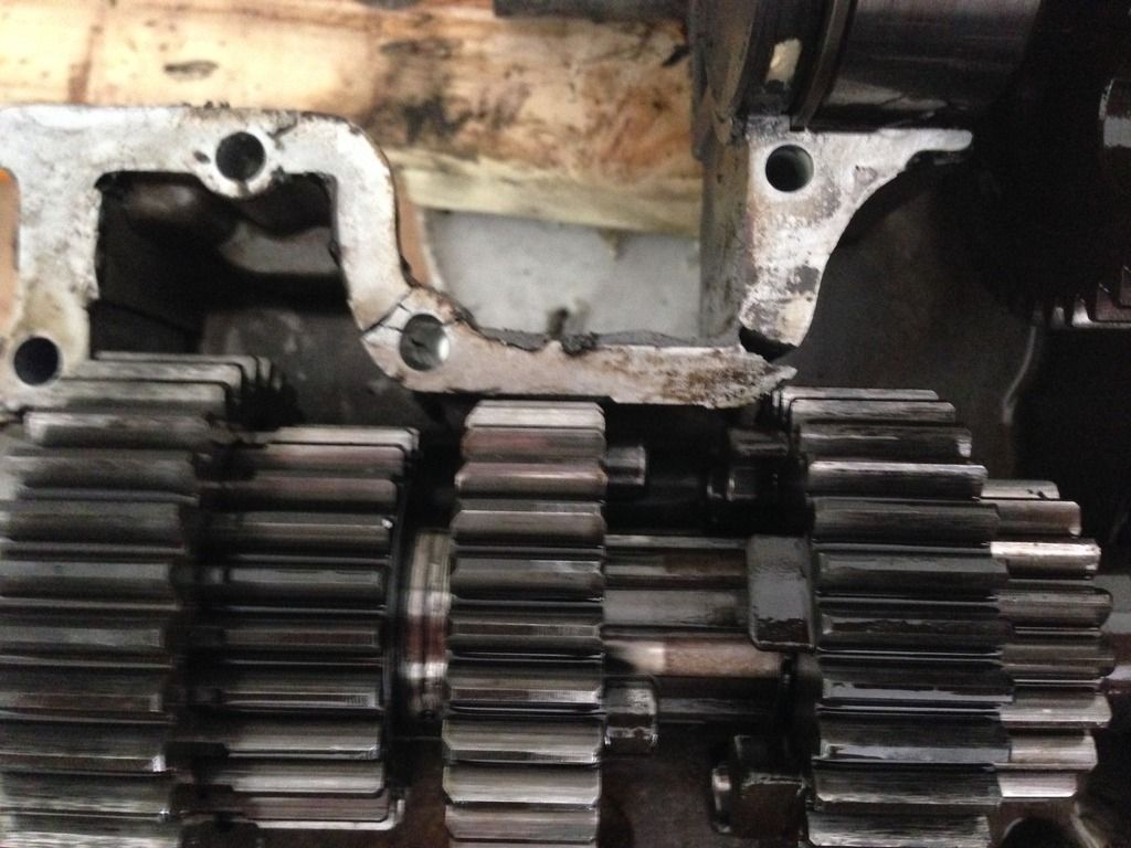

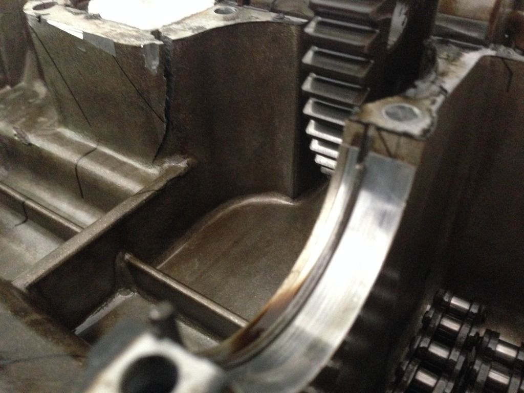

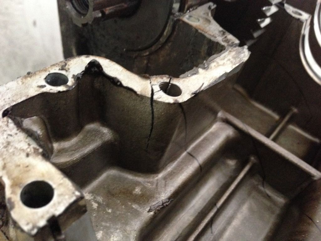

However, my joy at finally splitting the case was tempered by a horrific discovery:
And the upper case in the same place:
Thorough eye check of the gears amazingly show no chipped tooth or disfigurement, 3rd and 4th gear seems to have gotten the brunt of the damage.
My guess is that at this point, the cases are shot and I'll have to find a replacement case not only because the space to weld those crack is nonexistent, but also the bolt holes are tore apart as well.
But I will defer to the expert opinions here.

Yes, those cases are toast.  Remember to get a matching set of cases.  Also not a bad idea to stick with the same bearing pattern stamped on your existing cases.

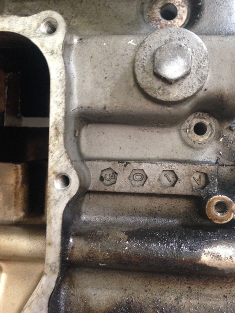

CRF, can you please elaborate on the bearing pattern #'s I'm looking for? Where would those numbers be?

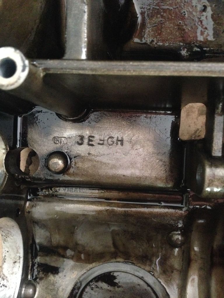

The size codes for the crankshaft main Journal bearing sizes are stamped into the  crankcase, on the bottom side of the mounting boss for the front engine hanger bolts.  It will be five separate letters, for instance ABBAA
You don't technically need to keep these identical to your Originals, so long as you replace the upper and lower crankcase halves as a set, and get all new bearings after cross-referencing the charts in the factory service manual.

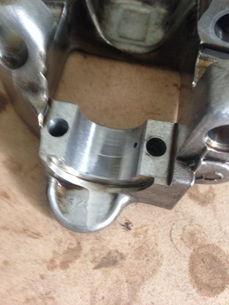

Would these be the numbers/letters I'm looking for? I didn't find anything else on the inside of the bottom case.
Also I removed everything except for this bearing inside the case. I guess I can easily rig some sort of bearing puller with a long bolt and a couple thick washers and nuts, or is that bearing easily replaced?

what on earth happened to that case? looks like a grenade went off in there.
Re: '73 CB750 redo for a clean "machine" look
« Reply #22 on: May 26, 2016, 12:29:51 PM »
Nope.  The bearing sequence is actually stamped on the outside rear of the lower case.

« Reply #24 on: May 26, 2016, 01:54:55 PM »
Nope, Look further back near the frame mounts.
