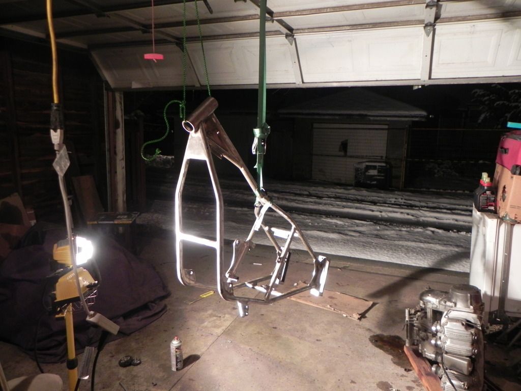

Cheeky update on the frame, spent another half hour sanding down the frame with 120 grit sandpaper, getting into the nooks and crannies. Then I set up my painting stand. I'll be honest, I spared no expense on this. Full plastic sheeting up and down the garage, a thousand dollar painting jack to winch the frame up, advanced ventilation machinery and air purifiers, full body suit and gas mask...
Tadaa  ;D
Okay so perhaps its wasn't the best set up, but I don't have a lot of money and this let me get in at most angles (and before you tell me off yes I plugged the headset before I started)
I'm going to put another coat on in a minute, but even the base-coat makes it look so much nicer!
Photo doesn't do it justice! 2 coats of primer then 4 coats of whatever paintI'm putting on top. Any advice on paints? I was planning on using Hammerite, but I know some of you guys have a grudge about hand painting the frame. I can get a compressor at a stretch, but if not that'd be great, Thoughts?

Rattle can paint is fine mate, I couldn't get my K1's frame powdercoated one year (they'd closed for Christmas) so I painted it with Epoxy Enamel (gloss black) and it set as hard as baked enamel, looked great, and cost $26 for 2 cans of paint. I'd be more worried about the cold though, most paints don't cure well in freezing conditions, can you do it in a heated room inside? Cheers, Terry. ;D

Yes I'd be a bit worried about spraying in the cold too. Even Hammerite  (no primer needed) cures better in warmer conditions. Have you got any threaded holes in that frame? If so mask them now (just a rolled-up tube of paper will do) before you fill them with paint.  :)

You could use a heat gun between coats to help the paint flash off.  Or perhaps setup an infrared heater on it between coats.  And leave a bit more time between coats as well.  I'd go ahead with it.  It's just Vancouver, not really the great white north.   :P

Hmmnn, I wouldn't, I'd take it indoors and do it in nice warm dry air. Unlike using a compressor and a spray gun, rattle can's (especially when using a heavier paint, like an epoxy enamel) don't produce a lot of overspray that will travel some distance and coat everything in it's path, and it will cure so much better in a warm dry room.
Read the instructions on the paint can, they're put there by experts, for a very good reason. Cheers, Terry. ;D

True that, hard enough to get rattlecan to look like much, let alone, bend the recommendations and invite failure.... Get primer on though to ward off the rust..

I've sanded the frame to bare metal and put on 2 coats of primer 754, any rust thats on it has earned its right to stay...  ;D
Joking aside I've decided I'm not going to half ass this, my plan is next payday to get some fairly thick sheet plastic and duct-tape up a booth in the middle of the garage. Then I've got a friends space heater I can put in there to keep it relatively toasty. Suffice the booth is air tight (Yes I will wear a mask when I'm doing the painting) It should hold heat fairly well? Next payday is on the 11th, I'll keep you guys updated.
