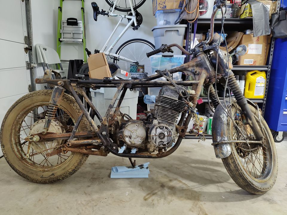

Alright lots of progress today. Feels like every fastener is a battle of PB Blaster and heat until I can get everything to break free. Biggest battle this time around was an already stripped screw that I barely got off with the impact before it was completely stripped and the kick starter. So far still only the one broken off fastener on the points cover. Can't believe it.
Here is where it stands today. I think I am offically ready to pull the engine:
Some questions I need a little help with. I am going to take the time to search around the site for answers too but just too exhausted right now after being in the garage in this heat.
1) Carb floats look to be in okay shape. Should I get replacements because these are originals and sat in a field somewhere for 40+ years? Not sure how that the material on the floating part holds up over time and sitting in fuel soaked carbs.
2) Oil tank looks rough. I am fairly certain I need a replacement. Any suggestions where to get a replacement? I am guessing if I want OEM its off to EBAY? I know a few places like Cognito sell aftermarket stuff if I go the custom route.
3) Wiring harness is a mess. Coroded and broken connectors. I see there are replacements but from discussions in this thread about buying parts from some of the usual websites its likely these are of poor quality? Should I reuse connectors that are still good, buy replacement connectors where I need to and make my own?
4) Do I need to pull this bearing to get this stud (for lack of knowing exactly what it is at this moment)? I figured I wanted to remove the long stud in case while pulling the engine if catches on something and bends? Red arrow below:
« Last Edit: August 13, 2023, 01:53:08 PM by BrockCB750 »

1-You can test the floats in a small bowl with gas to see what happens.  If you are buying a rebuild kit, go ahead and replace them.
2-How bad does it look? is it rusted through?  (Side note: go ahead and budget new oil hoses).
3-not sure
4-Put the points cover back on if you can to cover it up while taking engine out. (Tape it on if you have to)

That oil tank looks like it just needs some paint stripper and new paint. The hoses just unscrew at their nut-fittings, nothing fancy with those fittings except for a soft aluminum sealing washer inside those couplings to seat against the tank's outlets.
The hoses: see if they are still semi-flexible: most are OK. A very few have cracked inner liners, which can flap like a valve and block off the oil flow (on the inner one, closest to the engine when mounted) and cause troubles. The K4/5/6 versions often leak a bit (like a weep) at the crimp on the bottom of the tank, making the fabric covering wet and a very slow drip when oil is hot, tank on the bike. New hoses are pricey, but are good insurance. I'm still trying to make some, need to build some jigs and stuff for it, but been buried with bike engines this summer(!).
About that 'stud' on the crankshaft (under the points cover): don't remove it unless you can first get Honda's specially-made O-ring that goes onto the other end. Normally there is NO reason to remove it, but if you do, it will weep oil with a hot engine unless you replace that special ($5+) O-ring. Normally they are fine, just leave them in place and plan on possibly testing it fro straightness when the whole engine is back together: if it is bent a little it makes the spark timing jump back-and-forth about 5-8 degrees. This shaft should have runout of no more than 0.006", and 0.000" is possible (and desirable) to have.

Just like with everything else on this bike PB Blaster and torch got the lines off the tank. I will likely try to find new lines. Does anyone make good reproductions?
Thanks for the advice on the crankshaft stud. I am going to attemp to pull the engine this weekend which I am both extremely excited for and terrified. Once the engine is out I can actually start the restoration process but the engine is in great shape, fins intact, no other damage other than the fastener that broke off for the points cover.
I am going to use the process detailed in the book, have a wood stand to receive the engine and just take my time. I will have a second person helping me as well.
I do have a question that is probably obvious but I have never pulled an engine off a motorcycle... do I pull the engine while its on the center kickstand?

The small rubber looking spacers are not needed, they are said to reduce vibration noises, or some such issue as that.  I left mine out and I haven't heard any noises.
The parts may depend on what you find when you tear it down further and perform measurements.
You may need to go to an oversize piston/rings.
