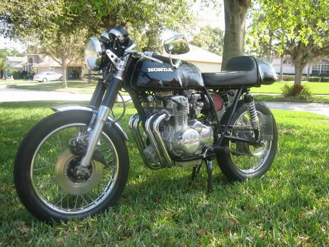

Re: front fender
« Reply #6 on: February 11, 2008, 07:50:56 PM »
OK UnCrash, now you've perked my interest.
Is this the fender of which you speak or has someone else gone through this mod, because if so, I too would like to see it!
Offline UnCrash
  • Pass
  • Posts: 1,705
    • My Blog
Re: front fender
« Reply #7 on: February 12, 2008, 05:19:28 AM »
 ;D
I see why I couldn't find the info on that front fender at dotheton.com.  It was you who posted it!  HA what a knucklehead I am sometimes.
This is the exact bike I was thinking about.  Is it yours or do you know more about it?
I love the looks of it and that built in fork brace is killer.

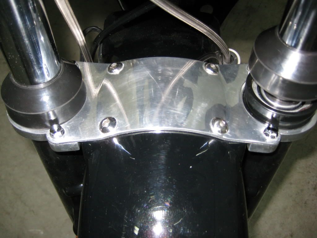

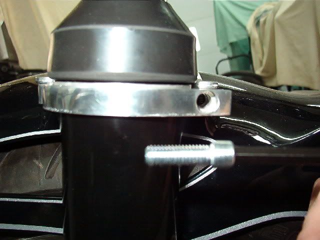

Re: front fender
« Reply #19 on: February 14, 2008, 05:28:27 PM »
I hate to mention it again but you do have the longer fork legs right? Early legs are a no-go.
Hym, buy the fender with the brace, it fits as snug as a bug in a rug!
Follows the contour of the dust boot perfectly. Here's a pic with one boot up and one in place.
I wouldn't make the claim that this is as sturdy as a Telefix leg clamp, but it does indeed tighten up the forks, much moreso than the stock fender for sure.
Re: front fender
« Reply #20 on: February 14, 2008, 05:34:05 PM »
Oh by the way, I ground the original rivots off that attach the fender to the brace/support to paint it. Those are stainless buttonhead screws that reattach.
The fender bolts to the clamps with 6mm bolts that use an 8mm head as the bolt is close to the boot.

By saying "early legs are a no go" ---how early ?? How do they interfere (is it fixable?)?
Re: front fender
« Reply #22 on: February 14, 2008, 07:42:35 PM »
The legs have to be long enough so that when the fender bolts to the clamps it clears the tire. I wanted to maintain a dust boot, so turned the leg "round" in a lathe just below the boot to pinch the clamps.
I'm sorry I can't tell you when Honda switched to longer fork legs, the forks on this bike are 404's from a 77 CB550K model. They are 13+9/16" from the top of the axle to the top of the leg. On my 750K3 the legs are 12+3/16", not long enough.
I'm using an 18" rim which gives me lots of clearance, but tried a 19" wheel for hymodyne and it just cleared but probably should be spaced. For me the fender looks a tad small on 19" but it should work.
I wish I knew how to post these pictures smaller.

Re: front fender
« Reply #23 on: February 14, 2008, 09:09:42 PM »
I did like Steve and just cut mine off front and back.  Left the stock bracing......
The above bike looks phenomenal!!! I will second the option of just trimming your stock fender. It can be done very simply and looks great. Here is one I did.

Re: front fender
« Reply #25 on: February 23, 2008, 05:10:42 PM »
Ah I think there may be some misunderstanding about those clamps seaweb11. They are pieces I fabbed to mount the fender/brace not actual Honda parts.
 On the original Interceptor there were lugs actually cast into the fork legs that it bolted to.
I don't mind e-mailing you some half-assed blueprints on how I made these so you can duplicate them if you would like.
