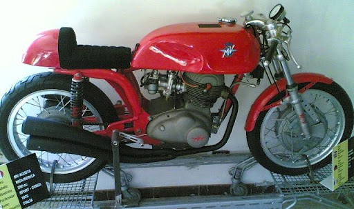

« Reply #33 on: February 23, 2009, 09:40:15 AM »
I rebuilt the carbs and the bike runs. Now I'll have fix the exhaust since the marving exhaust (modell unknown) from Ebay doesn't fit to the head, so I am going to use existing headers with it. A have also been thinking about painting the bike bike all red (like MV Agusta).
Inspiration:
Photo chop:
May be this thread should be moved under 'project shop' since this is a project :)
