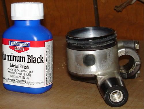

Next time I'm at the sporting goods store, I'm going to try to remember a bottle of this stuff:
"Aluminum BlackĀ® Metal Finish
Used by gunsmiths to blacken aluminum parts. Restores scratched and marred areas quickly. Fast-acting liquid is easy-to-apply with no dimensional change. Color will vary from deep gray to black depending on alloy. ALUMINUM BLACK is also excellent for blackening name plates, plaques, trophies and other engraved items.
...... couldn't hurt to try.

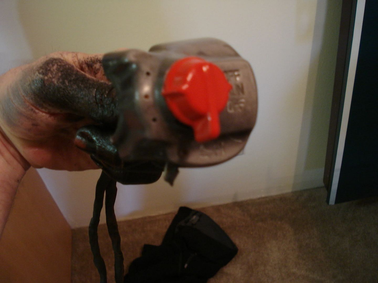

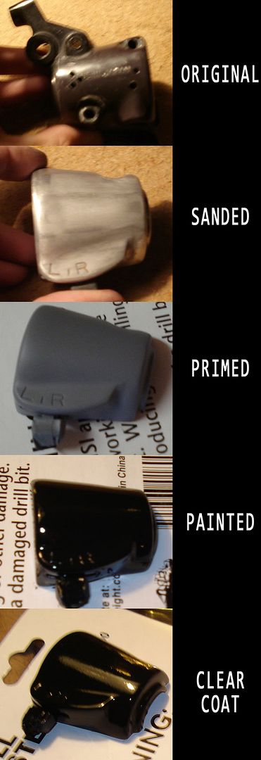

i'm, doing mine right now heres the progress
sorry the pics arent great little camera suck upclose
There is nothing to fear but fear itself . . . and trying to restore a cb350f

Nippon, what paint did you use to paint the red kill switch toggle. I have mine apart and have bead blasted the housing reading for primer.
The kill switch button is faded, I was looking for a new one but impossible to find. Your restoration is fantastic, greta work.
Mike
here you go mike i didnt feel like searching for balls and springs so i just did a really good tape job
love this paint no sanding required and when the clear coat is on top it is really smooth and strong
ps sorry about my disgusting hand

Apply magic smelly potion to bare aluminum...... aluminum turns black.
Further testing required.
F you mark...... F you.
Offline jamesv220820
  • Posts: 514
hmm interesting  how strong is that stuff , can you take your fingernail to it and it won't scratch off? because i didnt like how mine turned out it kinda looked plasticky and not like metal

Offline mark
  • Posts: 2,940
...... well..... I took to it with a bit of steel wool(yeah I know) and a little came off.
Surface prep consisted of sanding a little patch and blowing off the dust... Then dabbing a spot, watching it fizz for a minute, then rinse with water and wipe dry.
Thorough prep would have involved more degreasing and washing steps, and I just wanted to see the stuff do something.
I think I'll try a larger area of a smaller part..... maybe the mounting clamp.
I'd kind of like to know what the factory finish really was.....
There's still some black inside - I don't think paint would last 30+ years in brake fluid.
Castings aren't usually anodized as irregularities in the alloy produce irregularities in the finish.... looks funny.
Black that fades to clear and doesn't peel..... weird stuff.
hmmm....
