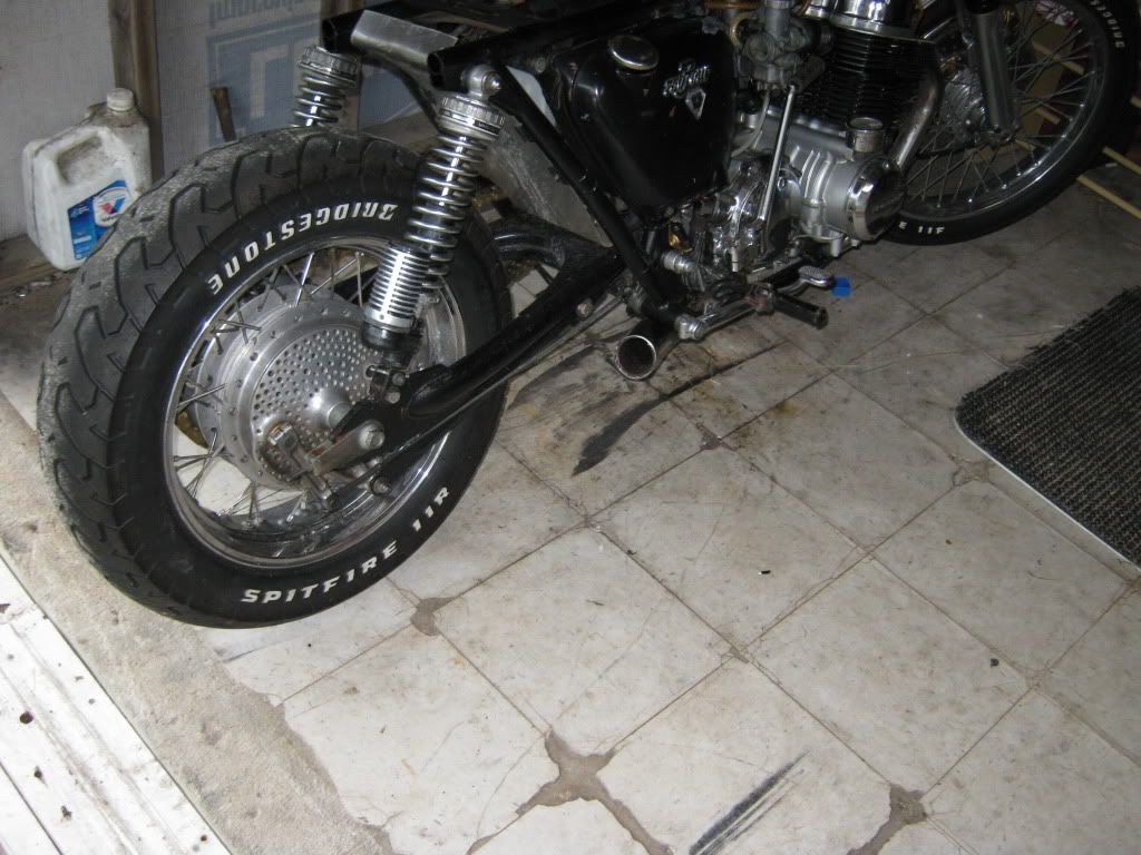

I guess I should say what was done.
 I cut off everything that was unnecessary
my seat only weighs 1.5 lbs
aluminum akront wheels
everything that could be drilled has had the piss drilled out of it
air box gone
pass pegs gone
frame ends gone
... I don't know what else.
 it's funny how much weight you can lose off a part when you drill holes in it.
 they all feel like I'm holding a feather.
hey stig sam, why is yours so much lighter?

The bike in my avatar was weighed on a grain scale at an elevator, pretty accurate as its for commercial purposes at 430lbs.
no fenders, turn signals, stripped harness, aluminum rims, no switchgear, (QA50 buttons and flimsy toggle) fiberglass tank and seat, no sidecovers, no elect start, lightened rotor. but I did add the disc.

IC, Aluminum oil and gas tank, narrower rear rim, lightened crank, no lighting system, no generator and that gearbox cover that you drilled 87 holes in has been removed alltogether, also no kick start shaft and cranker.
All surplus brackets off the frame and top TTT.
I could have made it lighter but Chris wanted twin discs and fairing. ::) ::) ::)
