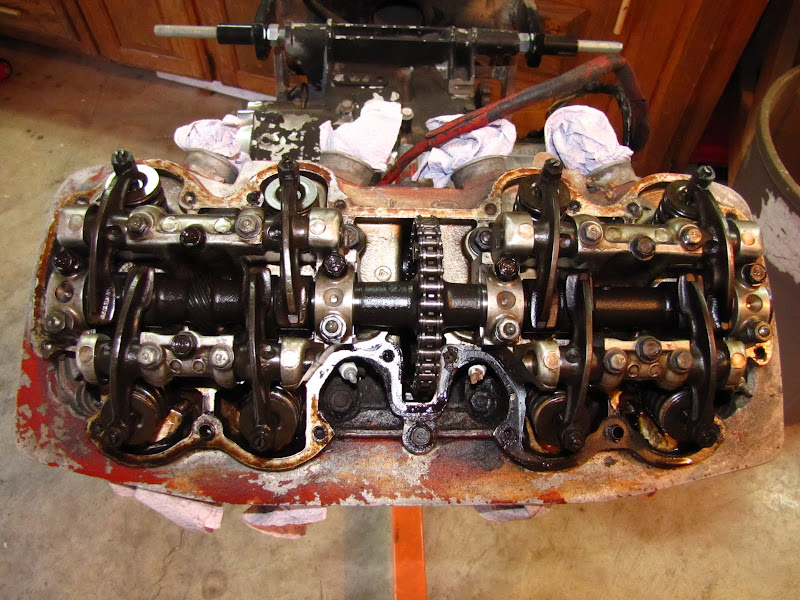

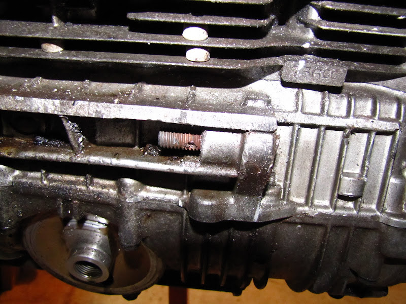

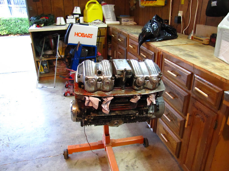

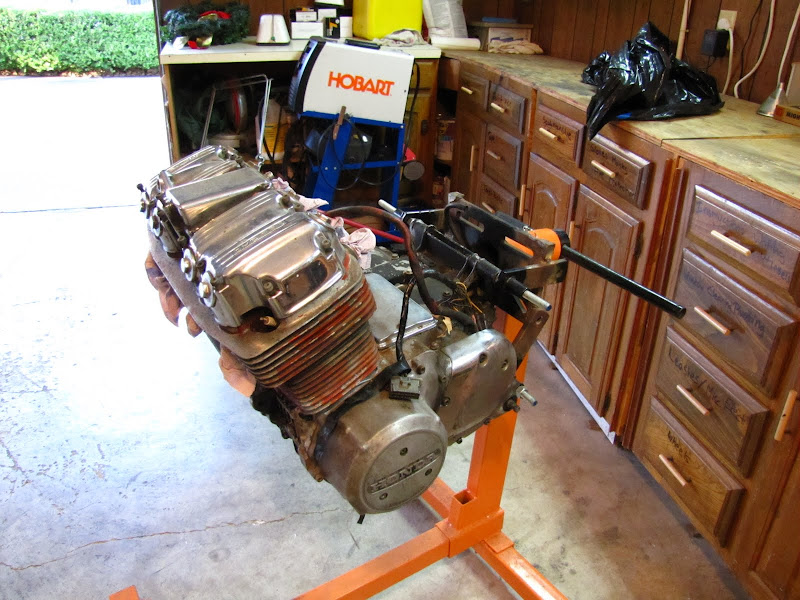

ok, so time for a REAL update...  about the only good thing that happened today was that i got some serious work done on the cb!  the rest of the day sucked, because i got laid off from work!!  i got 2 weeks severance, my vacation pay out and insurance coverage til the end of the year, but still a #$%*ty time...  so i digress.  i decided to start checking out my spare engine to see what i was working with and what i could use.  sorry for the length of a single post, but i'd really appreciate some insight from everyone!

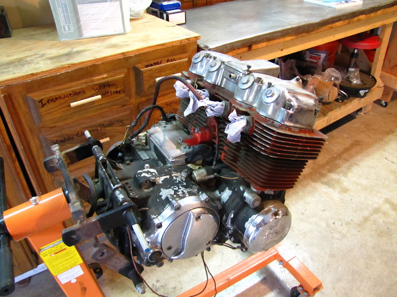

looks like i'm going to just have to gut it, since the cases are crap...  engine mounts are broke and someone didn't do a good job of a case repair in front of the sprocket....  here's pictures of it all!
engine on the stand awaiting tear down:

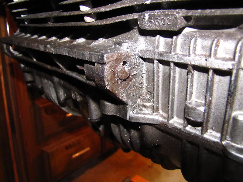

problem from the start, broken engine mount:
valvetrain awaiting teardown:

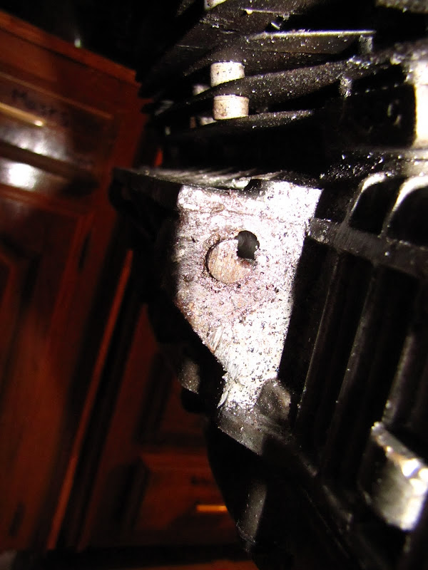

so how bad are broken helicoils??

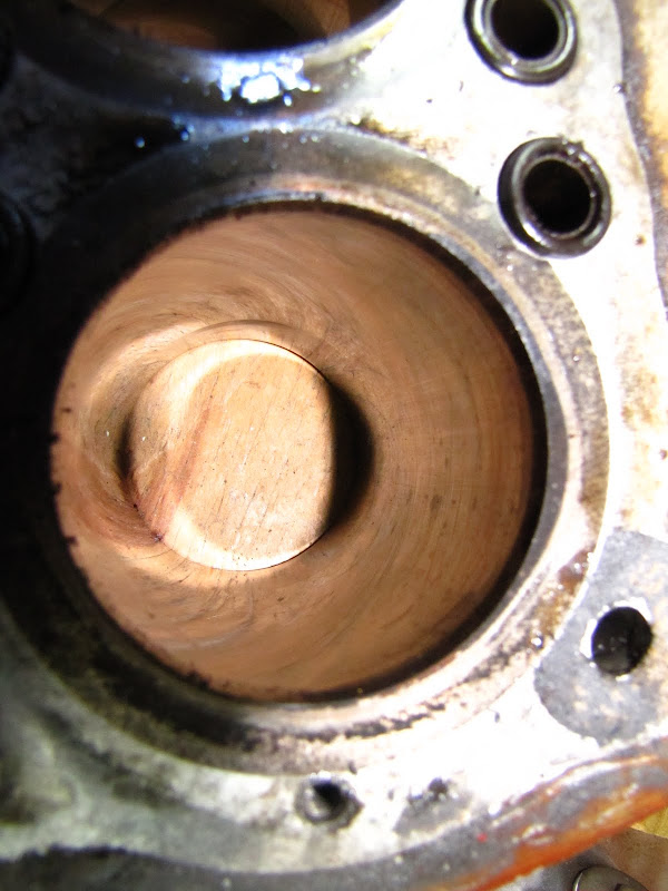

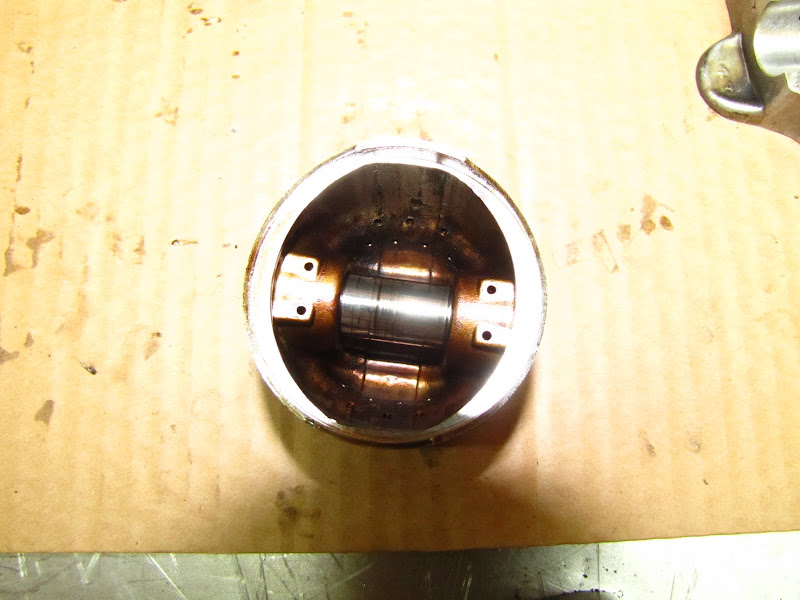

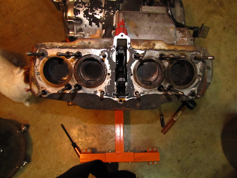

piston tops in cylinders:
all the pistons look like this on the inside.  if they measure up ok with the calipers and mic, do they look ok to use from this angle??

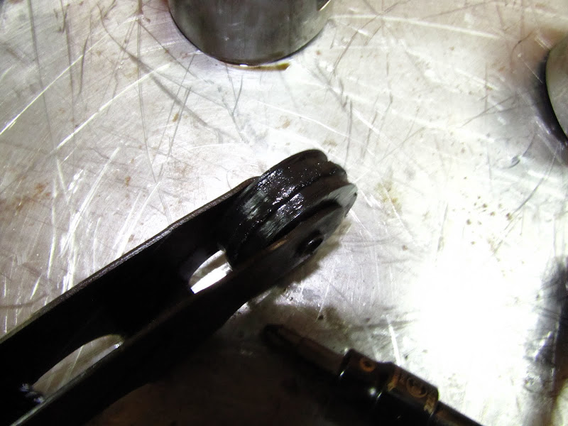

i'd say i need a new tensioner eh?? ;)

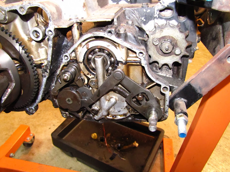

shifter mechanism, looks to be in good shape.  can i order new screws for the bearing retainer??
nobody forget this o-ring!  it isn't made anymore!  thanks Mark!!

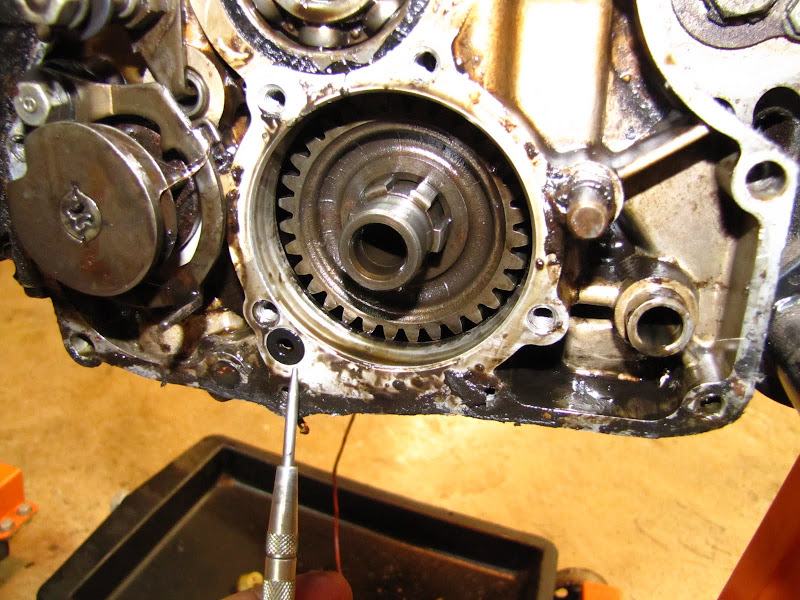

i didn't have the tool to "properly" remove this nut, so i tried using my punch, and i inflicted minimal damage, as you can see from the picture.  not to worry either way, Rob needs to get that dry clutch over to me!

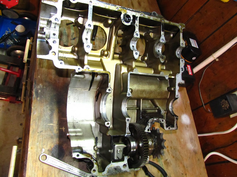

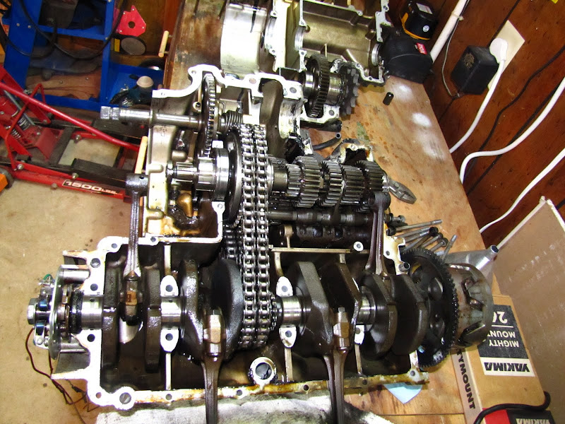

the cases are split, FINALLY!!

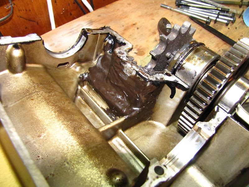

here's the NASTY case repairs someone else did before...

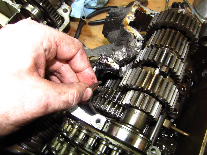

does anyone know where this half room came from?  could it be a broke half of a retaining ring for the shifter assembly??
does this look like too much play in the primary chains?  i don't remember what Honda calls out for...

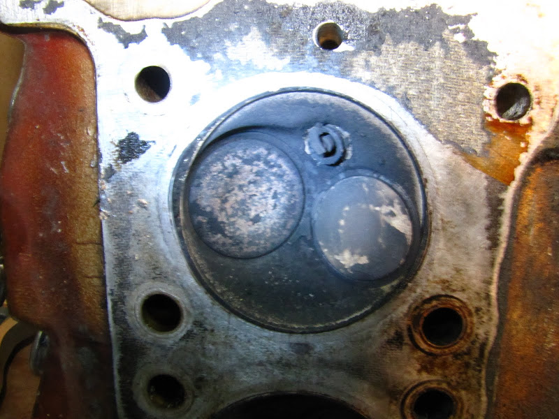

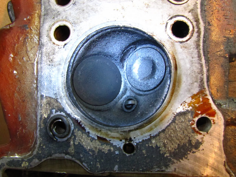

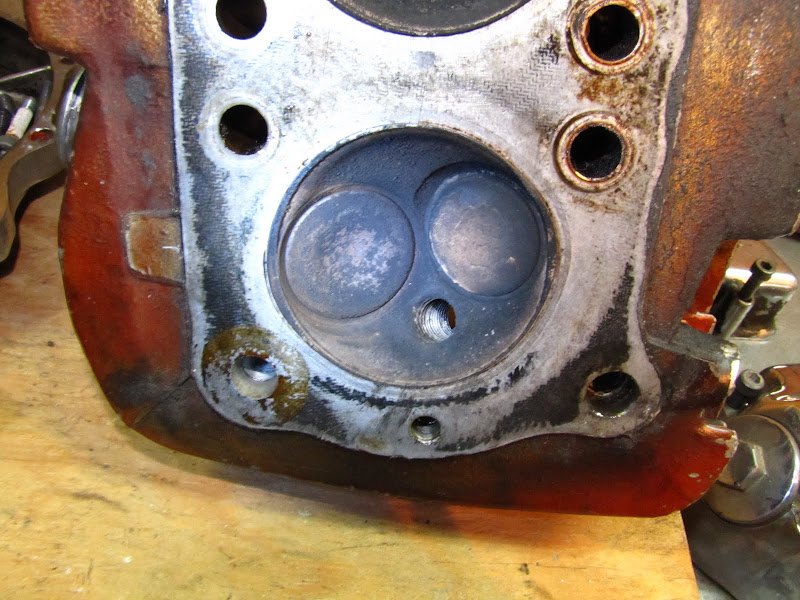

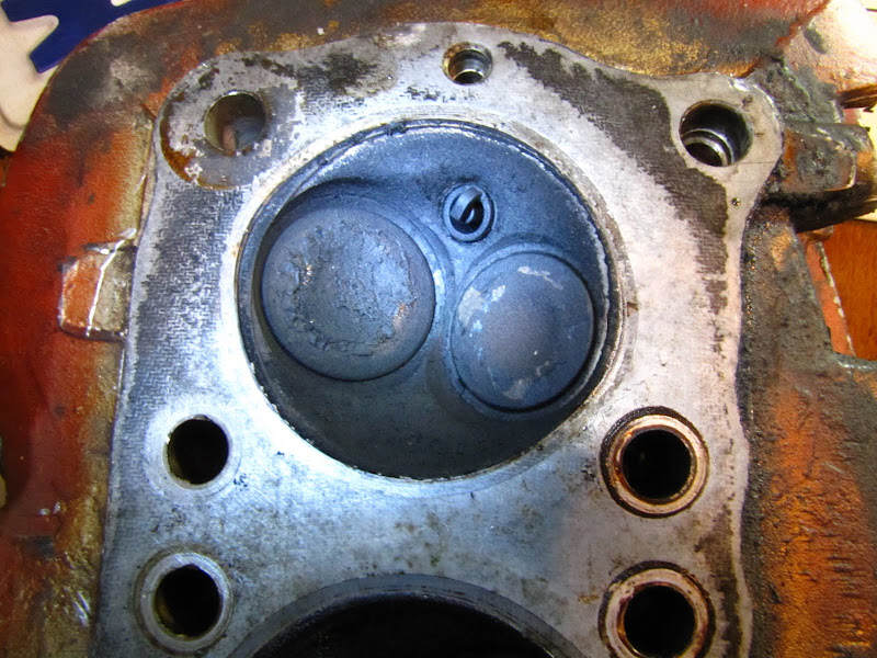

underside of the head.  how do thes valves look?  i was expecting more shrouding, like Mark said in his book.  i need to take a picture of the ports and everything up close to see where i should work on the porting since this will be the head used on the engine build...  up close of cylinder 1, 2, 3 then 4.

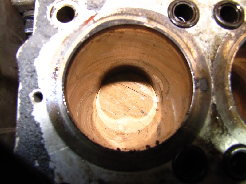

and pictures of the cylinder bores.  # 1, 2 and 3 are all super smooth, looks like they just need a good hone.  #4 has one ridge that i can just catch my fingernail on and another smoother one, but i think a hone will knock that down.  you can see them at about 12 and 1-130...  thoughts?  pictures are of cylinders 1, 2 3 then 4.
Offline voxonda
  • Posts: 2,229
Re: 1976 K Build - A lesson in patience... (FINALLY updated w/ pics 12/2/10)
« Reply #94 on: December 02, 2010, 11:24:34 PM »
"does anyone know where this half room came from?  could it be a broke half of a retaining ring for the shifter assembly??"
Hey G,
These are retainers for the bearings of the gearbox, they are not broken, look at the grooves in the outer bearingrings and in the cases. Throw these cases out, they are really crap. You should be able to find good ones if not I have a set of F1 cases which are very good.
Rob

I'm going to use the cases that are on the engine on the bike.  This motor was basically bought for the head and spare parts...
I'm going to try to disassemble the head today and start documenting all the clearances to see what's still useable.

can someone please give me a link or show me a diagram of how you measured your clearances in your valve guides?  my exhaust ones SEEM to be ok, but i think my intakes might be a bit loose...  i'm using a magnetic based dial indicator, but with the head disassembled, it's tough to get a good accurate reading!

ok, well i've kept on going, dunno if anyone here has any advice for measuring those valves...  i digress!

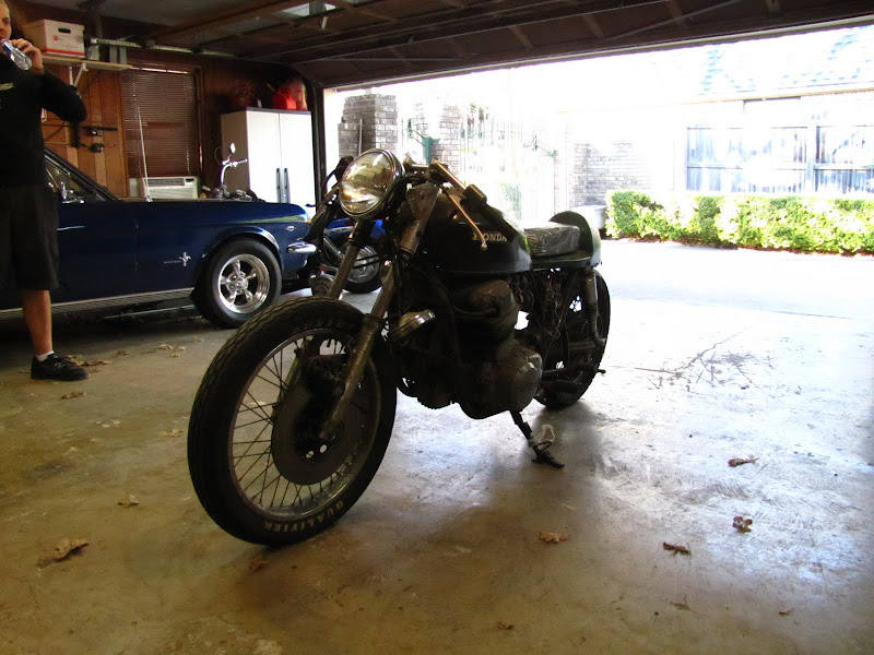

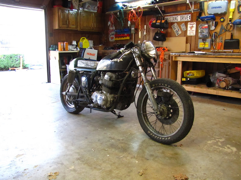

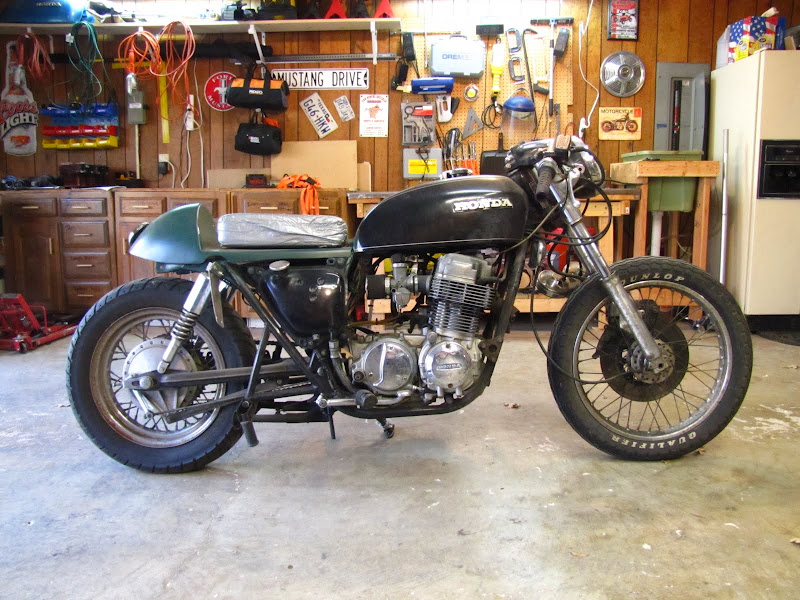

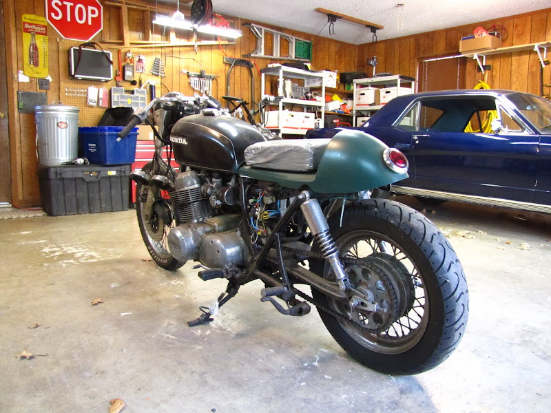

well here's the bike as it sat today, i pulled the motor out of this, and what a bear it was!!  got all the engine mounts undone just fine, except the front left one (clutch handle side) and it gave me SO much hell!!  bolt head broke off, so i tried to dill it out, nothing...  then i finally got the nut off on the engine side, wedged the motor away from the frame enough and cut the damn bolt in half with the sawzall...
bike as it sat today, i'm thinking about lowering the front maybe, instead of raising the rear??  thoughts?  either way, i think if it were lowered a tad up front it would look really good??
here's the broken bolt...  does the case still look ok, even though i "kissed" the inside some with the drill and removed a little bit of material?  it doesn't appear to be structural, so i think i'll be ok

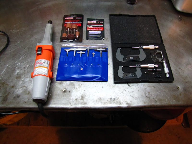

finally, i made a little trip with some 20% off coupons to harbor freight to get some measurement tools so i can measure the motor parts and an electric die grinder to do some porting.  it's big, but i think it'll do pretty good!  if not, air die grinders are only about $12, so i think this will do!  just thought i'd brag some, i'm really hoping everything works out well!  oh ya, and the paper towel holder is magnetic and i think REALLY slick!
more progress to ensue this week for sure!!  if anyone has any help for questions i posted earlier, i'd really appreciate it!

the case should be ok even with a few nicks. As far as I can see in the pics.
