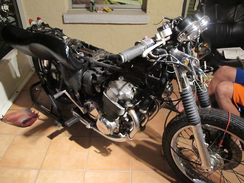

Well I am new to this site. But I have recently purchased a Honda cb project. It is a 1978 550 frame with a 1972 750 engine.
I dont know a whole bunch about restoring, repairing or building but I am looking very forward to learning. The bike doesnt run but does have compression. The previous owner didnt have the bike very long and didnt know much about it. I picked it up for $250. I am planning to chop/bobber it. I know that its going to be hard work and I am planning to take the build very slow as I am getting married in a year and need to keep my priorities straight ;) I want to thank you all in advance for all the questions I will be asking...

Welcome to the site. The frame is not from a 550, it looks to be a later CB750K. They are not interchangeable, unfortunately. If you have a title or vin tag on the neck that says the bike is a 550 you have a title or vin from another bike! It looks like a good project, looks like it has aftermarket Andrews coils to. Remember, we love pictures!  :)

Hey Shenanigans I checked the vin on the frame and it matches the title. CB550E 2109774. The vin on the frame is stamped or etched (not sure) But it is on the frame not a vin tag. What does this mean? Is there absolutely no way that these two are not interchangeable?

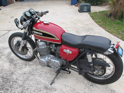

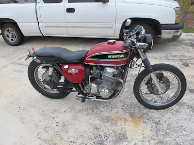

There is supposed to be both the etched numbers and on the opposing side of the neck a vin tag. That is NOT a 550 frame. It looks to me like your bike is missing the vin tag. I think someone ditched the vin tag, ground the number off and restamped it to match a 550 title they had. You should take a picture of the etched vin on the neck and post it up.
See 750K frame:
550K frame (with a few mods and also with the vin tag removed) but notice how the 750 has 3 bars coming back from the neck, where the tank rests. The 550 has a single pressed tube.:

and get that wall paper hung up properly ;D ;D ;D

1st photo at top of page ;)

oh that's in the back of the warehouse at work. It's a roll of vinyl for doing car wraps.
