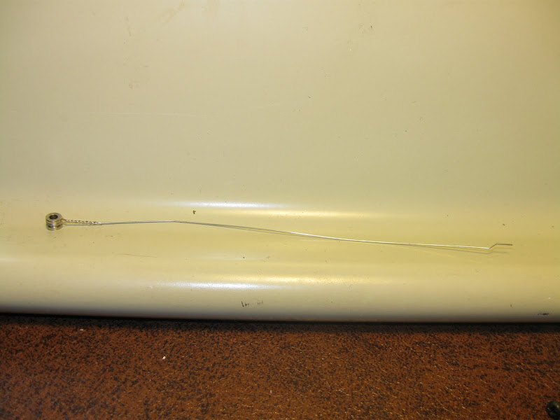

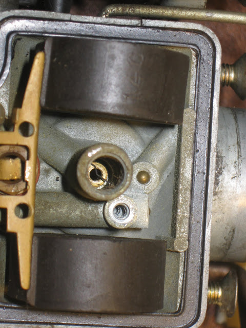

Here are some pics of some of the particulars...
disclaimer: Folks (who I greatly respect) here on the forum have warned against using a guitar string for cleaning your carbs because it's pretty hard steel and the carb materials are generally softer.  Exercise caution and use at your own risk.
Here's the tool of the day.  I think it's an "E" string.  Notice the jiggety jig bend on the end (more on that later):
Here's the entry point on a very dirty carb (parts carb for demonstration purposes only ;) ):
Here's where you can see it through the emulsifier tube hole.  Note that the needle is not in and I'd be cautious about scratching the needle with the end of the wire.  Your wire is hard.  The needle... not as hard - be careful if you do this with the needles in place.  This is hard to see even under good light conditions - it was a pain to photograph.  The "jiggety jig" at the end gives you the ability to rotate the wire to clean/scrape crap out of the hole - especially right at the opening at the base of the emulsifier tube (top of tube).

Wow, GammaFlat, great photos. I'm sure it did take some work to get the lighting right on those close-ups. This helps clear things up on the cleaning technique.  In the first photo, the other hole/opening is part of the pilot air passageway circuit, correct? It connects the air screw adjustment opening to the pilot jet. Since I think most of my rich condition is in the pilot circuit, I really want to make sure that passageway is unrestricted. Assume your same technique applies or any thoughts on that?
One reason I am willing to keep coming back to these passageways getting whistle clean is because the bike, in the year + I've had it has tended toward rich especially on plugs 1 & 4 with some evidence on plug 3. With all the carbs set up the same, it makes me think one unpredictable variable is air blockage. When I first had the carbs off for my first cleaning of them a month + ago I discovered someone in the past had installed 95 main jets in three carbs and a 90 in another. Stock is 105. So I wonder if this could be a clue that someone was trying to make an adjustment for rich condition in the past. Granted, not in pilot circuit but at least in the overlap between pilot and 1/4 throttle+ range.
No, it's the main.  [EDIT] on second perusal, I believe you're right.  The opening that does not have the brass fitting (larger opening) is the pilot.  The brass fitting is the main.
The path for the pilot is different and the air sort of makes a 90 degree turn.. after it enters through the hole on the intake side of the carbs, the air goes down-ish then turns toward the front of the carb (intercepted/interrupted by the air screw) to meet the base of the idle jet (different on K7/K8 carbs).  I'd make sure both passageways are clear.  They are more likely to get the crusty formations as you get closer to fuel -that's why the opening at the base of the emulsifier tube is usually suspect - and less suspect as you get closer to the intake side of the carb in these ports.  When I was doing mine, I was told that the emulsifier vent (one that goes to the base of the main) would cause fouling if blocked or partially blocked.  I think I had issues there.
