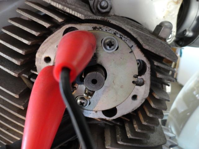

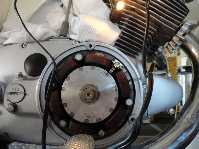

First thing I had to do was to solder up a test light. I have a bunch of instrument bulb wire harness and some old bulbs. Perfect.
Remove the alternator cover and points cover. Set points @ .014. I marked the points plate at it's current position. Rotate the crank to the "F" mark. This is where the light (points open) should come on.
You can see the bulb is lit. Timing mark @ "F" mark.
The light actually lit way before the "F" mark. To far advanced.
Rotate the points plate clock wise (retard) and get the light to come on right at the "F" mark. Rotate again.
As you can see in this picture just how much I had to move the plate.
Bike now idles better, revs better and sounds way better. Thought the old girl just didn't run right. I have yet to test ride as I want to swap out the right exhaust header.

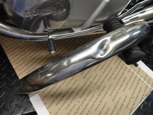

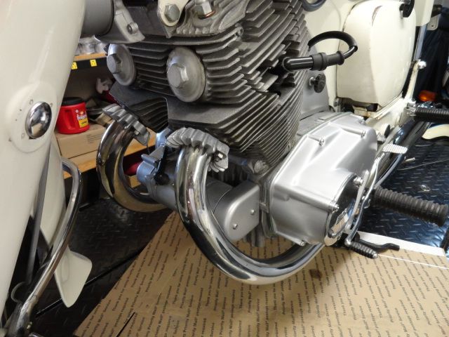

Nice cool spell in the mornings. Yesterday I took a break and rode the CBX. Boy, that was a well needed ride. Feel better.
Since the shop is cool why not finish up the exhaust. Found a nice right pipe on flea bay.
Replaced this one.
Left side was good.
Exhaust system finished.  8)

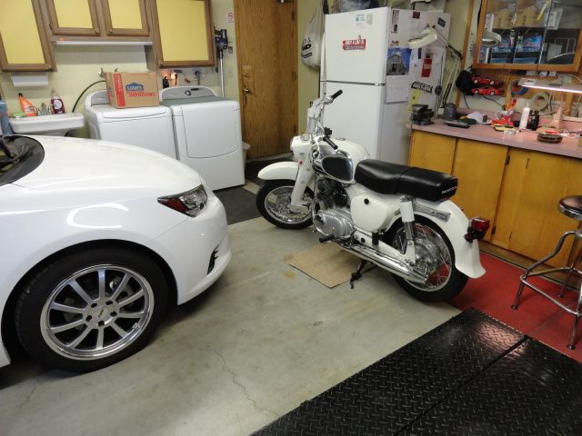

Well, well. Bike is running super! State inspection to get the title issue resolved tomorrow. Was titled by engine number and not the frame number. Will make it easier to sell.
Sell! Did I just say sell?  :o Nope, this bike is just plain fun. Rode around the block a few times and constant "thumbs up" from people. In fact some changes are coming so stay tuned. Yeah, going to throw some more money at it.   :P
Found the correct handle bar and.... ::)
RAF, you are correct. Takes some getting use to on the front end suspension. Cushy ride for sure. Just a putt around motorcycle.
It kind of hides huh? Maybe I need a orange cone? Notice how I made room for another project?  ;D
Wonderful motorcycle.
tt
